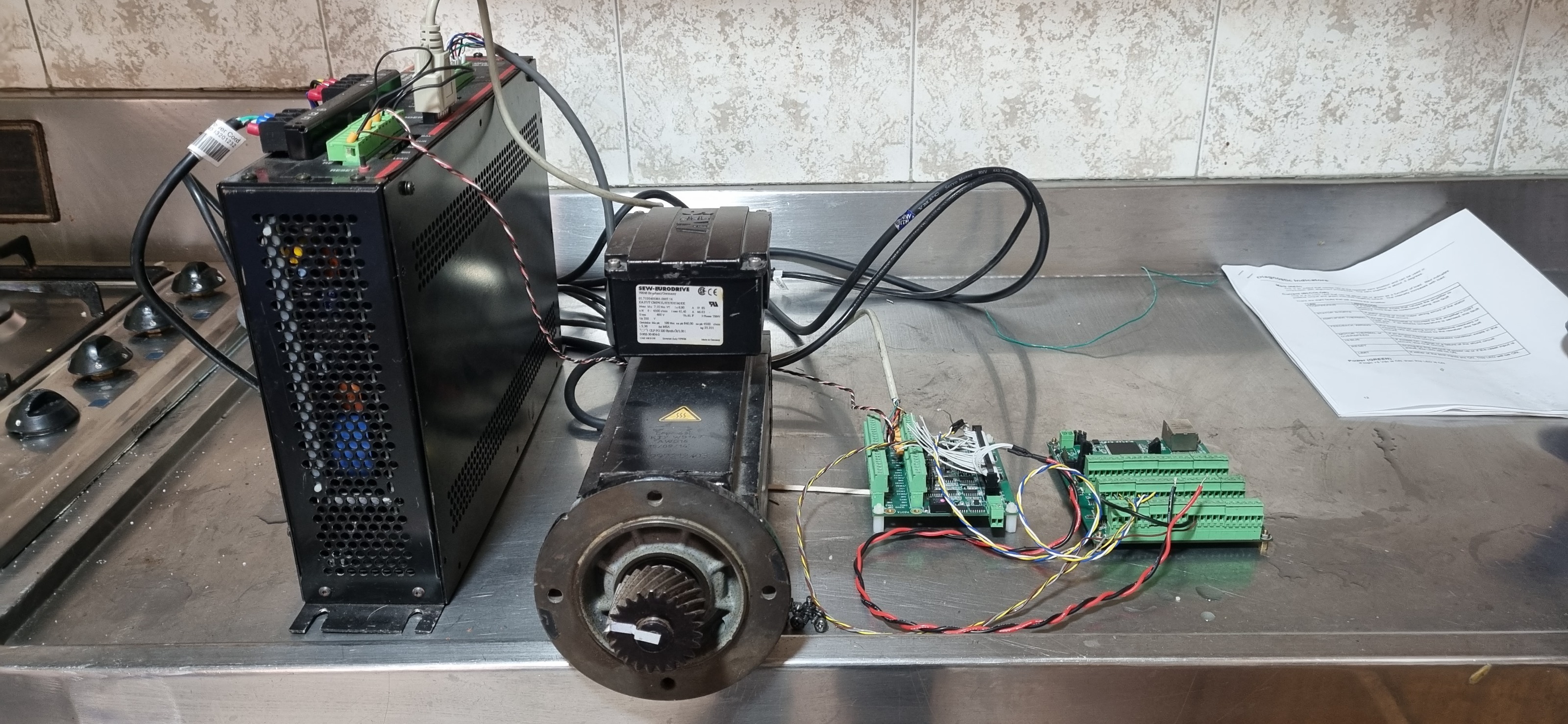

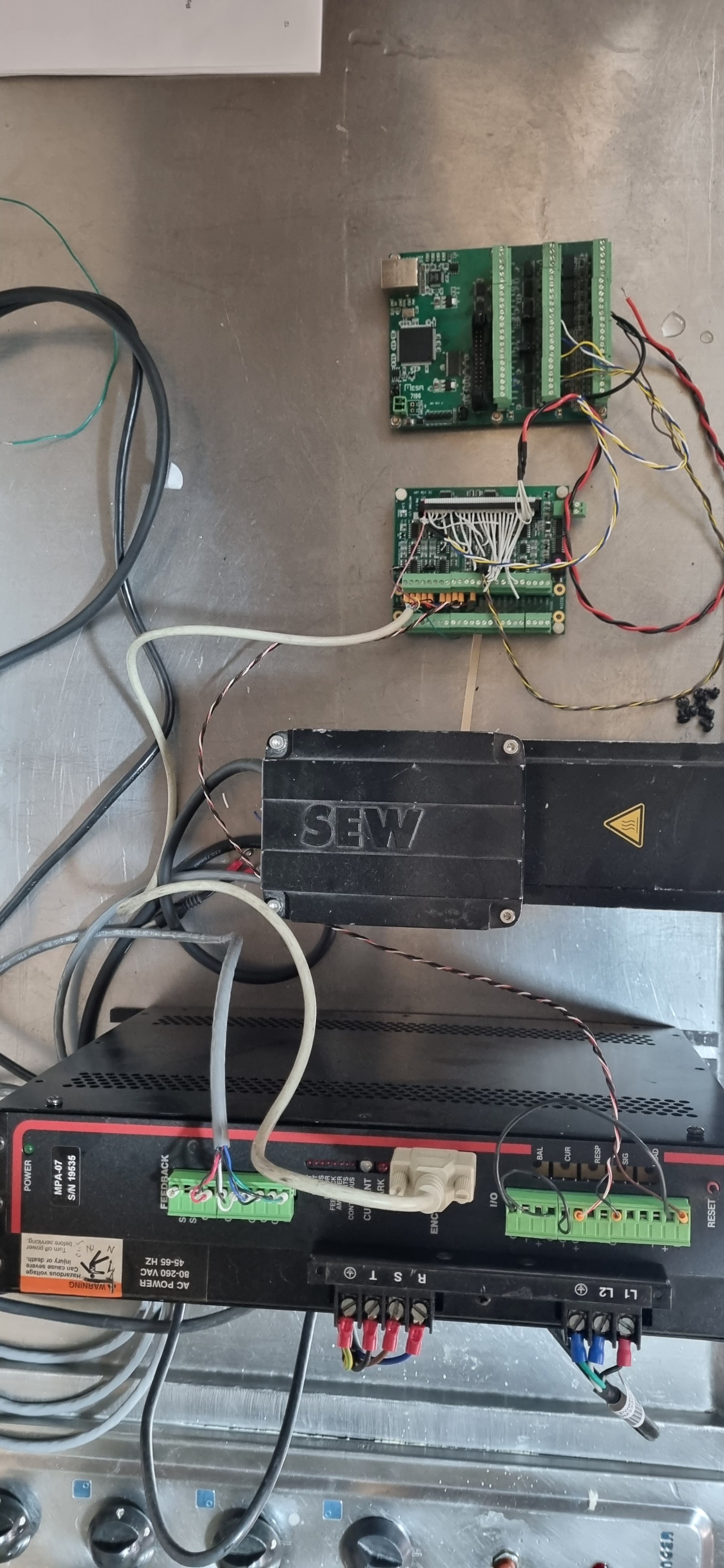

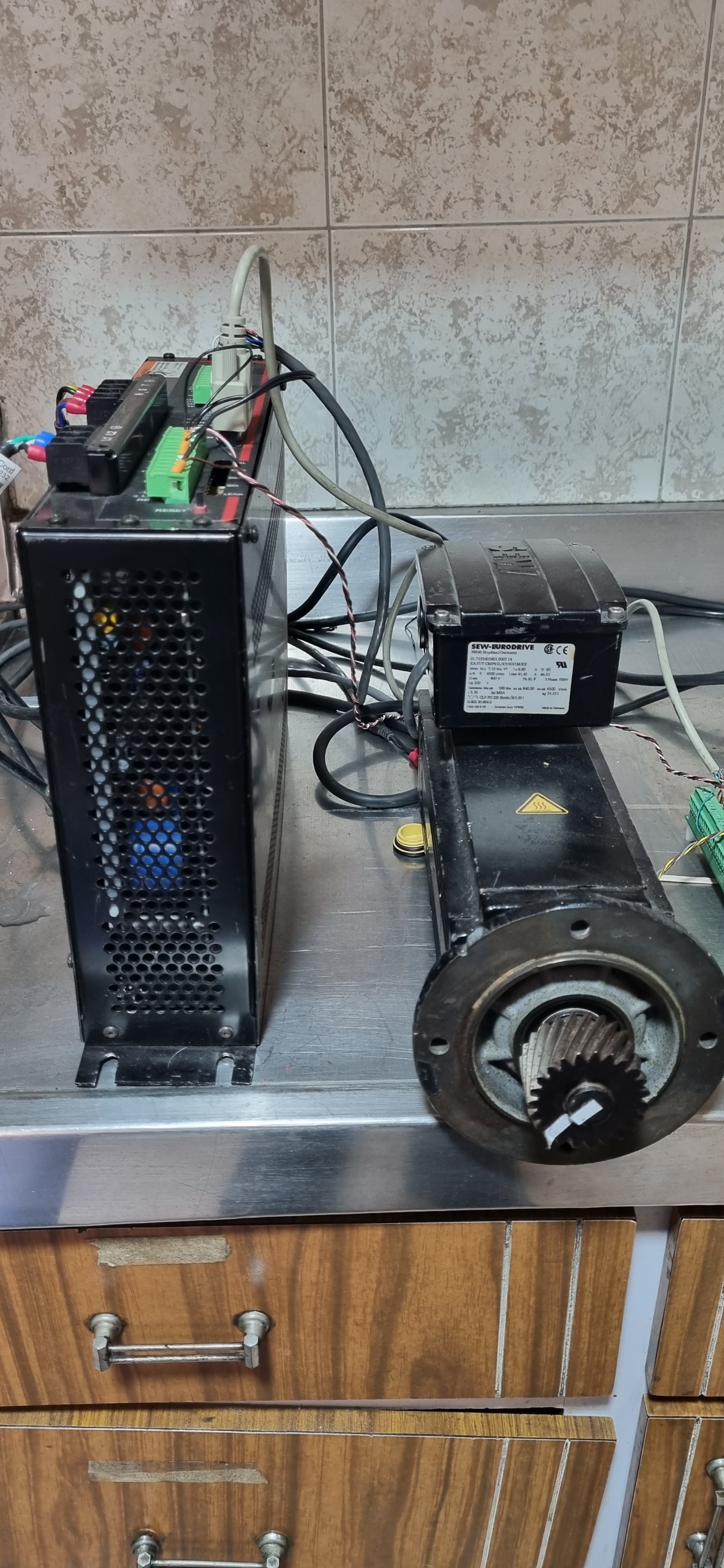

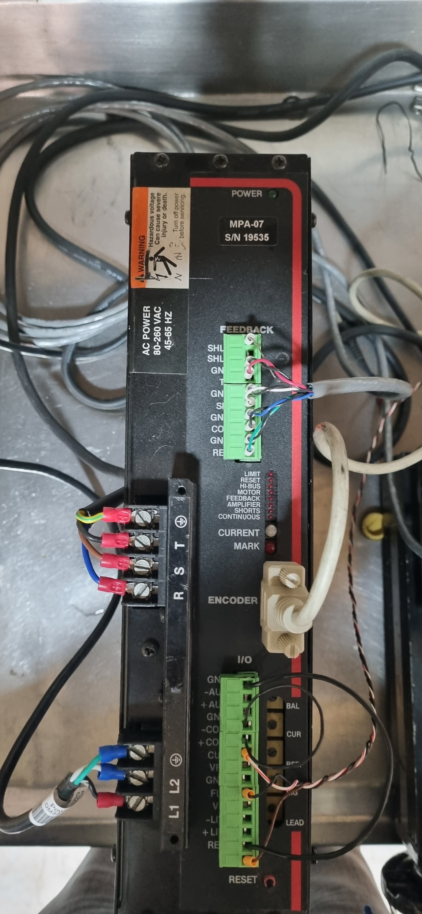

those are the same "generation" of mpa drives im using , im almost ready for a mesa board so i might look into other combos i can use to run the 3 analog drivesrather than wait for the 7i97, i would like an ethernet board. glad to see someone else had success with a similar setup.

With this card you can also test those MPA drivers, the difference is that it receives pulses from STEP, Dir and converts them into +- 10 volts. github.com/simonjoh/YAPSCO-10V
