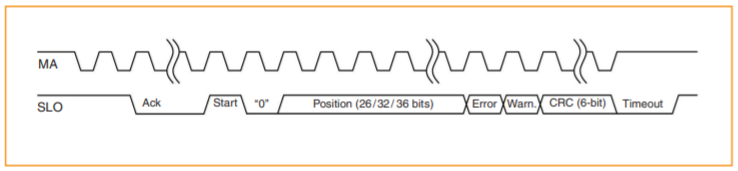

The timer-us pin is now available and I have been trying to make the HAL file exactly like another topic on the forum , but I keep getting: couldn't read from hm2_5i25.0.biss.00 You  may need to change the timing of the hm2dpll timer. This warning  will not repeat.
In the HAL configuration, pins>BISS>0> there is a hm2_5i25.0.biss.00.read_invalid(pin name from memory, might have slightly different name) pin set to true. The pin is not writable.
The encoder is of the same make and has exactly same bit length and type as mentioned in the 6i25-7i85 BISS topic on the forum mentioned above:
www.forum.linuxcnc.org/media/kunena/atta..._20220113_091133.png
I tried changing the following with wide values:
hm2_5i25.0.dpll.01.timer-us -100
hm2_5i25.0.biss.00.timer-number 1
hm2_5i25.0.biss.00.frequency-khz 2000
And hm2_pci config="biss_chan_0=null%1bcrc%6fwarning%1berror%1bencoder%26e" seem to show the said pins in Hal configuration but nothing flips, nor position updates or no changes in the pins if I move the encoder.
I flipped the (clock) MA+ MA- and (data) SLO+ SLO- wiring on the board among the positive and negative pins and I got no result.
I don't know what else can be done. I have anyways ordered 7i85 and 7i74 boards which will reach me in another week. If there is anything else I could try to get the encoder working on 7i77, I'm all ears.

08 Dec 2023 22:25 - 08 Dec 2023 23:46 #287592 by PCW
Just verified that the firmware I posted works on a 5I25 + 7I77 + BISS encoder.
One thing I noticed is that I had to increase the DPLL pre-read time from -100 to -200 usec
This is because in addition to the BISS data transmission time (biss-clockperiod*number of bits),
you have to add the encoders inherent readback delay to the pre-read time. Otherwise
you get the "invalid data" error. The "invalid data" error means that the BISS serial data was still
being sent when read  by LinuxCNC, indicating that you need to start the read earlier.
For the connections, I found this note in my test ini file:
CONFIG="num_encoders=1 num_stepgens=4 biss_chan_0="position%30e" "
# AM3021-1C41-000 Motor with BISS encoder 19 bits/turn 11 bits turn count
# Mesa Serial port polarities are reversed relative to BISS signal names so
# BISS CLK+ = Mesa TX- BISS Data+ = Mesa RX- etc
Last edit: 08 Dec 2023 23:46 by PCW. Reason: clarify

21 Dec 2023 19:52 #288784 by PCW
If BISS is enabled, the TX lines must have a voltage difference between
TX+ and TX- pins.  If this is not the case, there is a hardware issue.
The BISS format string tokens are the same as the SSI format string tokens
which are documented on the hostmot2 manual page.
On a previous post, you said
I kept the servo thread at 100000 ns.
 Did you mean 1000000 ns (1 ms)?  because 100000 ns (100 usec) is likely way too fast for the
BISS encoder to respond, especially at a low (400 KHz?) clock rate
