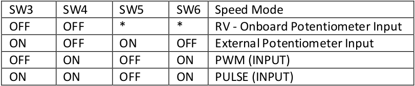

Not sure what you mean about the PWM, the 7I77 has only analog outputs.

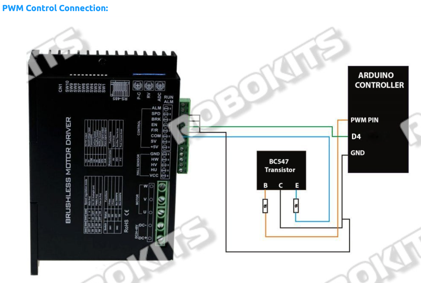

This is what is mentioned on my drive. Made me think that Pulse input is meant step/dir digital signals and PWM meant analog!!
I don't know what difference the modes are on the drive. The dip switches modes that are in the first picture are printed on the drives too. Are the modes mentioned different or the same?
@Tommylight said it is analog and so I thought that. Anyways, Help me with this.6i25 p3 to 7i76, p2 to 7i74, sserial link between 7i76 and 7i74. Which port on 7i74 is sserial (default is port 8 I guess). 3 axes, one spindle and spindle encoder to 7i76, 3 linear scales on the axes to 7i74 making it closed loop. Would this work?
