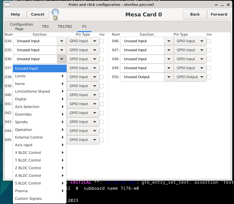

14 Dec 2023 18:17 #288145
by hpeyerl
Replied by hpeyerl on topic Will a Mesa 7i96s work in my case?
> the configuration would be a bit odd because the stepgens
on the 7I96S's expansion connector start at stepgens 5.
If I understand you correctly, I can connect a 26pin ribbon cable from P1 to the IDC connector on my custom controller (photo above) and then configure P1 pin functions to add extra stepgens for my X/Y/Z/A instead of using the ones on TB1/TB2.
I received my 7i96s yesterday and just powered it up. I was able to do --readhmid and the angels did sing.
So I found some 26pin idc connectors and fabbed a 1:1 ribbon cable. Now I'm in pncconf and find myself confused because I want to set 036 (pin 2) to a Stepgen but I don't really see a way to do that. The 'function' drop-down doesn't seem to have any applicable options that will let me set the pin type to an output (as opposed to an input). It feels like I'm in the wrong place or I misunderstand what you said.
I'll keep reading.
I'll keep reading.

14 Dec 2023 18:54 #288148
Replied by PCW on topic Will a Mesa 7i96s work in my case?
Here is firmware that puts stepgens 0..4 onto the P1 expansion connector
With this firmware installed you should be able to use pncconf for standard
7i96s_d firmware and have the stepgens 0..4 end up connected properly
to P1 (verify with the included pinout file)
Any GPIO inputs and outputs on P1 would still be setup normally

14 Dec 2023 19:25 - 14 Dec 2023 19:31 #288149
by hpeyerl
Awesome. Ok so now readhmid is telling me there are StepGen's on P1
[/code][/code][/code]
Not sure what I should be seeing in pncconf:
[code][code][code]IO Connections for P1 -> 7I96_2
Pin# I/O Pri. func Sec. func Chan Sec. Pin func Sec. Pin Dir
P1-01/DB25-01 34 IOPort PWM 1 PWM (Out)
P1-02/DB25-14 35 IOPort None
P1-03/DB25-02 36 IOPort StepGen 0 Step/Table1 (Out)
P1-04/DB25-15 37 IOPort None
P1-05/DB25-03 38 IOPort StepGen 0 Dir/Table2 (Out)
P1-06/DB25-16 39 IOPort StepGen 4 Step/Table1 (Out)
P1-07/DB25-04 40 IOPort StepGen 1 Step/Table1 (Out)
P1-08/DB25-17 41 IOPort StepGen 4 Dir/Table2 (Out)
P1-09/DB25-05 42 IOPort StepGen 1 Dir/Table2 (Out)
P1-11/DB25-06 43 IOPort StepGen 2 Step/Table1 (Out)
P1-13/DB25-07 44 IOPort StepGen 2 Dir/Table2 (Out)
P1-15/DB25-08 45 IOPort StepGen 3 Step/Table1 (Out)
P1-17/DB25-09 46 IOPort StepGen 3 Dir/Table2 (Out)
P1-19/DB25-10 47 IOPort None
P1-21/DB25-11 48 IOPort QCount 1 Quad-A (In)
P1-23/DB25-12 49 IOPort QCount 1 Quad-B (In)
P1-25/DB25-13 50 IOPort QCount 1 Quad-IDX (In)Not sure what I should be seeing in pncconf:
Last edit: 14 Dec 2023 19:31 by hpeyerl.

14 Dec 2023 19:57 #288153
Pncconf doesnt know about that firmware configuration so just setup
stepgens 0..N as X,Y,Z etc (the firmware routes these to the correct pins)
7I96S I/O will work as normal
The GPIO on P1 can be set up to match what misc ins/outs are present
on the breakout board

14 Dec 2023 21:10 #288165
by hpeyerl
oh ok. cool! You'll be surprised to hear it didn't "just work". I tried to 'tune' each axis and saw no movement.
Anyway, will start to dig now. I'm in new (for me) territory.

14 Dec 2023 21:40 #288171
Note that a very common cause for no movement is too short step pulses
(Don't use the manufacturers minimum values)

14 Dec 2023 22:13 - 14 Dec 2023 22:14 #288174
by hpeyerl
When I'm tuning on X and put my scope on P1:3, I see -3v with periodic pulses up to 0v seemingly corresponding to the tuning cycles with a 1s pause between cycles. P1:5 seems to alternate between -3v and 0v.
However, nothing seems to be happening on the STEP pin of the Gecko 201.
Also, strangeness. When I click on Tune, my linuxcnc machine stops pinging. It restarts again when the test stops. This suggests that the IP stack is being pre-empted maybe?
I tried setting the driver type to 'Sherline' (because the pulse lengths are far longer) but still no movement. The pulses are 10us.
