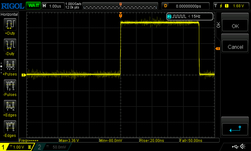

15 Dec 2023 00:46 - 15 Dec 2023 00:47 #288180 by PCW
Replied by PCW on topic Will a Mesa 7i96s work in my case?
Here's what I get on P2 pin 3, DB25 pin 2 (step 0)
with a 5 usec (5000 ns) step time selected:
Last edit: 15 Dec 2023 00:47 by PCW.

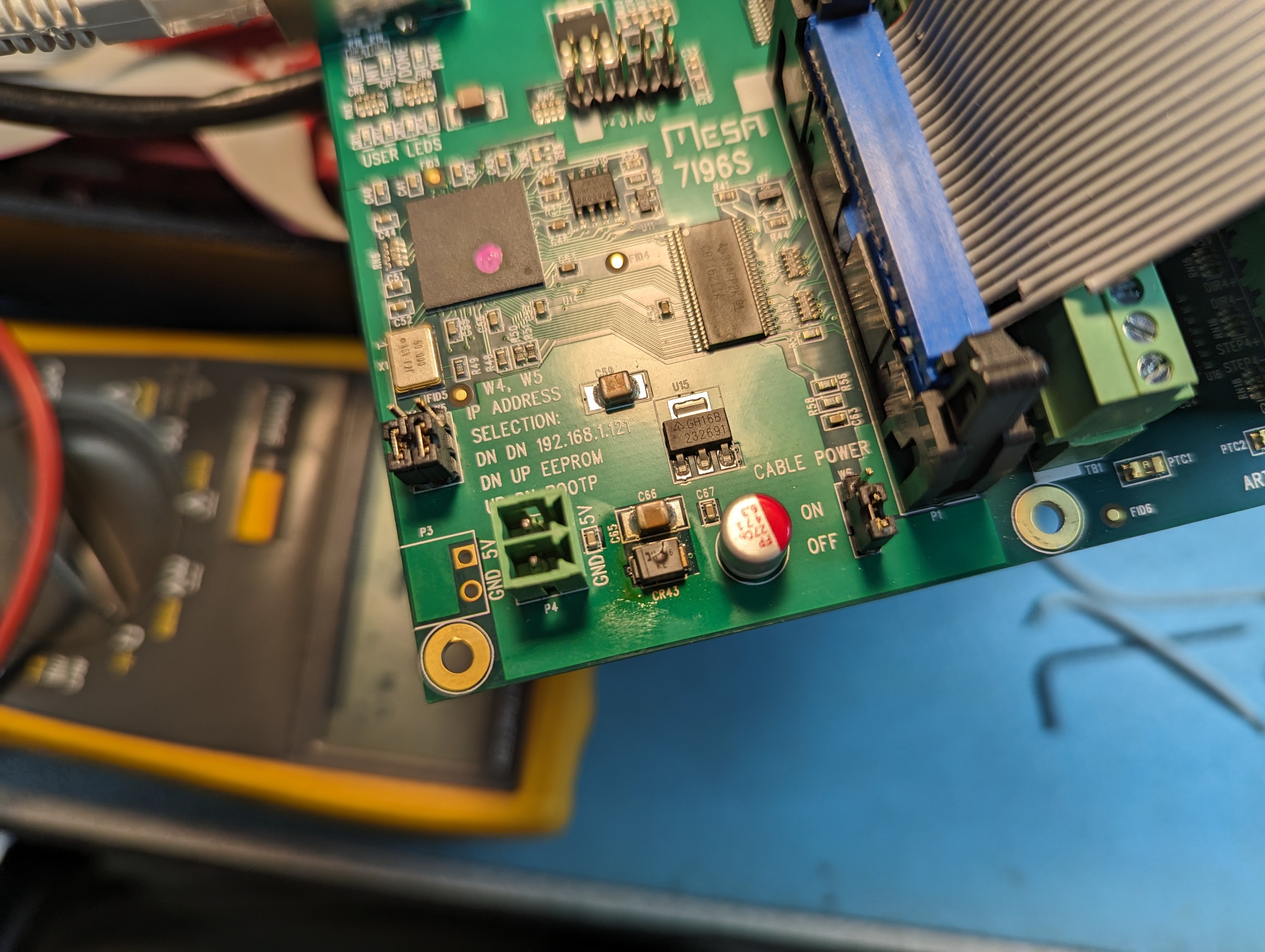

26 Dec 2023 22:36 #289120 by hpeyerl
Replied by hpeyerl on topic Will a Mesa 7i96s work in my case?
Spent the holidays nursing a surprise Covid infection and getting all my limit switches hooked up/working, my tool probe, tuning and did some fine air milling. Decided I could button everything up now. Drilled some nice holes in my enclosure, found some nice 4-40 hardware, did some zip-tying, nibbled a hole for my RJ-45.
Final step was to power the board from inside the old controller chassis instead of my bench supply. I wasn't really thinking clearly (See: Covid) when I found the 30V supply to my Geckos and wired it to the 5V connector on the 7i96s.
So, what do you think the chances are that I blew only CR43 and nothing further down the line? Doesn't look like any toasted traces. C66 is probably implicated as well.
I can do the rework if I know what the part is.
I am my own worst enemy sometimes.
26 Dec 2023 22:57 #289122 by PCW
The part (CR43)  is a SMBJ5V0 TVS diode.
Typically this would be the only failed component, unless
you plugged the 30V in hot so the current spike was huge.
