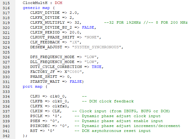

Is there a recipe to get the 100 & 200mhz clocks with the OP’s 12mhz crystal ?
The following user(s) said Thank You: Mehta_123
16 Dec 2023 14:20 #288331 by PCW
Replied by PCW on topic Hardware specification of mesa 7c81
You could certainly get 96 and 192 MHz with:
ClockMult1 : DCM -- This takes 12 Mhz clkin and multiplies to 96 MHz ClockMed
generic map (
CLKDV_DIVIDE => 2.0,
CLKFX_DIVIDE => 2,
CLKFX_MULTIPLY => 16, -- 16 FOR 96 Mhz
CLKIN_DIVIDE_BY_2 => FALSE,
CLKIN_PERIOD => 20.0,
CLKOUT_PHASE_SHIFT => "NONE",
CLK_FEEDBACK => "1X",
DESKEW_ADJUST => "SYSTEM_SYNCHRONOUS",
Leaving ClockMult0's X2 alone
Note that you need to change the IDROM constants for the clocks for this specific
config so that things like baudrates etc are calculated correctly

Replied by Mehta_123 on topic Hardware specification of mesa 7c81
generic map (
CLKFX_DIVIDE => 2,
DESKEW_ADJUST => "SYSTEM_SYNCHRONOUS",Leaving ClockMult0's X2 aloneNote that you need to change the IDROM constants for the clocks for this specificconfig so that things like baudrates etc are calculated correctly
Okay, I'll try and see if it works. Thanks !!My another approach will be installing 50MHz crystal oscillator. I am also trying to use mesaflash, but I am confused how RPI can detect FPGA ? Every time I run mesflash I got "Board not detected". Also, all I've connected is SPI's signals. I'm powering fpga using USB-JTAG port and in spartan 6 mini they have inbuilt FTDI. So, how can I physically connect JTAG with RPI ?  Do I need a converter for this ?Using this command "sudo mesaflash --device 7c81 --addr /dev/spidev0.0 --spi --fix-boot-block --write 7c81_5abobx3d.bit"
Thanks !!

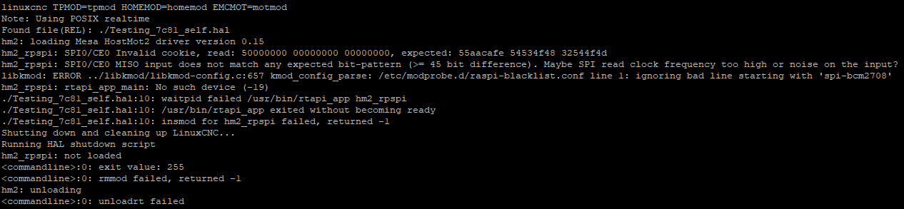

19 Dec 2023 06:38 #288550 by Mehta_123
I've changed the constant and frequency according to you !!
And inside IDROMConst.vhd :
constant ClockLowC81: integer :=  96000000;        -- 7C81 low speed clock
constant ClockMedC81: integer    :=  96000000;    -- 7C81 medium speed clock
constant ClockHighC81: integer  :=  192000000;    -- 7C81 high speed clock
Still not able to run linuxcnc :
Is there any mistake in changes ?
Thanks !!

19 Dec 2023 11:20 #288573 by Cant do this anymore bye all
Replied by Cant do this anymore bye all on topic Hardware specification of mesa 7c81
As the error states the spi clock frequency is too high or noise on the input.
19 Dec 2023 12:12 - 19 Dec 2023 12:13 #288576 by PCW
How long is your cable and do you have all grounds connected?
I would suggest < 2" maximum cable length and using all GNDs
Last edit: 19 Dec 2023 12:13 by PCW.
02 Jan 2024 11:22 #289546 by Mehta_123
Thank You soo much !!
It worked,  although I have to install 100MHz crystal oscillator.
Now I have to configure 3 axis CNC machine with spindle using Pncconf. Can you help how to configure ? Cause I have configured using this
Thanks !!
