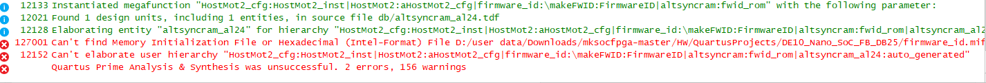

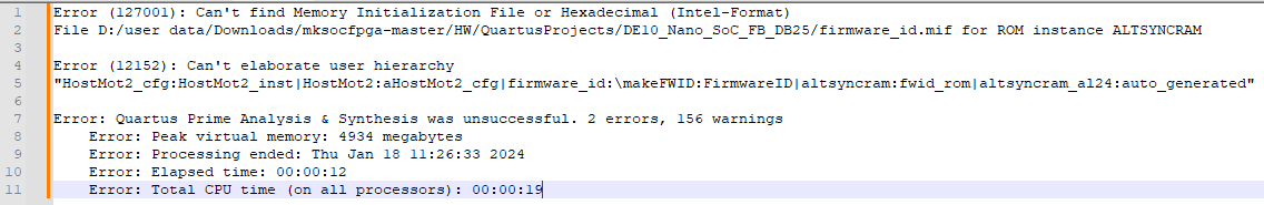

18 Jan 2024 09:27 #291010
by Mehta_123
Replied by Mehta_123 on topic Hardware specification of mesa 7c81
Hello !!
I have found following link for altera de10 nano.
github.com/machinekit/mksocfpga
While building this project facing some errors, also solved some errors but i am not able to solve one error.
Adding snapshot for your reference.
Can you help me with this??
Thanks !!

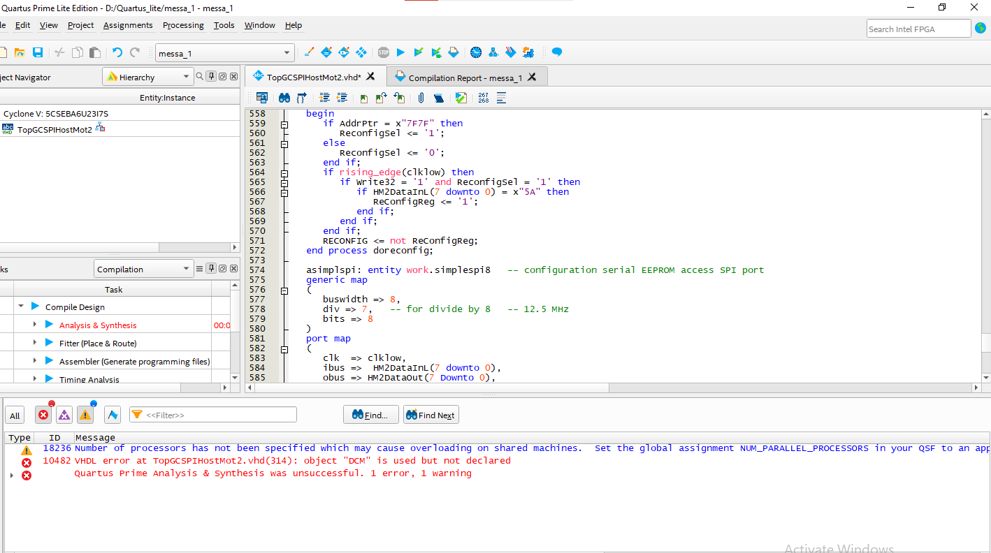

19 Jan 2024 07:21 - 19 Jan 2024 08:59 #291099
by Mehta_123
Last edit: 19 Jan 2024 08:59 by Mehta_123.
- Posts: 1200
- Thank you received: 426
19 Jan 2024 10:15 #291105
Replied by Cant do this anymore bye all on topic Hardware specification of mesa 7c81
I think DCM is a Xilinx primitive, so you'll have to search the internet for the Altera equivalent.

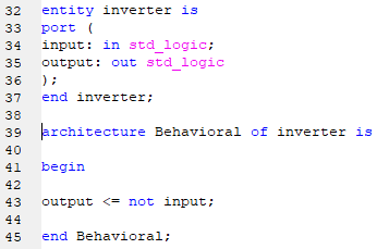

17 Feb 2024 07:34 #293584
by Mehta_123

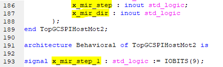

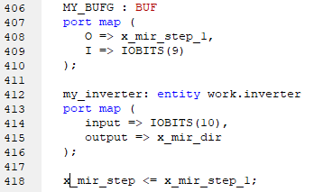

Hello !!
I was trying to implement mirroring of axis, as there is no support in GUI. So trying to understand source code but didn't get any luck (salute to the guys who made this..). But then I thought of way to mirror the axis without understanding the source code.
Simply assigned the step and inverted direction to the signals and added 2 output in top and ucf (pins that are not used by source code) file. Got synthesized and able to generate bit file, tested it but only getting one plus when I move forward/backward.
Is there something I'm missing ? Adding SS of snippets that I have added.
Also tried changing constraint file using "TIG" like:
NET "my_output" LOC = "A2" | TIG;
But in this I'm getting continuous pulse.
Can you help me with this ?
Thanks !!

- Posts: 18111
- Thank you received: 5330
17 Feb 2024 15:42 #293631
Replied by PCW on topic Hardware specification of mesa 7c81
There is no need to change source code for something
as basic as inverting an output. Almost any setting is
doable in hal:
setp hm2_7c81.0.stepgen.00.direction.invert_output true
doable in hal:
