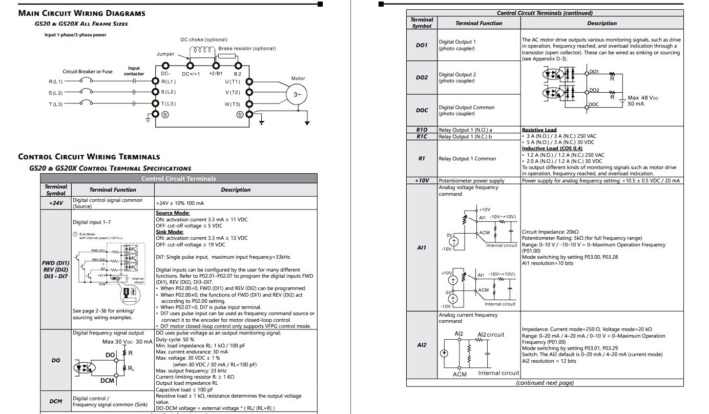

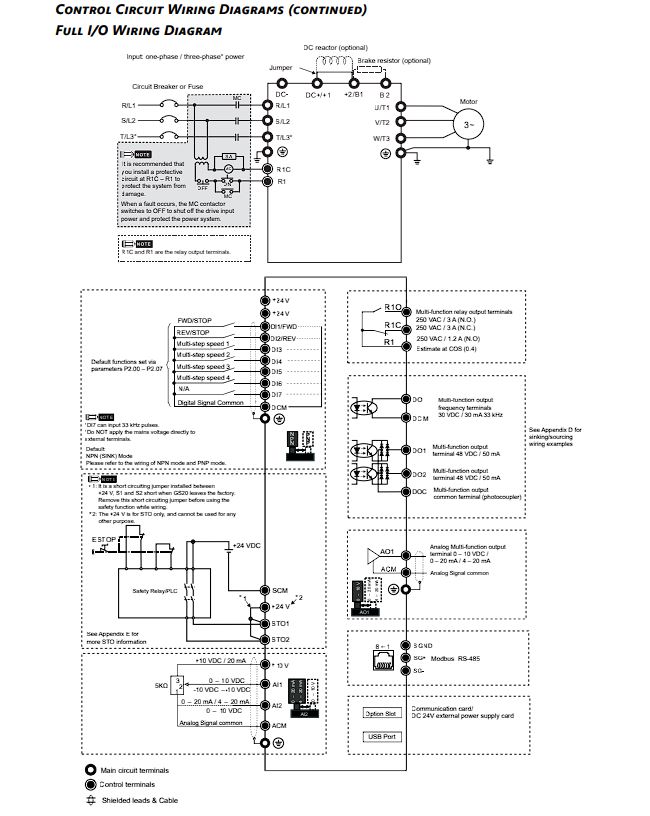

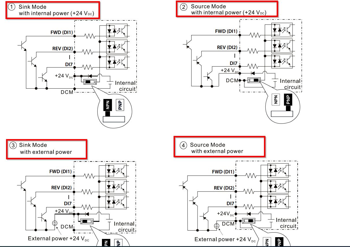

That looks correct for SINK mode, assuming you can program
DI1 to be RUN/STOP, DI2 to be FWD/REV and frequency
command from analog 0-10V input
I think this is P3.01 = 1 and P4.00 = 2

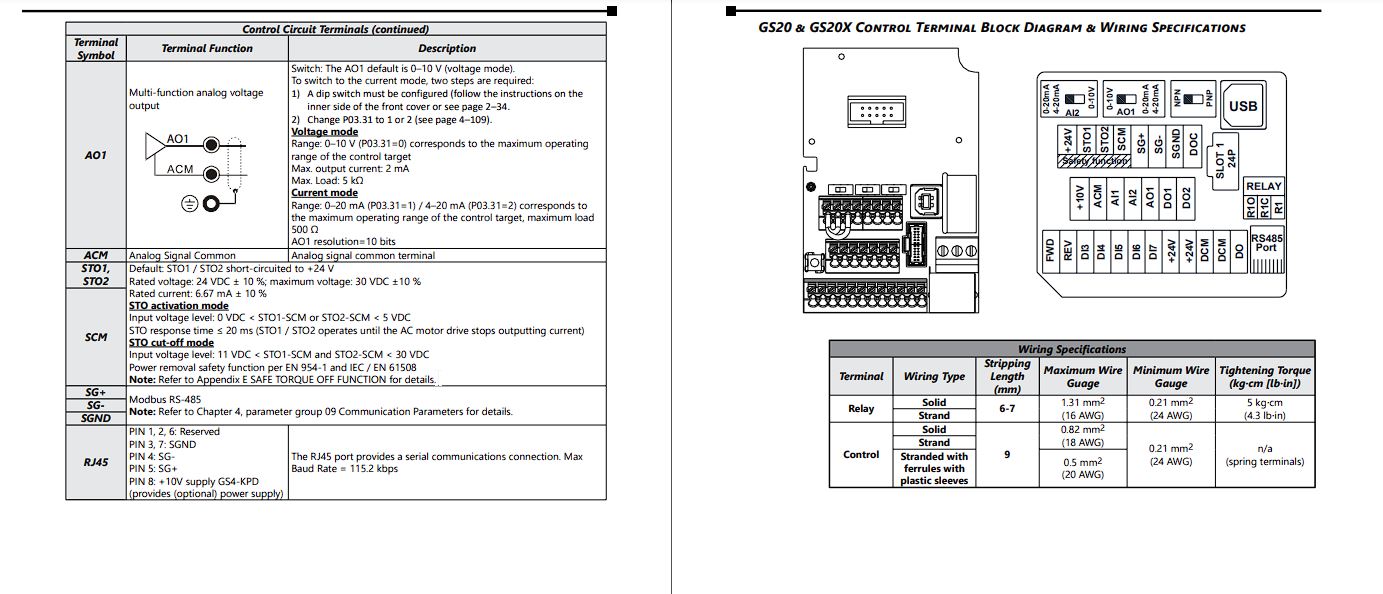

This doesn't work and I suspect that your Parameters may be incorrect.
Manual located here .
Thanks for your feedback though.

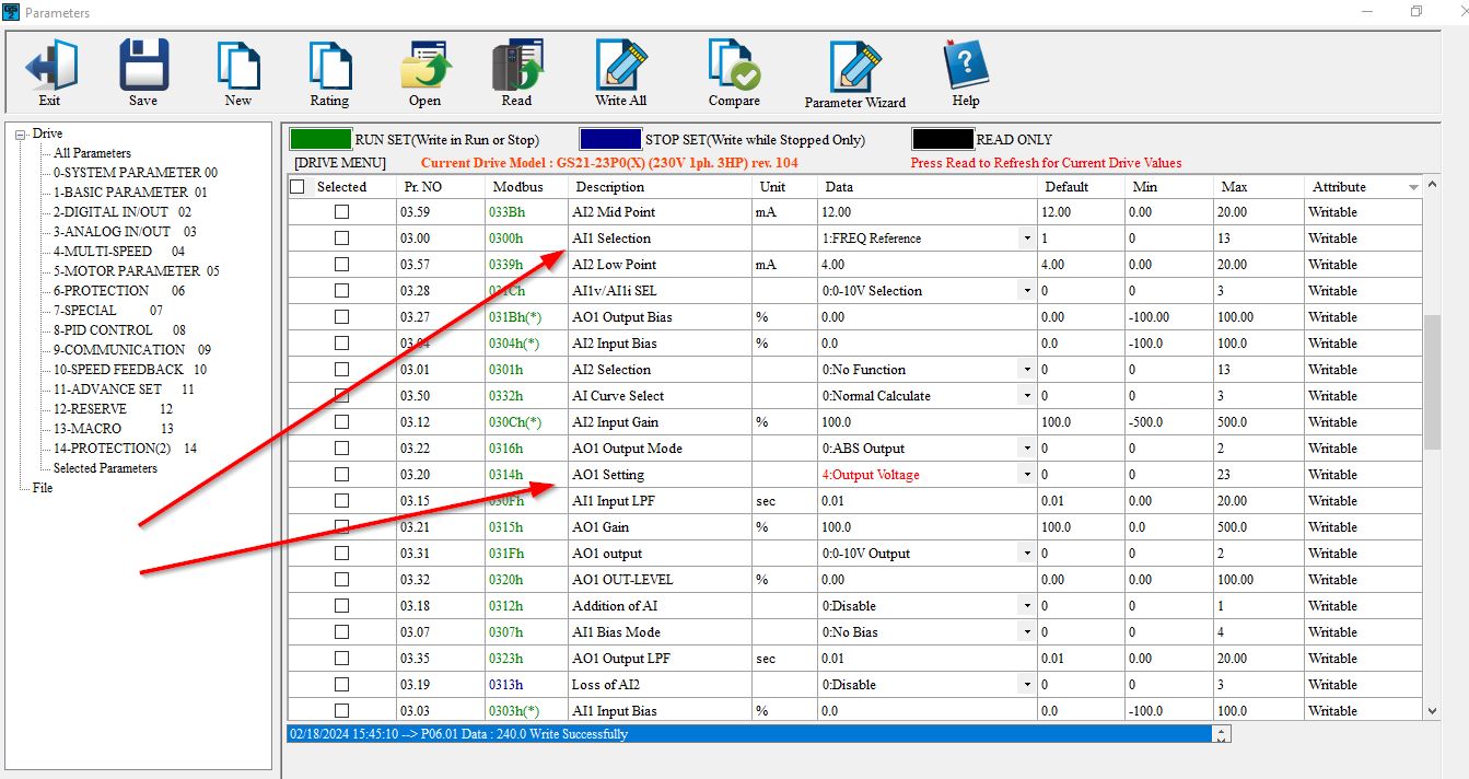

Ah... different GS2, this should be correct:
P00.20 = 2 Frequency command from analog input
P02.00 = 1 DI1 = RUN/STOP DI2 = FWD/REV

Elo1 over voltage is normally caused by too fast of a decel ramp or lack of a breaking resistor.
