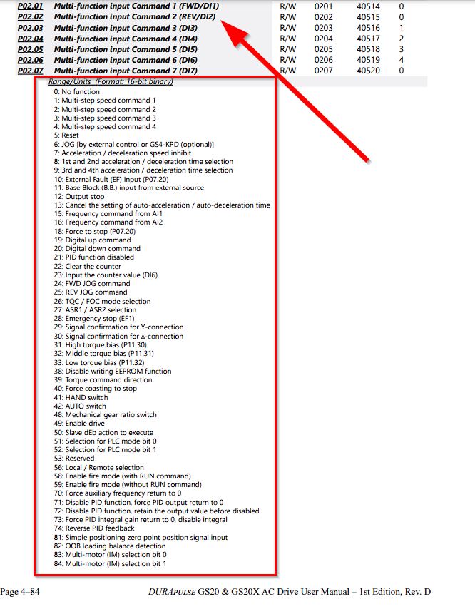

09 Mar 2024 21:56 #295540
by gardenweazel
Replied by gardenweazel on topic 7i76e to Durapulse connection
So, I have everything connected. From the 7i76e and in LinuxCNC I can start the spindle both forward and reverse.
The only problem I have now is that I can't control the speed of the spindle from LinuxCNC. The speed ramps up to my starting speed
and is uncontrollable. Stopping the spindle works just fine as well.
I saw some commentary about LOCAL and REMOTE modes but, I see now way to totally disable the LOCAL mode if that even
is indeed the issue.
Anyone else have or have had similar situations?

- gardenweazel
- Posts: 197
- Thank you received: 10
11 Mar 2024 15:51 #295647
by gardenweazel
I can control the spindle via the keypad if I config the VFD to do so, no problems.
I can start/stop the spindle with my 7i76e however I cannot change the speed from the 7i76e.
The spindle just ramps up to the START FREQ(83.33Hz) and remains as such even when I click on the plus button in Axis.
The LOWER FREQ is also set to 83.33hz as the spindle docs indicate to not run lower than 5000rpm.
The docs are very well written but, I note that there is confusion around the terminology of AUTO, MANUAL, LOCAL, REMOTE and HOA.
I suspect that the 83.33hz somehow plays a role in the following:
[SPINDLE_0]
P = 0.0
I = 0.0
D = 0.0
FF0 = 1.0
FF1 = 0.0
FF2 = 0.0
BIAS = 0.0
DEADBAND = 0.0
MAX_OUTPUT = 24000.0
OUTPUT_SCALE = 24000
OUTPUT_MIN_LIMIT = 0
OUTPUT_MAX_LIMIT = 24000
[SPINDLE_0]
P = 0.0
I = 0.0
D = 0.0
FF0 = 1.0
FF1 = 0.0
FF2 = 0.0
BIAS = 0.0
DEADBAND = 0.0
- Posts: 18109
- Thank you received: 5329
11 Mar 2024 16:58 #295655
Replied by PCW on topic 7i76e to Durapulse connection
Have you checked:
1. The voltage between 7I76E SPIN- and SPIN+
2. The voltage between 7I76E SPIN- and SPINOUT (at various spindle speed settings)
