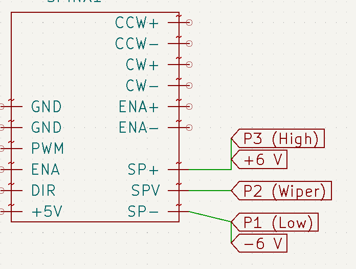

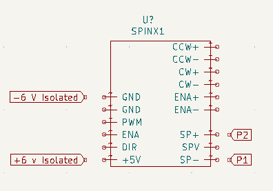

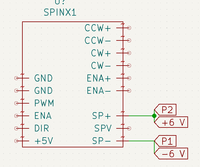

04 Mar 2024 15:15 #295141
by kbec
Replied by kbec on topic 7I96 Encoder Spindle tuning
So you are saying to rewire as in the attached diagram? The incoming port on the SPINX1 labels that as +5v. Would 1 V make that much of a difference?
I assume you are referring to this:
"The output of the control is a linear function of potentiometer rotation. The KBIC® can also be operated in a voltage following mode by supplying an isolated analog signal (0-7 VDC) to the input terminals P2 (+) and F-."
If that is the case, should I use +7 V or is that too much?, and I need to connect SP- to F -?.

04 Mar 2024 15:24 #295142
Replied by PCW on topic 7I96 Encoder Spindle tuning
No, the 6V supply connects to SP+ and SP-
+6V --> SP+
-6V --> SP- and P1
SPV --> P2
Nothing on the 5V 7I96 side should connect to the spindle drive
+6V --> SP+
-6V --> SP- and P1
SPV --> P2

04 Mar 2024 15:47 #295144
SPV (the variable 0 to +6V voltage) goes to P2
