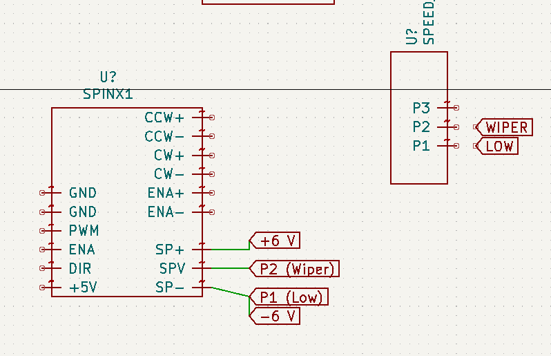

7I96 Encoder Spindle tuning
- Posts: 18025
- Thank you received: 5295
04 Mar 2024 15:58 #295147
Replied by PCW on topic 7I96 Encoder Spindle tuning
Yes, except P3 is left unconnected
- kbec
- Posts: 133
- Thank you received: 4
12 Mar 2024 23:55 #295795
by kbec
Replied by kbec on topic 7I96 Encoder Spindle tuning
- Posts: 18025
13 Mar 2024 02:04 #295798
That looks correct, make _VERY_ sure the 12V supply has no connection to GND
