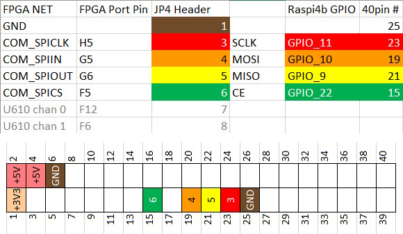

Hello,
I prepared the bitstream under Xilinx ISE 14.7 according to the changes described in github.com/q3k/chubby75/issues/85#issuecomment-1105762488. Here are the changes compared to basic hostmot2 for 7i90 from MESA site: github.com/golyakoff/hostmot2-rv901t-7i9...abf87a09ed5a3145c7d2.
I could flash the RV901 directly via JTAG from ISE iMPACT with the generic 72 GPIO bitstream.
But I could not connect to the device from Raspberry using SPI0:
Raspberry PI with Debian 12 from linuxcnc:
Linux pi-cnc 6.1.77-rt24-v8-ago #1 SMP PREEMPT_RT Sat Mar 16 18:05:52 MSK 2024 aarch64 GNU/Linux
In boot/broadcom/config.txt I enabled SPI0 with custom CE/CS pin:
dtparam=spi=on
dtoverlay=spi0-1cs,cs0_pin=22
When running the command
ago@pi-cnc:~$ sudo mesaflash --device 7i90 --spi --addr /dev/spidev0.0 --readhmid
Is see:
unable to set bpw32, fallback to bpw8
Unexpected cookie at 0100..0110:
00000000 00000000 00000000

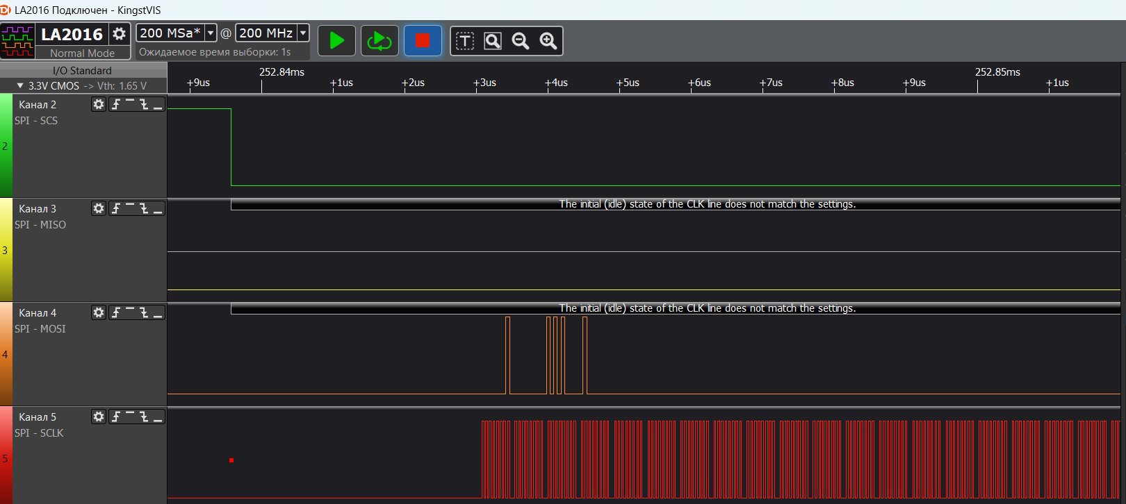

On the logic analyzer I see the following error:
The initial (idle) state of the CLK line does not match the settings (see attachments)

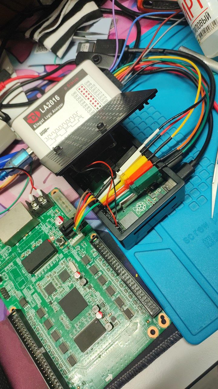

I used the short enough SPI cable (~50-70mm)
Could you please advise?

Hello, I just selected the closest in a row to avoid double-row pins. this GPIO is general purpose as I understand.

I did the upgrade according to the IlyaKw suggestion forum.linuxcnc.org/27-driver-boards/4773...901t?start=30#272597 and then just downgraded the input voltage of RV901T to 3.5V - it was enough to flash the bitstream to FPGA with the Xilinx ISE. So I decided to still with that solution for a while, but I ordered the SN74CBT3245 already, thanks!
I am not sure about the reasons honestly, I spent about an hour in order to understand how to enable SPI or my rpi4. In STM32 with CubeMX it was not so big challenge). But I took into account two points:
1. I did not see solutions with GPIO7-11 of SPI0 in the internet success stories related to rv901t and rpi
2. I do not actually know whether SPI0 is already taken with some internal peripheral sensors or eeprom or somewhat else.
gives: /dev/spidev0.0
shows tons of the output - not sure how to interpret the results...
I know that I didn't use SPI0 explicitly but not sure that some internal sensor or board chip is not connected there for system needs.
