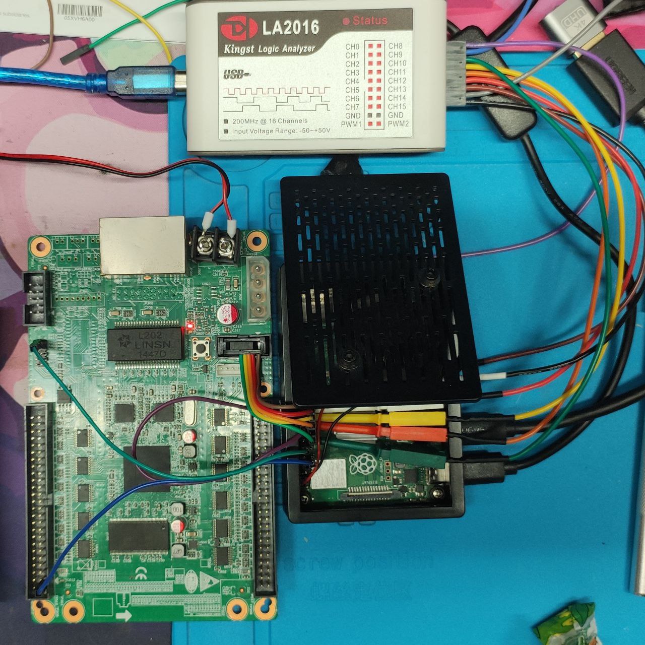

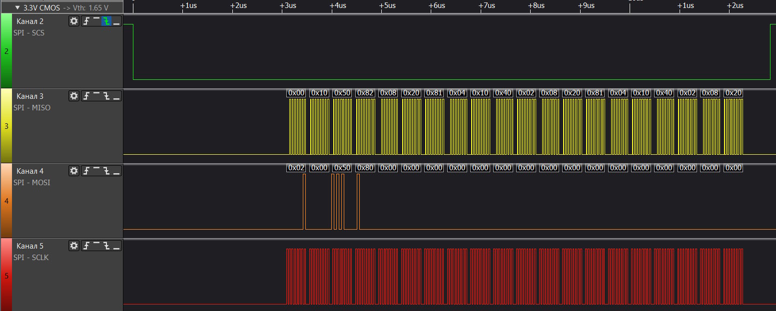

Looks like I get some progress with SPI, but there is only the understanding that SPI works good from RPi's side. The initial problem was in wrong analyzer customization (the falling edge of clock should be specified instead of rising edge).
(see the attachements)

My understanding is that communication on SPI is working, as I see some response packets on MISO line, but it looks like the looped message:
I understand that the problem is in the bitstream, but not sure how to start experiments there. Now at least I see "something" at MISO line, but not sure how to interpret this information.

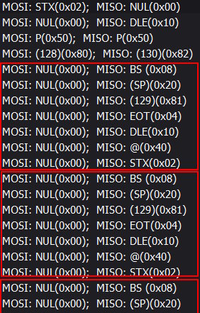

...My understanding is that communication on SPI is working, as I see some response packets on MISO line, but it looks like the looped message:

The FPGA slave output looks bizarre (like a clock)
One way I can see this happening (assuming the pins are correct)
is that you have double clocking from SI issues
Do you have enough grounds between the cards?
Ground bumping is a huge issue here, for example, the 7C81 uses all 8 RPI grounds
and AC bypasses all unused power pins giving a total of 12 HF ground returns to
avoid this issue.

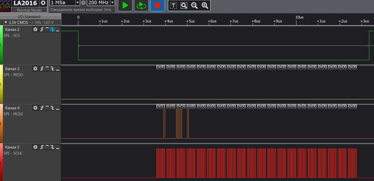

I did the changes related to the difference of crystal oscillator (25MHz instead of 50MHz in original 7i90): github.com/golyakoff/hostmot2-rv901t-7i9...64f0c39f21bfd875f86c
But the result is the same: I still receive a kind of garbage bytes in MISO line, for example:and bytes randomly differ each time.
I have no more ideas at this point...
What is the speed of SPI clock should be in the original 7i90? My is ~20 MHz...

Replied by PCW on topic Need help with RV901T as MESA 7i90: SPI isn't working
Did you fix the grounding?.
I would expect that kind of behaviour with only one ground wire.
SI issues like this will not be solved by lower clock speeds
if you do not get one bit shifted out for each clock, you have a SI issue...

Yes, I added 3 more wires to the different corners of the board (see the attachment).
Not sure what is the result I get - the MISO line became without any noise - now it always 0x00 (straight line 3v3). Looks like the "garbage data" was just a noise... At least it become correlate to the message:
Understand about the frequency. But I what you are meaning under "SI issues"? And how can I get one bit shifted? Could you kindly explain?
- Posts: 18025
- Thank you received: 5295
26 Mar 2024 21:25 #296841
SI stands for Signal Integrity
Note that adding the logic analyser
(if it does not have resistors in the actual probe clips)
will cause major SI issues by itself
You might try with the LA disconnected
Another possibility is adding a series termination
resistor to the clock line source end (say 47 Ohm)
