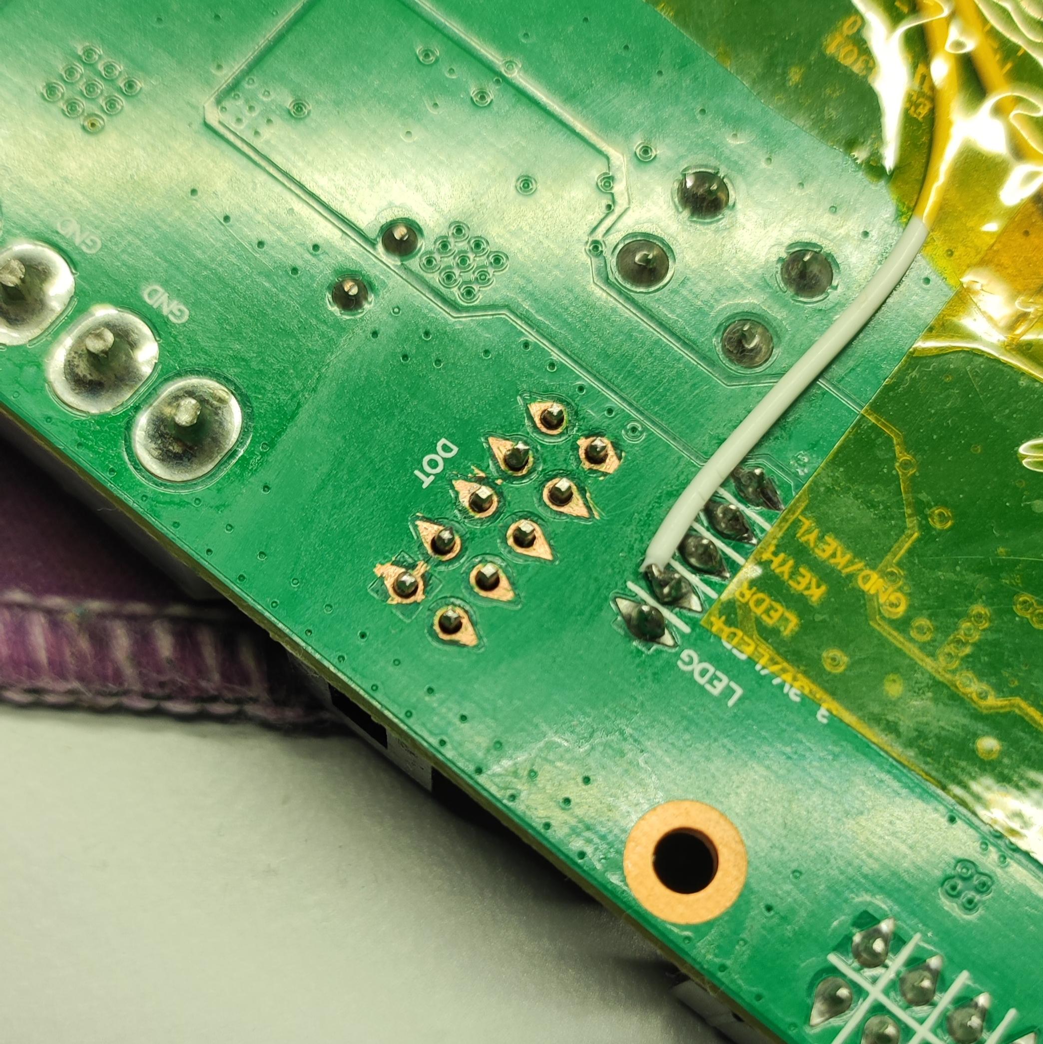

27 Mar 2024 21:01 #296940 by ago_tm
Guys, thanks a lot! Looks like there was my bad with the not very qualified soldering. I desoldered all the pads and cleaned the mask from them. Then returned all back and it start working! even with analyzer.
Still had to find the place of checking the crystal in mesaflash to avoid this:
sudo ./mesaflash --device 7i90 --spi --addr /dev/spidev0.0 --fallback --write ~/Downloads/topgcspihostmot2.bit
Checking file... OK
  File type: Xilinx bit file
Error: wrong bitfile destination device: 6slx16ftg256, should be 6slx9tqg144
But this is the minor thing. Thanks again!
Checking file... OK
Hmmm... I easily changed the following line
board->llio.fpga_part_number = "6slx16ftg256";
but now I faced with the BootBlock...
$ sudo ./mesaflash --device 7i90 --spi --addr /dev/spidev0.0 --fix-boot-block --fallback --write ~/Downloads/topgcspihostmot2.bit
unable to set bpw32, fallback to bpw8
Checking file... OK
Erasing sector 0 for boot block
BootBlock installed
Failed to write valid boot sector
Is it possible to write the fallback bitstream to the flash using mesaflash in my case?
27 Mar 2024 22:34 #296947 by PCW
what does:
sudo ./mesaflash --device 7i90 --spi --addr /dev/spidev0.0 --verbose
report?

28 Mar 2024 14:51 #297003 by PCW
Ahh I had forgotten that only Ethernet and serial cards provide
a lot of info from the --verbose command, including the FPGA
flash memory size, ID code and write and erase page sizes:
    3: FPGAFlsh (flash, RW, 32-bit) [size=16M], page size: 256, erase size: 65536
  [space 3] FPGA flash eeprom:
    flash size: 16Mb (id: 0x14)
I suspect some error either with an unsupported flash chip or maybe a
SPI pinout issue
The following user(s) said Thank You: ago_tm

28 Mar 2024 21:23 #297041 by ago_tm
I finally get flash written with just using the same SPI0 on RPI and JP5 connector
JP5 connector on RV901T
In Xilinx ISE it it required to set the output bitstream format as bin (right click on the "Generate Programming File" > "Process Properties..." > "Create Binary Configuration File" ☑ ).
Then
sudo apt install -y flashrom
sudo flashrom -p linux_spi:dev=/dev/spidev0.0,spispeed=10000
> Found Winbond flash chip "W25Q32.V" (4096 kB, SPI) on linux_spi.
sudo flashrom -f -p linux_spi:dev=/dev/spidev0.0,spispeed=10000 -w ~/Downloads/TopGCSPIHostMot2.bin
> Error: Image size (524288 B) doesn't match the expected size (4194304 B)!
dd if=/dev/zero bs=1 count=1 seek=4194303 of=TopGCSPIHostMot2.bin
> Reading old flash chip contents... done.
> Erasing and writing flash chip... Erase/write done.
> Verifying flash... VERIFIED.
I also tried to make a kind of SPI-bridge bitstream for the board to avoid disconnecting of the rv901t board from the RPi, but it is not my level of fpga configuring yet.
Anyway, I think I can mark it as [solved].
Many thanks to PCW and cornholio!
Not sure, probably this thread better to move to the Hardware & Machines section.
