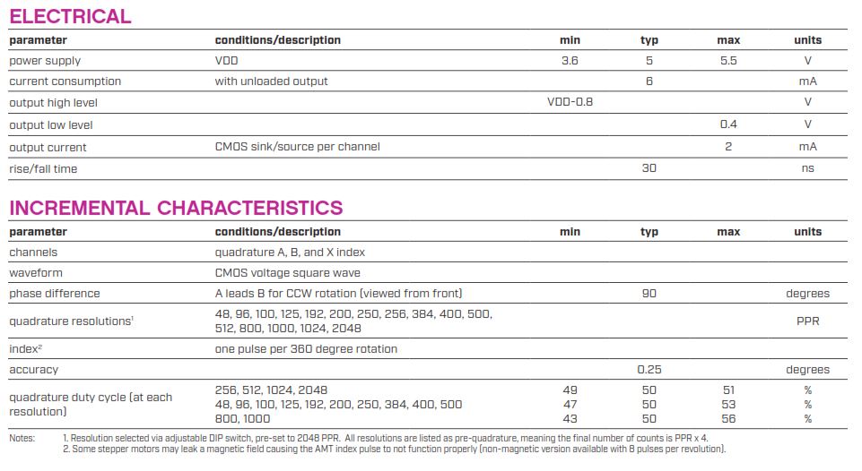

This is for a small stepper powered mill, I would like to run in a closed loop with linuxcnc.
Components I am working with:
NEMA23 dual shaft steppers, 1/4"(6.35mm) shaft dia. , .750"(19.03mm) hole spacing for encoder
Mesa 7i85s
The main constraint to work around seems to be the mounting dimensions this size of stepper requires.
Then the next factor is compatibility with the mesa inputs, but that looks to be a bit more flexible.
I have been looking through several US suppliers, and haven't found too many options with good
documentation yet.

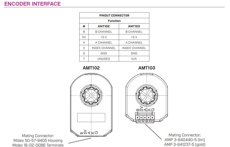

At the time of this post, the most dimensionally compatible option I have found is a CUI AMT10 series
incremental encoder. I will attach some pictures of key electrical specs I found on this unit below.
This CUI encoder is marketed as using some form of "capacitive" tech with a "CMOS" output. It has a
5pin connector, 5v power spec, quadrature output, and an 8 pulse index. Looks like it may work with the
mesa board, but with single-ended outputs, although I am not entirely sure it is going to produce a
strong enough signal to work reliably. There does appear to be decent off-the-shelf shielded cables
available for this encoder, so that should help somewhat with EMI problems.
That is the general information I am working with, hoping to get some input on compatibility with the
7i85s, or hear other more functional options.

10 May 2024 01:37 #300265 by PCW
The 7I85S encoder inputs in single ended mode have a 2K ohm input
impedance (2K pullups to 5V) and a ~1.65V threshold so are compatible
with TTL, 5V CMOS and 3.3V CMOS output levels, as long as they can
sink the 2.5 mA pullup current.
