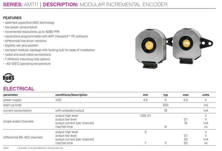

10 May 2024 02:40 #300273 by blazini36
Replied by blazini36 on topic Encoders for a Stepper System with a 7i85s
The more pertinent detail that still hasn't been covered is encoder compatibility with a 7i85s, more specifically, what is the
practical minimal signal current that the mesa input can reliably read. From what I saw on the CUI documentation in the first
post, it looks like that type of encoder may not have very strong signal output.
Well that type of info is always clearly specified in the Mesa card manual. I didn't look at it but PCW's the guy that makes the cards and he says it needs to be able to sink 2.5mA while your datasheet says the max output current of that encoder is 2mA it's probably not the greatest match. Probably a good thing you looked at that as I never really do, 2mA max output seems extremely low to me.
Utilitas post=300264 userid=38943
My comment regarding "fullstep output" was not meant as "encoder output" but rather as an alternative to a closed
feedback loop, ie. monitoring the "fullstep output" from the driver to throw a fault in the event of a stall. This was a thought
that came to mind after reading discussions in several places that suggest closed loop stepper systems are not worth it.
Anyhow, please forget that I brought that up, the more useful topic is bebunking the usefulness of a capacitive encoder,
and outlining what the minimal signal current constraints for a 7i85s really are.
As PCW mentioned, that's the purpose of the CL stepper drive's alarm output. You don't have to monitor pulses and deal with a control loop, the drive does that, you just monitor a digital output...pretty simple.
Not sure where you are reading that closed loop stepper systems are "not worth it" and what the context is but the sentiment around here is that it's more worth it than the setup you want to use, that includes the guy who makes the Mesa cards. If you already have the 7i85s and want to use it stepper online sells optical motor encoders separately or you can just buy the closed loop motor, they'll all output at least 5mA

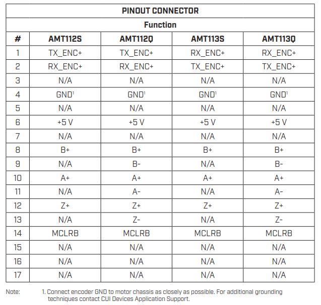

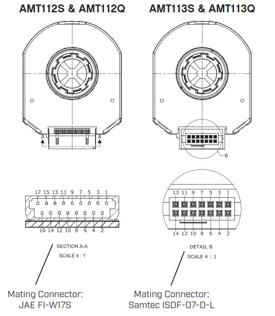

10 May 2024 05:35 #300290 by Utilitas
Replied by Utilitas on topic Encoders for a Stepper System with a 7i85s
After I read spumco's post mentioning the capacitive encoder on a lathe, I decided to go back and give the CUI
catalog a more thorough look, and sure enough, there was a differential model I had not noticed. And this one
has higher current ratings.
CUI AMT113Q
(datasheet info attached below)
I also noticed these have some level of programming support and can accept zero state input (connector pins 1,2,14)
Mouser sells some form of UART programming cable for the various versions of these encoders, software is on the
CUI webpage but only for windows systems I believe.

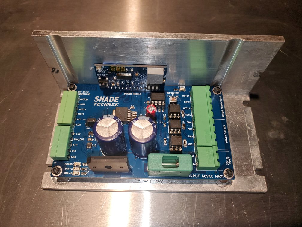

Lol dude you have a way of oddly oversimplifying things while overcomplicating others. I've been dealing with Industrial machinery my entire life, but that's not the point. Stepper motors are so heavily manufactured these days, if the shaft is straight and the paint is good, it's gold. IF you're running it off a modern drive that is, and sometimes that's not always a possibillity.....
Describing the rotor mass of a motor doesn't say anything about the quality of the motor, I have no idea why you're using that as a metric. That's part of specifying a motor. What you basically said is "Toyota's suck cuz they aren't green". Not sure why you think Chinese people can't make a high inertia motor. And BTW, quiet motors are a function of the stepper drive, not the motor itself.
Coil characteristics do matter, it's just these days you can just choose not to care. On on older amps you could wind up not even being able to spin the motor at all if coil resistance was much lower than what it was intended for. I wound up having to design this stepper drive to take care of some 90s era OEM stepper amp shenanigans...
