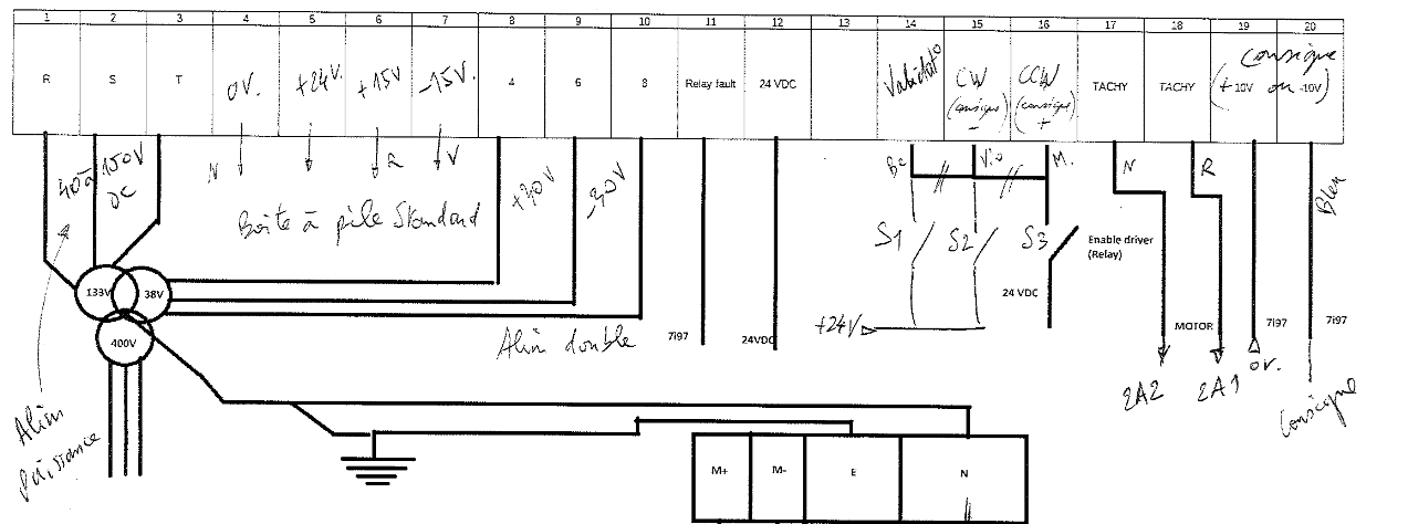

I managed to recover a big cn lathe, I'm on cable and make the DC drivers work but impossible to make them work (I don't have any schematics and I don't know if they're still operational but the 2 don't work so the probability that it's me the problem is high). has anyone been confronted with NUM GEC MK2S drivers?
when retrofitting i took care not to disconnect the control cables (motor, tachy, enable, etc...) after wiring with my 7i97 board, i try to enable the axes but no noise and no movement possible.
diagrams below:
the enable contactor I drive with driver enable because on the old cn it was the only output coming from the drivers so I assume it's the enable.
if unfortunately I can't get the drivers to work, can I replace my current drivers with these?
old driver - NUM GEC MK2S S.57.27.001.B 24V3800-20 Variateur 27A

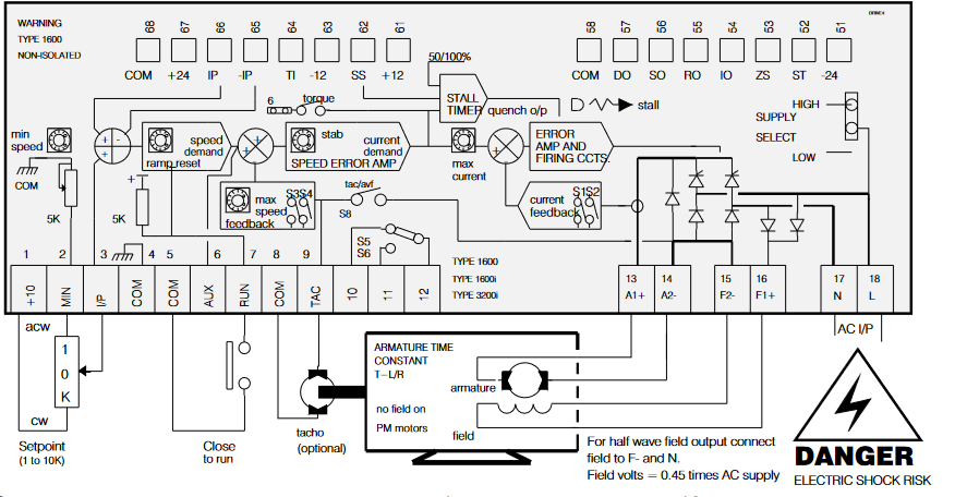

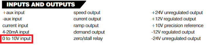

as below, i've found a driver with the following characteristics:
-an output voltage of 180V if powered in 220 two-phases or 220 single-phase (I have both on my cnc)
-a max current of 32A and accepts a 150% peak, i.e. 80A
so far so good, but my questions are as follows

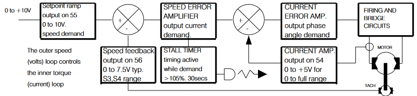

- in the specifications it talks about 0-10V input, but on the schematic you can see that it's marked CW and ACW, so is it compatible with -10V +10V?
-I can see data from the tachometer which is "speed feedback output 0 to 7.5V" and my motor is 9.5V. What should I understand from the tachometer characteristics?
- Finally, is this really a DC driver for my motors for axis use or is it a kind of VFD for DC motors?

28 Jun 2024 17:34 #303979
Replied by PCW on topic Driver NUM GEC MK2S
That does not seem to be a +-10V servo drive
but rather a SCR DC motor controller that
depends on AC for commutating the SCRs
so even if it had a +- input would be very
sluggish in response to commands
What is wrong with the current drives?

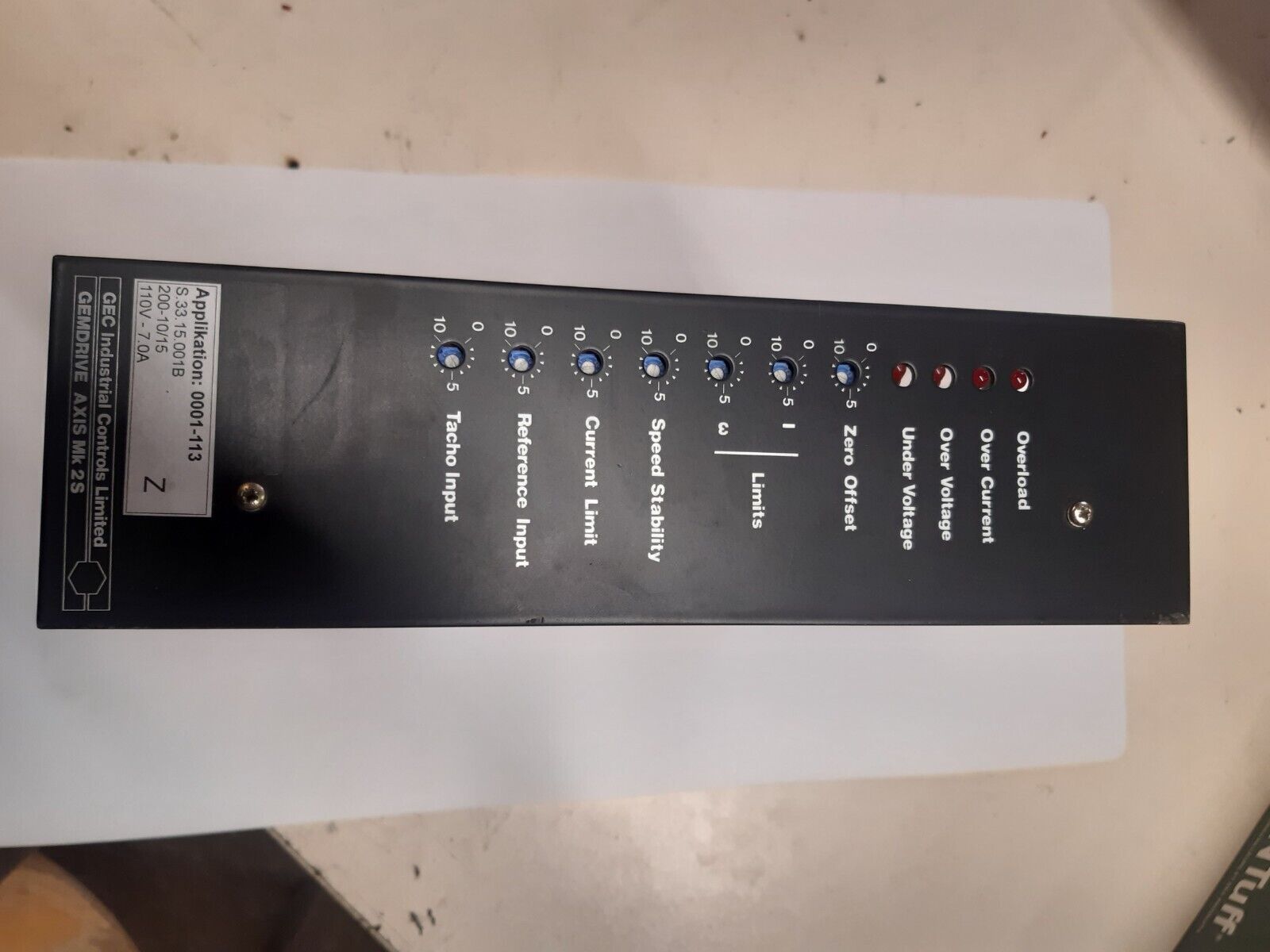

20 Aug 2024 15:27 - 20 Aug 2024 15:28 #308220
by greg23_78
Replied by greg23_78 on topic Driver NUM GEC MK2S
I have just received my reconditioning drivers, 1 driver was defective in one direction of rotation.
i started reassembling the drivers and tuning the engines.
it's at this point of tuning the motors that i have a problem.
when i put enable on my drivers, my motor turns in 1 direction at high speed and when i press it, it goes in the other direction.
I remove the analog to see, and it happens again.
so i guess it's due to the settings on my drivers and the tach.
how do you set this type of driver with the front buttons?
Last edit: 20 Aug 2024 15:28 by greg23_78.

20 Aug 2024 15:33 #308221
Runaway of an analog velocity mode drive with no input
may be because the tachometer leads are reversed.

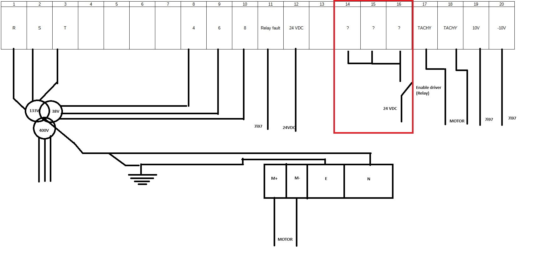

20 Aug 2024 16:34 #308228
by greg23_78
I think it works, the motor turns in 1 direction very slowly.
now my problem is with the analog, i don't get any response from my drivers when i jog.
I've tried reversing the wire but nothing changes.
this is the driver repairer's notes, sorry it's in french.
i think i've connected my 7i97t and my driver correctly.
pin 3 (7I97T) -) pin 19 (driver)
pin 4 (7i97T) -) pin 20 (driver)

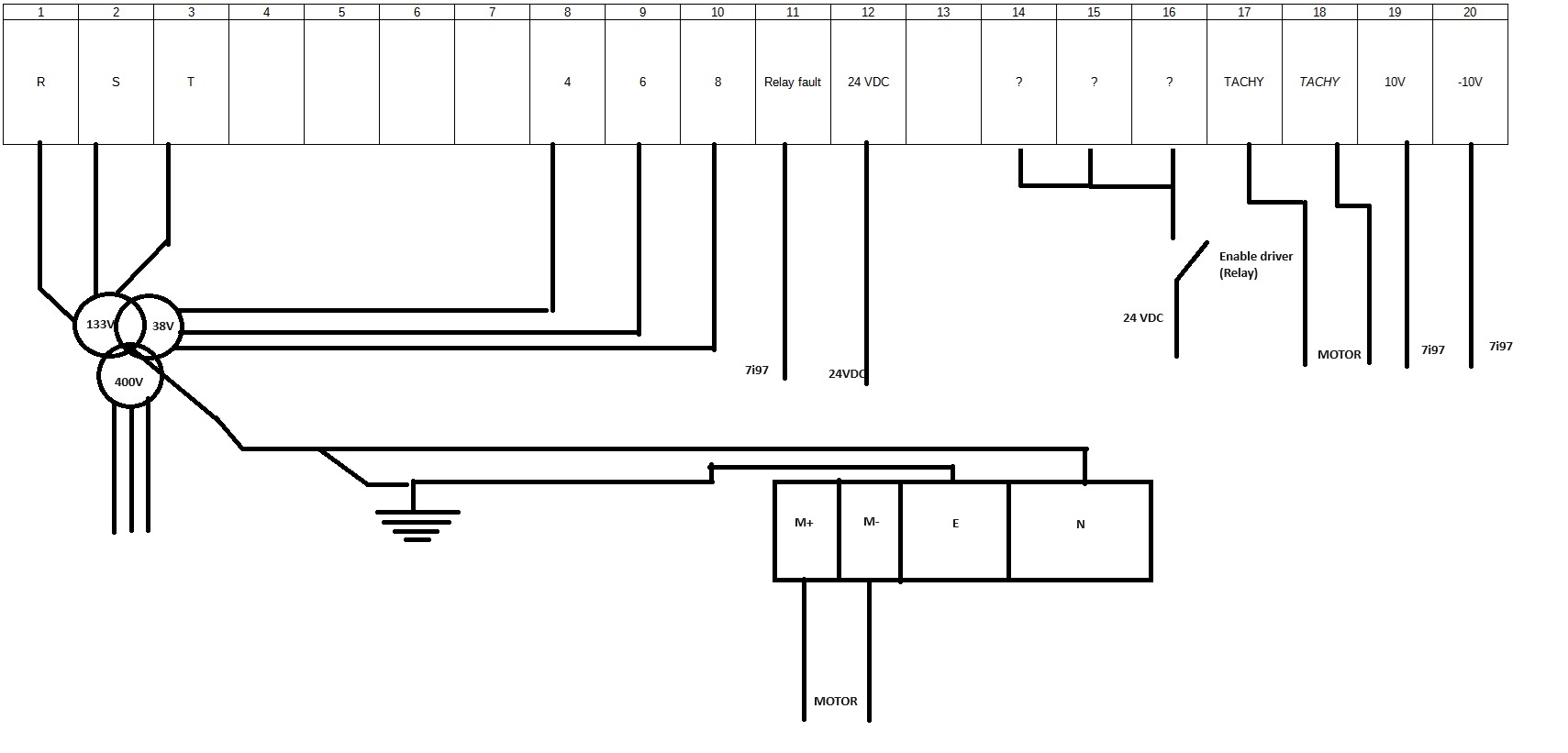

- Posts: 18093
- Thank you received: 5325
20 Aug 2024 17:06 #308230
Can you post your hal/ini files?
