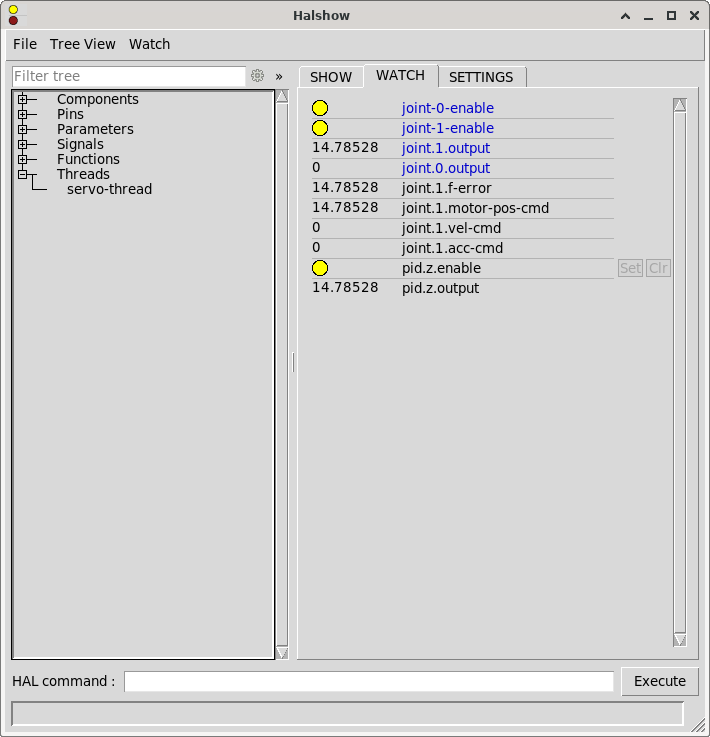

21 Aug 2024 09:34 - 21 Aug 2024 10:06 #308274
by greg23_78
Replied by greg23_78 on topic Driver NUM GEC MK2S
indeed it was missing
net joint.0.output => hm2_[MESA](BOARD).0.pwmgen.00.value
and I made the change, but my drivers still don't jog.
I tried my drivers by applying a DC power supply to my analog input (driver) and the driver works correctly.
HAL
INI

21 Aug 2024 14:07 #308290
Replied by PCW on topic Driver NUM GEC MK2S
Looks like the PWM enables are missing also:
net joint-1-enable <= joint.1.amp-enable-out
net joint-1-enable => pid.z.enable
net joint-1-enable => hm2_[MESA](BOARD).0.pwmgen.01.enable

21 Aug 2024 15:31 #308304
by greg23_78
thank you, I hadn't noticed that was missing.
now, when activating the drivers, the motor goes into Z+ at high speed.

21 Aug 2024 15:44 - 21 Aug 2024 15:45 #308307
That's probably expected.
You have about a 50% chance of an initial
runaway because the feedback direction is
wrong, that is you have positive feedback = runaway
rather than negative feedback = position control.
If the encoder direction is correct, you fix this by
changing the sign of the PWM scale.

22 Aug 2024 13:59 #308398
by greg23_78
I changed the output-scale sign and now it works.

i put 10V on the drive and control the speed with a tachometer ?
but how adjusting the drives velocity loop gain as high as possible while remaining stable ?
which button should I modify ?
-Zero offset
-Speed stability
-current limit
-Reference input
if i understand correctly, i have just mechanically disconnected my motor from my Z axis.
-Zero offset
-Speed stability
-current limit
-Reference input
Last edit: 22 Aug 2024 15:10 by greg23_78.
- Posts: 18093
- Thank you received: 5325
22 Aug 2024 15:29 #308405
Is there a tachometer from the motor connected to the drive?
- greg23_78
- Posts: 142
- Thank you received: 7
22 Aug 2024 15:47 #308407
by greg23_78
yes, the tachometer is connected to the motor.
i wanted to talk about a laser tachometer to measure speed because my encoder is no longer connected to the motor.
I've just put 10V into the analog input and the motor is running correctly.
