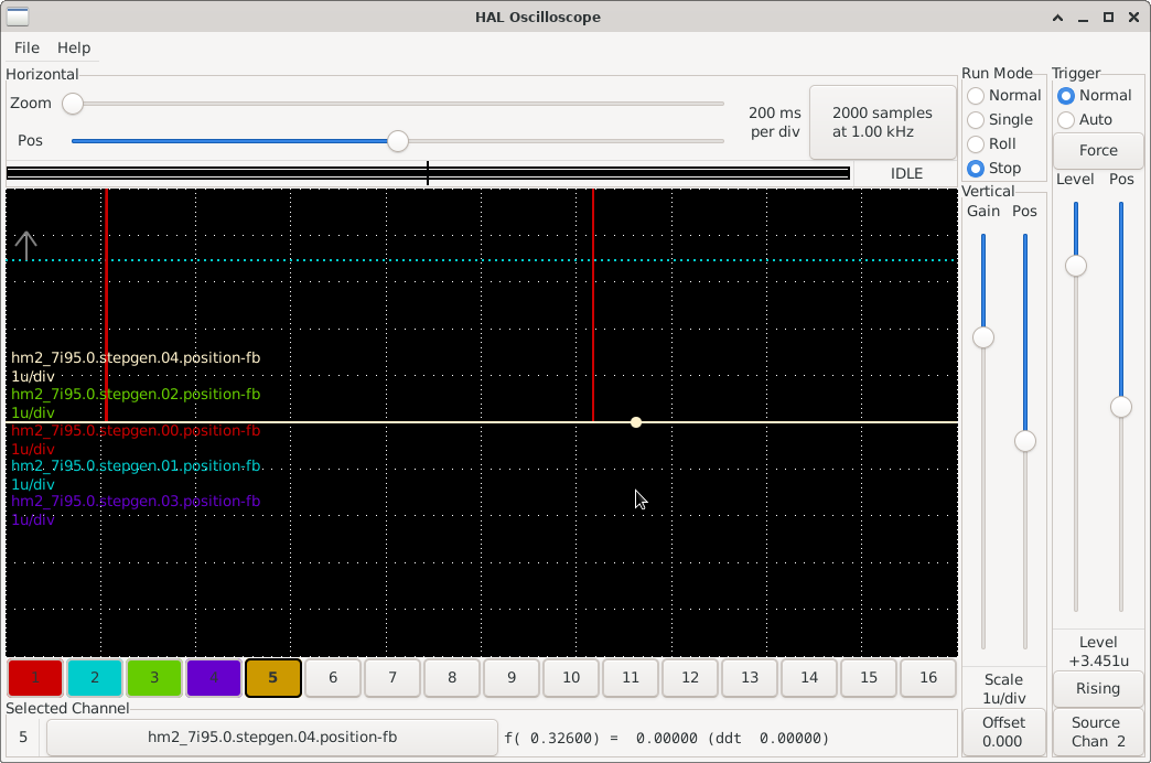

I am using the 7i95t_1pktv2d.bin firmware for my Maho MH600T for controlling the spindle VFD. After I got the Modbus communication to the spindle working I started getting following errors, and this is still without using encoder feedback. There are jumps in the stepgen.xx.position-fb while everything is idle. I condensed the setup as much as possible to try to pinpoint the issue, and this is outlined below.
Using 7i95t_1pktv2d.bin firmware:
I use this minimal test.hal which I run with "halcmd -f test.hal":
With this maho_vfd.mod:

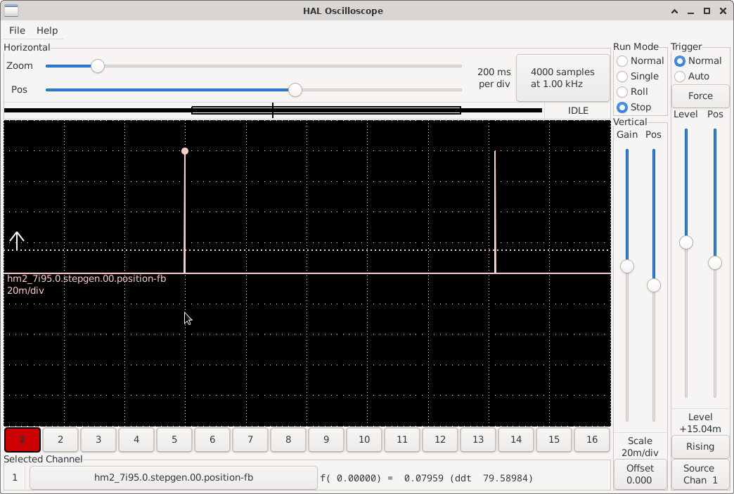

I get these jumps in hm2_7i95.0.stepgen.00.position-fb:
Currently I don't have the VFD connected, and the jumps occur every second plus some. This occurs more frequently with the VFD connected and communication working. I imagine the jumps occur on every Modbus request. Strangely enough, I don't see the issues if leave the num_stepgens undefined for hm2_eth. And I could do just that and go ahead with my life. But I fear this will come back to bite me if I do.
Any ideas what may be causing this? Some problem with my setup? A bug in the Mesa driver or firmware?

I think I have see that before and it looks like a bug in the mesa_modbus driver.
(the 1 Hz is the modbus timeout/retry period) In my testing, it went away mysteriously
and I was not able to re-create it. Looks like maybe request/reply mismatch in some
circumstances.Can you retry the test with the stepgen position not at 0?
(that would provide a bit more information.)

Okay, so this is not reproducible for you. I also think it was working for a short while for me before I started getting the following errors.
The value position-fb jumps to is consistent across time and even if unloading all modules and starting over. But it has changed as well at some time, but I'm not quite sure what has been the trigger for that. Perhaps some change in the modbus .mod "config", but I'm not sure.
I actually was also thinking about narrowing it down by a ethernet capture, and already took one with Wireshark. I could see the LBP16 commands, but have not tried to decipher what is written/read yet (by the LBP16 commands). But just by looking at the source code, it appears the step rate is written and the position feedback (16.16 floating point accumulator) is read back. It shouldn't be too difficult to figure out if something strange happens with those. Hopefully
