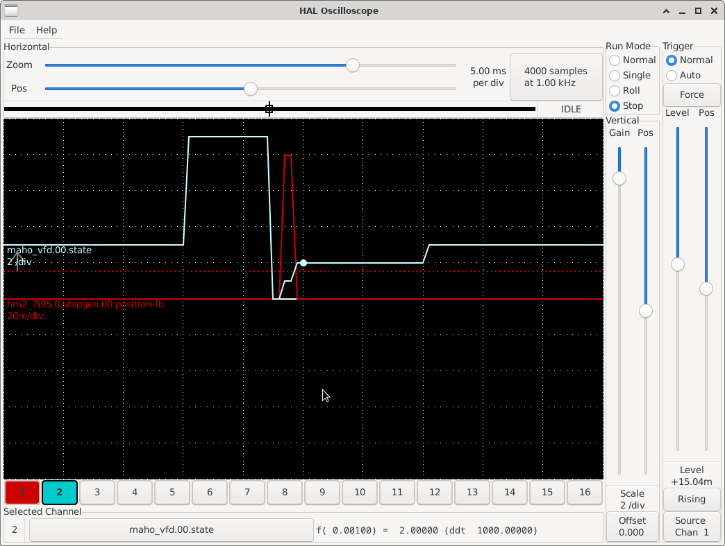

Thank you for investing time in this. Of course, if the issue is not reproducible for you, the "return on investment" for you looking for the cause is very low.

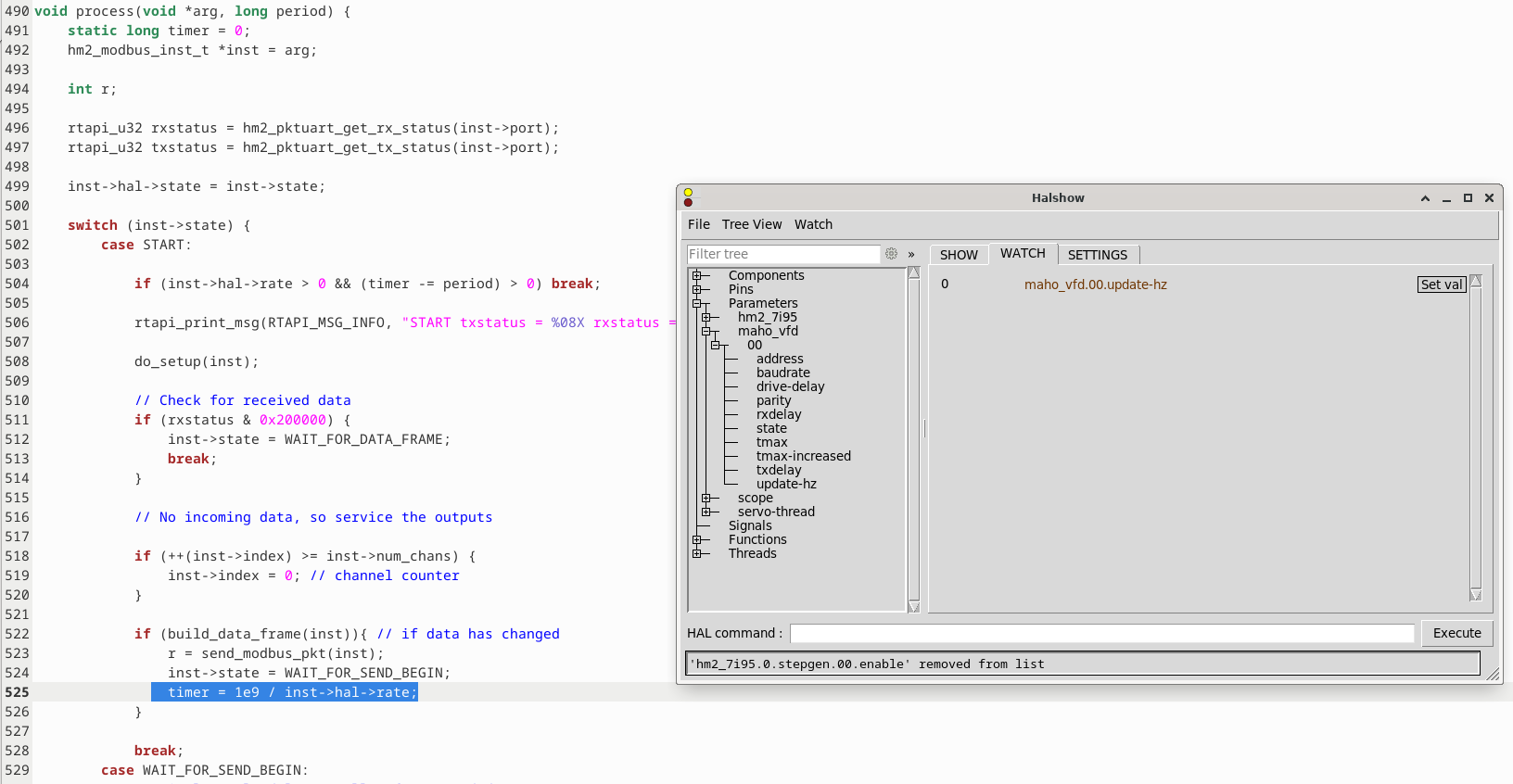

I have done a bit of investigation myself, by looking at the network traffic. There will be quite a bit of information here, but I would say the conclusion is that the jump in position-fb is not visible in the packets from the 7i95T. In other words, the cause almost has to be somewhere on the linuxcnc side.
I changed my config to enable some debugging information and reducing the "modules" as much as possible (while still having the jump in position-fb):
loadrt threads name1=servo-thread period1=1000000
loadrt hostmot2 debug_module_descriptors=1 debug_modules=1
loadrt hm2_eth board_ip="10.10.10.10" config="num_stepgens=5 num_ssrs=0 num_inmuxs=0 num_leds=0" # This causes jumps in hm2_7i95.0.stepgen.00.position-fb
addf hm2_7i95.0.read          servo-thread
addf hm2_7i95.0.write         servo-thread
loadrt maho_vfd ports=hm2_7i95.0.pktuart.0
addf maho_vfd.00 servo-thread
start
The console output from starting the script is:
$ halcmd -f pktuart_bug.hal

I took a network capture of running the script and stopped it only once I had seen a position-fb peak in halscope. The file is attached. I also created a small python program to parse the capture file, and I have attached that as well. With the parse and capture file, I run the following commands:
$ ./lbp16.py capture.pcap > capture.txt
$ cat capture.txt | grep "ADDRESS 0x2000" | grep -v "DATA 0x0000000000000000000000000000000000000000"
$ cat capture.txt | grep "ADDRESS 0x2100" | grep -v "DATA 0x0000000000000000000000000000000000000000"
None of the commands generate any output. This means that step rate register 0x2000 is never written anything else than 0, and the accumulator registers 0x2100 never reads anything else than 0.
I'm not exactly sure what my next step is at the moment. But if you think mesa modbus is the prime suspect, I might start looking around at that code.

Well, I found something already. There is a divide-by-zero on line 525 below (line numbers differ slightly from official code), because inst->hal->rate is not initialized in the code, and at least in my case it defaults to zero. Changing it to 1 from halshow causes the jumps in position-fb to stop. At least for now :)
I guess the divide by zero causes a fault/interrupt handler to be called and the execution state/context may be lost/upset? At least I'm imagining something like that. If somebody can produce a better or more accurate explanation, it would be interesting to hear.
This seems to me like a clear bug. Is somebody able to take this forward from here, or give me advice on how I can make a bug report?
edit: The hal pin related to inst->hal->rate is named update-hz. I though I'd point that out, as the connection is by no means apparent from the screenshot.
Last edit: 05 Nov 2024 18:26 by Finngineering. Reason: Clarification
05 Nov 2024 18:58 #313842 by PCW
Maybe related to the bug I mentioned with update rate:
   If you ever set the update rate to 0 (maximum), changing to a
    non-zero rate will not work (communication stops)
05 Nov 2024 20:45 #313851 by Finngineering
Replied by Finngineering on topic Strange stepgen behaviour with 7i95t_1pktv2d firmware
Yes, that may very well be the case. The following lines are from the code (but not directly following each other like shown):
static long timer = 0;
if (inst->hal->rate > 0 && (timer -= period) > 0) break;
timer = 1e9 / inst->hal->rate;
When update-hz is 0, then there is also a division by zero in the last line. Maybe what effects this have depends on the system. The result of the division may be +infinity (which is a valid float). When that is the casted to a 64 bit(?) long, that may give a very big number, which during the next iteration causes the if statement to take the "break" branch for practically all time in the future. There are lots of "ifs" here, and I think that at least some things are implementation dependent.
