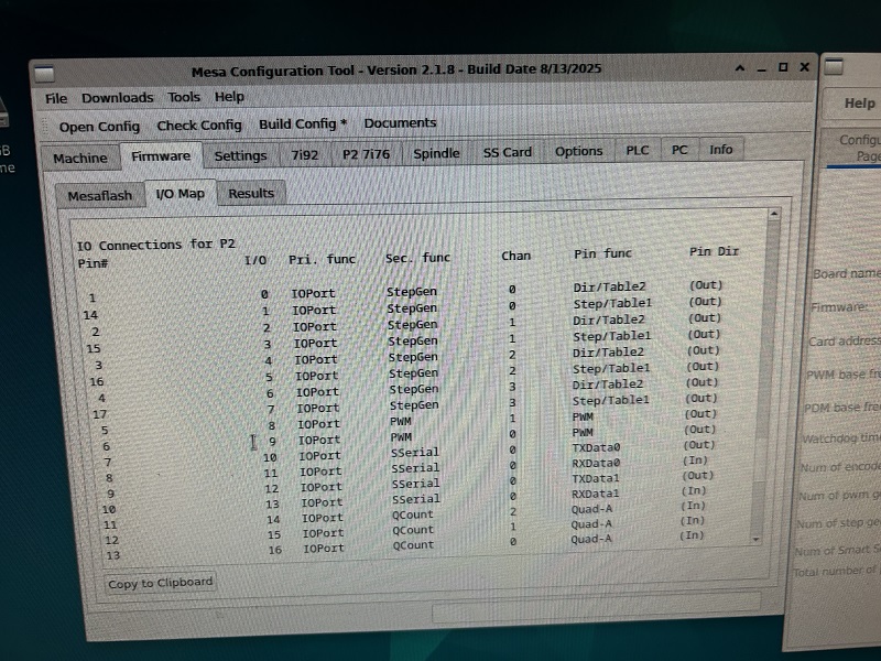

Hi I found a 7I92_7I76x1dpl.bit which would be good.According to its description, it also has 2 PWM outputs onP2 7-8 I/O.Unfortunately, the description and reality are not the same.It doesn't have a PWM output.
The card has 2 IDC 26 connectors.
1 connector standard LPT assignment 1-25. 26 pins +5V
2 connectors 1-17 pin input 18-25 GND 26 pin +5V
Where can I get the 7I92_xxx.vhd files?

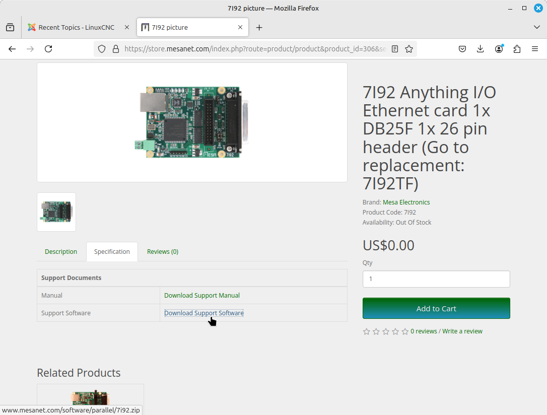

First, it's still not clear whether you have a 7I92 or 7I92T(x)
The support software zip file that has all the sources and project files
needed to build firmware files is downloadable from Mesa's webstore
(in the specification tab for the appropriate card)

CT identifies it as Mesa 7I92 and suggests corresponding files for upload.
I uploaded several files to it as a test. It works fine.
Test assembled on the table CNC program moves the motor + outputs and inputs work.

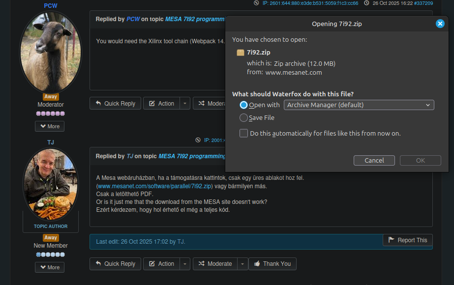

You would need the Xilinx tool chain (Webpack 14.7) for a 7I92, 7I92H, 7I92M

A Mesa webáruházban, ha a támogatásra kattintok, csak egy üres ablakot hoz fel.
(www.mesanet.com/software/parallel/7i92.zip) vagy bármilyen más.
Csak a letölthető PDF.
Or is it just me that the download from the MESA site doesn't work?
Ezért kérdezem, hogy hol érhető el még a teljes kód.

26 Oct 2025 16:09 - 26 Oct 2025 16:10 #337215
Replied by Aciera on topic MESA 7I92 programming

- Posts: 18093
- Thank you received: 5325
26 Oct 2025 16:43 #337220
Replied by PCW on topic MESA 7I92 programming
