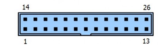

- TJ
- Posts: 13
29 Oct 2025 20:30 - 29 Oct 2025 20:52 #337405
by TJ
Replied by TJ on topic MESA 7I92 programming
1 port: IDC26 NORMAL LPT. PORT.
1-2-3-4-5-6-7-8-9 OUT.
10-11-12-13 IN
14 OUT
15 IN
16-17 OUT
18-19-20-21 GND
22-23-24-25 NON PIN
26 +5V
2 PORT: IDC BIDIRECTIONAL LPT. PORT.
1 OUT.
2-3-4-5-6-7-8-9-10-11-12-13. IN.
14 OUT.
15 IN.
16-17 OUT. (17 PIN charge pump Activate card outputs 10-16Khz)
18-19-20-21 GND
22-23-24-25 NON PIN
26 +5V
I need:
5 axis.
1 PWM
1 Encoder A-B-Z
+ Charge pumps 10-16KHz
10-11-12-13 IN
14 OUT
15 IN
16-17 OUT
18-19-20-21 GND
22-23-24-25 NON PIN
26 +5V
1 OUT.
14 OUT.
15 IN.
18-19-20-21 GND
22-23-24-25 NON PIN
26 +5V
I need:
5 axis.
1 PWM
1 Encoder A-B-Z
