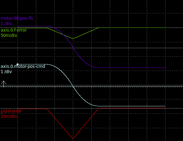

Today I was moving the machine with the MPG and found that if the step size was 0.010" it would stop the machine with a following error when I turned the handle.
I experimented with everything I can think of to try but couldn't get the problem to go away.
Some information.
The problem doesn't seem to happen when I use the jog button, only when I use the MPG
The problem doesn't seem to happen to the Y and Z axis, only the X axis.
The FERROR and MINFERROR are the same for all axis.
The P,I,D etc are similar on all axis.
One thing I wonder about is the X axis is the only axis that I adjusted the pots for, it seems to work OK otherwise, I don't know what else I can test to figure this out.
When I run the PID tuning I set the FERROR and MINFERROR very high so I don't know yet what would happen if I tried to run a real program yet.
12 Dec 2011 04:11 #15580 by PCW
Replied by PCW on topic Re:Mori MVJR Build Log
Can you set the FERROR a little bigger (say .1") and HALScope the X axis when you jog? (and post the results here)

12 Dec 2011 16:34 #15592 by schmidtmotorworks
Replied by schmidtmotorworks on topic Re:Mori MVJR Build Log
I did the test, I did it with with the MPG step set to 0.100" the table follows like it was being pulled with a rubber band.
The following message appeared:
"Unexpected real time delay"
Here is the HAL Scope screen capture and attached bootmsg.txt

12 Dec 2011 17:41 #15599 by PCW
Looks like FF1 is way way off.
This needs to be adjusted until the
FERROR triangle is flat
I wouls also delete the PID error trace as its a distraction
Is it possible the X axis drives gain pot was changed _after_ tuning?
