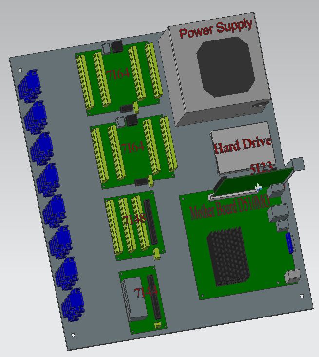

I have started an EMC2 build for a Mori Seiki MVJR.
The machine was built in 1986 with an MX2 Control.
I would like to start by thanking everyone that has contributed to the software and all the help that is provided here on this forum.
With my limited electronics experience but good documentation skills, I hope to give back by logging the steps of my build in a way that anyone can follow.
The attached image is a CAD model I made of the chassis, with mother board and Mesa cards and Honda connectors to fit the existing cable ends..
My goal at this point is to come as close as possible to bolting this control in and running it, (OK it's a fantasy)
The parts list so far is:
Mesa:
1 x 5i23
1x 7i48
2x 7i64
1x 7i44 RJ45
2x Custom cables (ask Mesa, the know what you need)
Intel Mother Board:
1X D510MO + 1gb memory
Hard Drive
32 GB solid state
Zumax Power Supply
ZU-400W ATX12V
If anyone needs the following let me know and I can post them:
Original Ladder diagram for the machine and control
CAD models of the parts (close enough for positioning and mounting
I'm nearing the point of pulling the existing control, if you have any advice, please post it.

01 Aug 2011 11:57 #12078 by BigJohnT
Replied by BigJohnT on topic Re:Mori MVJR Build Log
Is the 7i44 and 7i48 supported by EMC now?
Why use the 5i23 over the 5i20?
John

02 Aug 2011 05:47 #12120 by schmidtmotorworks
Replied by schmidtmotorworks on topic Re:Mori MVJR Build Log
John
My understanding is that 7I44 and 7I48 will be supported by 2.5.
My hardware choice was made drafting behind the research, advice and conclusions the were made on Corys MV35/40 thread.
I had Mesa review the list and they thought it was OK too.

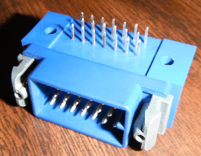

05 Aug 2011 06:02 - 05 Aug 2011 06:02 #12204 by schmidtmotorworks
Now that you mention those connectors, they have very small pins and I'm wondering how best to connect the wires to them?
Solder them directly?
Is there some kind of connector I can use?
Also, any good ideas about how to label the wires?
Last edit: 05 Aug 2011 06:02 by schmidtmotorworks.
05 Aug 2011 12:34 #12212 by clkeck1
Replied by clkeck1 on topic Re:Mori MVJR Build Log
cgi.ebay.com/ws/eBayISAPI.dll?ViewItem&i...geName=STRK:MEWNX:IT
I got these ones that have a loop to wire thru before you solder. I'm not sure how to handle the straighht pins.
