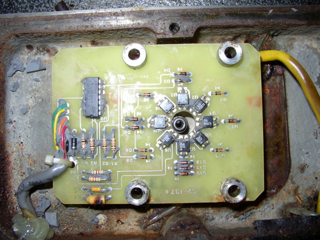

Thanks for the info on the turret encoder and for the offer to fix it. I might take you up on it if I can't figure it out LOL. I will peal the rubber off today and take a look see. How do you troubleshoot the parts? It was mighty wet in there when I took the cover off.
When I took the magnet off I noticed that there was not any key or any other means of lining up the magnet to any specific orientation. Is it just trial and error to get the magnet set so it will drop and lock at the right place?
Oh my and the turret comp is neat. Is it in 2.4? or did you add it locally? As many of these Hardinges that are out there it should be part of EMC I think if it is not all ready.
John

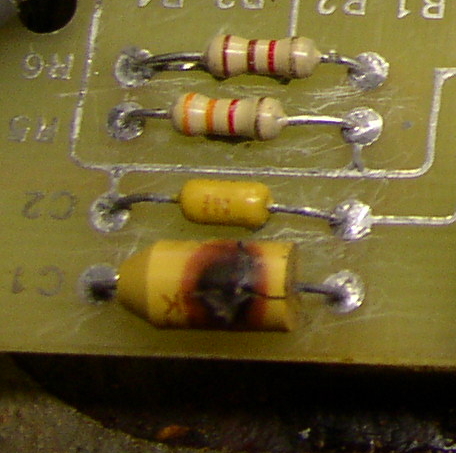

28 Feb 2010 14:40 #2115
Replied by PCW on topic Re:Hardinge CHNC 1 Lathe
Looks like a Tantalum bypass capacitor
old Tantalum bypass caps are quite prone to this (shorting out)

28 Feb 2010 15:26 #2117
It might have some info on the back, I'd clip the leads and see. What power supply does this run on?
Bypasses are not critical so if the power supply is known the capacitor size can be guessed

28 Feb 2010 15:48 #2118
by BigJohnT
Replied by BigJohnT on topic Re:Hardinge CHNC 1 Lathe
Hi Peter,
It runs on 24v.
It has the following on it
24V+
0.114 (2)
173+
The last line I can't read
John
It runs on 24v.
24V+
0.114 (2)
173+
John

28 Feb 2010 16:18 #2119
24V is strange (25 is a standard voltage rating and too low for 24V power)
Unless you can get the original specs I would tend to be cautious and use a 35V capacitor, maybe 2.2 uFor so
