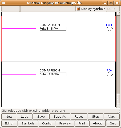

Here is the code used
I wonder if there is a way to do this all in HAL and not with the ladder?
John
# Feed Override
net fob1 wsum.0.bit.0.in <= hm2_5i20.0.gpio.062.in_not
net fob2 wsum.0.bit.1.in <= hm2_5i20.0.gpio.060.in_not
net fob4 wsum.0.bit.2.in <= hm2_5i20.0.gpio.058.in_not
net fob8 wsum.0.bit.3.in <= hm2_5i20.0.gpio.056.in_not
net increase-for halui.feed-override.increase <= classicladder.0.out-05
net decrease-for halui.feed-override.decrease <= classicladder.0.out-06
setp mult2.1.in0 10
net current-for-int mult2.1.in1 <= halui.feed-override.value
net conv-FO conv-float-s32.0.in mult2.1.out
net req-feed-int classicladder.0.s32in-03 <= wsum.0.sum
net curr-feed-int classicladder.0.s32in-04 <= conv-float-s32.0.out
The ladder used.I wonder if there is a way to do this all in HAL and not with the ladder?

Actually it is a bit slow and I'm going to replace the ladder with HAL comp when I get a few minutes to work on it.
John
