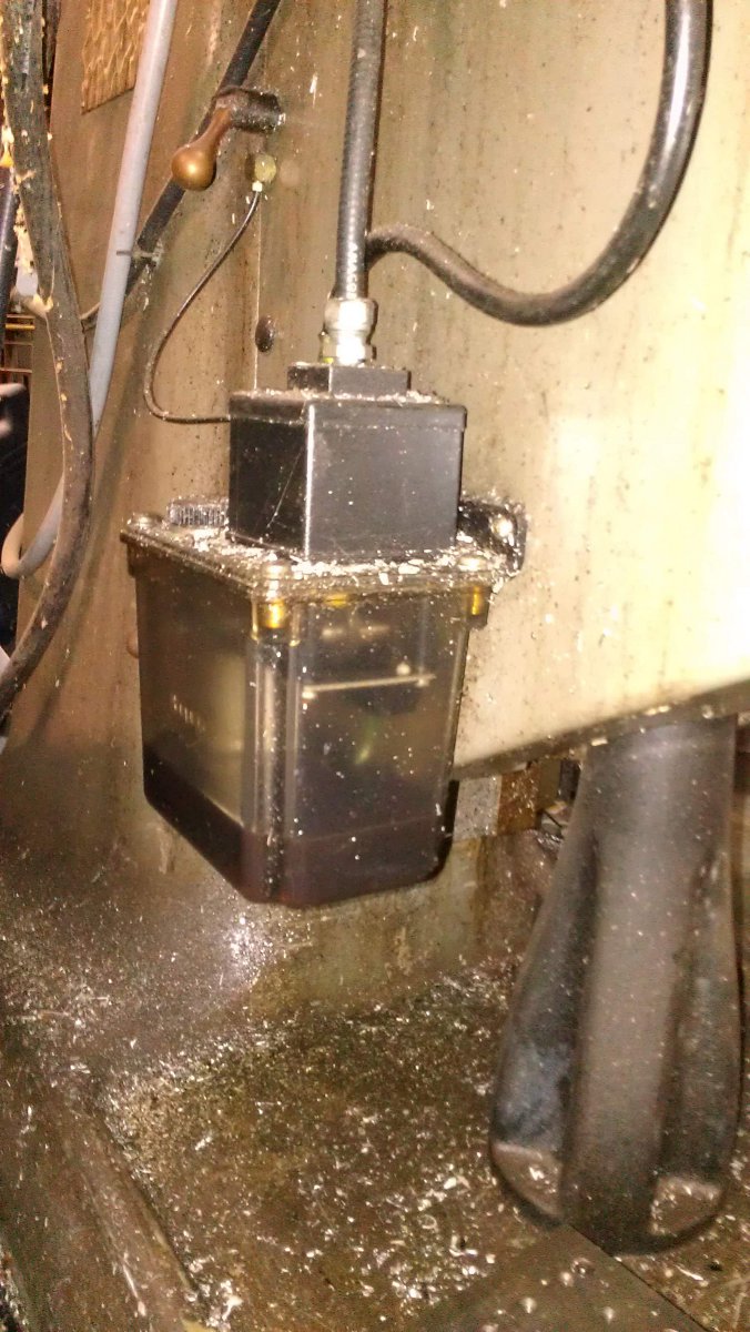

22 Mar 2012 04:45 - 22 Mar 2012 04:48 #18704
by drembedded
Replied by drembedded on topic Re:Bridgeport Series 1 Anilam GXM retrofit
John, heres a pictures of the oiler. I think the odd ticking sound is the oiler running. I left eh mill powered up for a couple of days and notices there was oil on the ways which wasn't there before.
I've also attached a recording of the sound and it sure does sound like a clock mechanism.
What do you think?
What do you think?

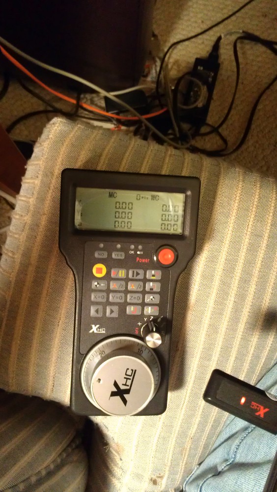

03 Apr 2012 05:53 #18941
by drembedded
- cncbasher

03 Apr 2012 07:40 #18942
by cncbasher
Replied by cncbasher on topic Re:Bridgeport Series 1 Anilam GXM retrofit
what information comes with the pendant ? any linux driver source or is it just meant as i understand for use with mach3 and it's plugin dll
reason i ask is , i'm interested but cannot find any further information .
- drembedded
- Posts: 48
03 Apr 2012 14:29 #18945
by drembedded
There isn't much that comes with it but I really wasn't expecting. anything anyways. I spoke with one vendor but that discussion was very unsatisfying. They said it works with Mach and thats it, no docs whatsoever.
I spent some time on Mach's support forum but that was of little help.
So having worked with usb devices before I decided to go ahead and purchase a unit. From past experiences have shown that usb manufacturers will take the path of least effort when developing drivers.
So last night when it arrived, I plugged it into my windoze box and was pleasantly surprised when it enumerated as a hid device, yeah!

03 Apr 2012 14:33 #18946
by drembedded
Without documentation Im going to have capture usb packets going to/from the device.
Next I installed usbsnoopy (from sourceforge) on windoze and captured the packets sent from the device when I pressed each button, turned the axis selection knob and turned the axis movement knob. Pretty straight forward. packet values.
Next I need to install Mach and then capture the packets sent to the device which updates the screen.
Then the last part is to figure out how integrate what I learn into LinuxCNC. This last part is where I will need some help as I'm new to LINUXCNC.

07 Apr 2012 17:09 - 07 Apr 2012 19:37 #19020
by drembedded
Made some progress this week. I'm able to read all the key clicks, the axis selection switch and the dial. But writing to the LCD has posed a problem, not sure what the issue.
Regarding integration with LinuxCNC... since I'm still a relative newb, what would be the best way to inject the key clicks into LinxuxCNC as well as what information do we need to write to the LCD?
Also, I'd like to post some videos showing my success so far. If I attach an AVI file to a post will it "run" in this page? Or is it better to post a link to youtube?
