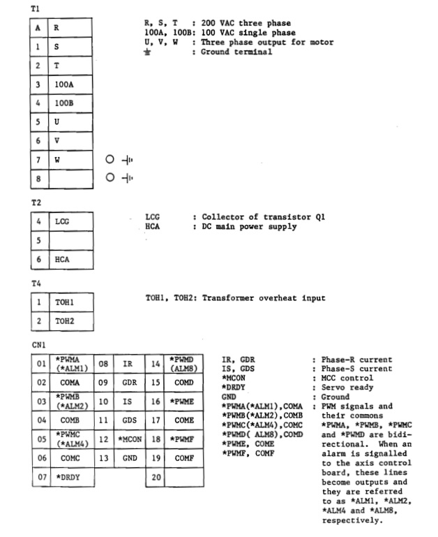

I'm in a similar boat and am hoping that there has been some resolution that hasn't been posted?
My Hardware:
1-Axis 200V S-Series Servo Amplifier
The NC Controller to Amplifier Interface (GND & COMx ignored):
I'm guessing:
Cheers!
My Hardware:
- Module #: A06B-6058-H006
- Lower Board: A20B-1003-0080/04A
- Front Board: A20B-1003-0090/02/7B
- A06B-0502-B005#7008
- PWMA (ALM1)
- PWMB (ALM2)
- PWMC (ALM4)
- PWMD (ALM8)
- PWME
- PWMF
- IR
- GDR
- IS
- GDS
- MCDN
- DRDY
I'm guessing:
- DRDY is Drive Ready
- MCDN is an Enable signal
- IR/GDR and IS/GDS are RS-422 pairs similar to all the other PWMs (COMx's aren't listed). But that still doesn't tell me what IR/IS are for?
- IR and IS are Read and Send signals (It doesn't make sense that there would be two lines for this).
- The PWMs are for a Delta (or possibly Wye) half-bridge configuration and represent each gate-set's individual control.
- When IR is high, PWM's A-D become outputs which can be used for state feedback.
- Information on interfacing with these digital amplifiers.
- Insight into the appropriate LinuxCNC configs to generate the appropriate control waveforms. (I have a MESA 5i20 for starters)
Cheers!

- sivaraj
- Posts: 50
- Thank you received: 25
31 Aug 2012 01:04 - 31 Aug 2012 01:23 #23785
by sivaraj
Replied by sivaraj on topic Re:Fanuc servo drive integration
PWMA / PWMB ,PWMC/PWMD,PWME/PWMF are Three phase sinusoidal PWM
IR /GDR , - R-Phase motor current
IS/GDS - S-Phase motor current
This Fanuc amplifier a three phase bridge with motor phase current feedback will block the PWM if any fault with power section like over current/under voltage
It should be easy to implement with Mesa
Hope this helps
Sivaraj
Hope this helps
Sivaraj
Last edit: 31 Aug 2012 01:23 by sivaraj. Reason: mail was not complete
- gr0kr
- Posts: 2
31 Aug 2012 16:48 #23805
by gr0kr
Replied by gr0kr on topic Re:Fanuc servo drive integration
Thanks Sivaraj!
sivaraj wrote:
What is the relationship between PWM A & B (same with C/D, E/F)? Are they the High/Low control lines for half-bridges?
Any idea on the protocol for accessing the Alarm codes (ALM1,2,4,8)?
- Posts: 18111
- Thank you received: 5330
31 Aug 2012 17:05 - 31 Aug 2012 17:06 #23807
Replied by PCW on topic Re:Fanuc servo drive integration
The alarm bits are just a 4 bit code(codes are listed in one of the controller manuals), This would require tri-stateable differential drivers on those PWM pins (and knowing when to change dir: DRDY?)
Last edit: 31 Aug 2012 17:06 by PCW.
- sivaraj
- Posts: 50
01 Sep 2012 00:21 #23816
by sivaraj
Yes 6-PWMs signals for 6 transistors on the 3phase bridge.
I worked on this about a year back .So If I remember right,the alarm signals are just multiplexed digital signals.No other protocal involved.

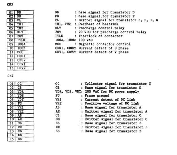

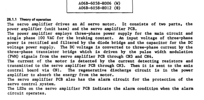

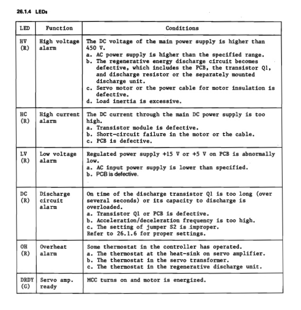

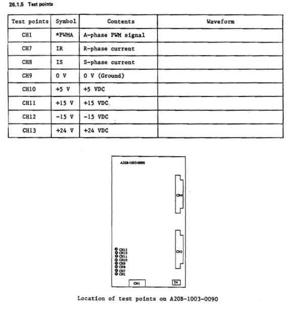

- MANOLOMARAVILLAS
- Posts: 6
03 Nov 2015 02:01 #64632
by MANOLOMARAVILLAS
Replied by MANOLOMARAVILLAS on topic Fanuc servo drive integration
hello i am again. s700 have a Fanuc robot, buy blcd picosystem converters. I also have these drivers.
and according to my research are these,,,,,
I share all my data,
image valid for::
a06b-6058-h221
a06b-6058-h222
a06b-6058-h012
a06b-6058-h006
image valid for::
a06b-6058-h221
a06b-6058-h222
a06b-6058-h012
a06b-6058-h006
- MANOLOMARAVILLAS
- Posts: 6
03 Nov 2015 02:07 #64636
by MANOLOMARAVILLAS
pwm a .....pwmf is pwm control 6 trifasic mosfets...
drdy- servo ready
mcon:mcc , activated relay power 200va in mosfets control.(voltaje power start )
ir and is,,,,,, sending to control amp power windings motor....
drdy- servo ready
