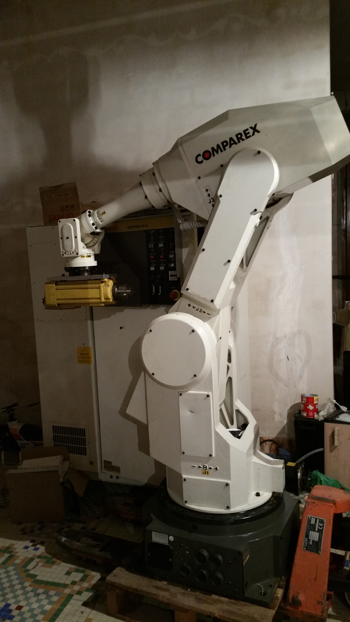

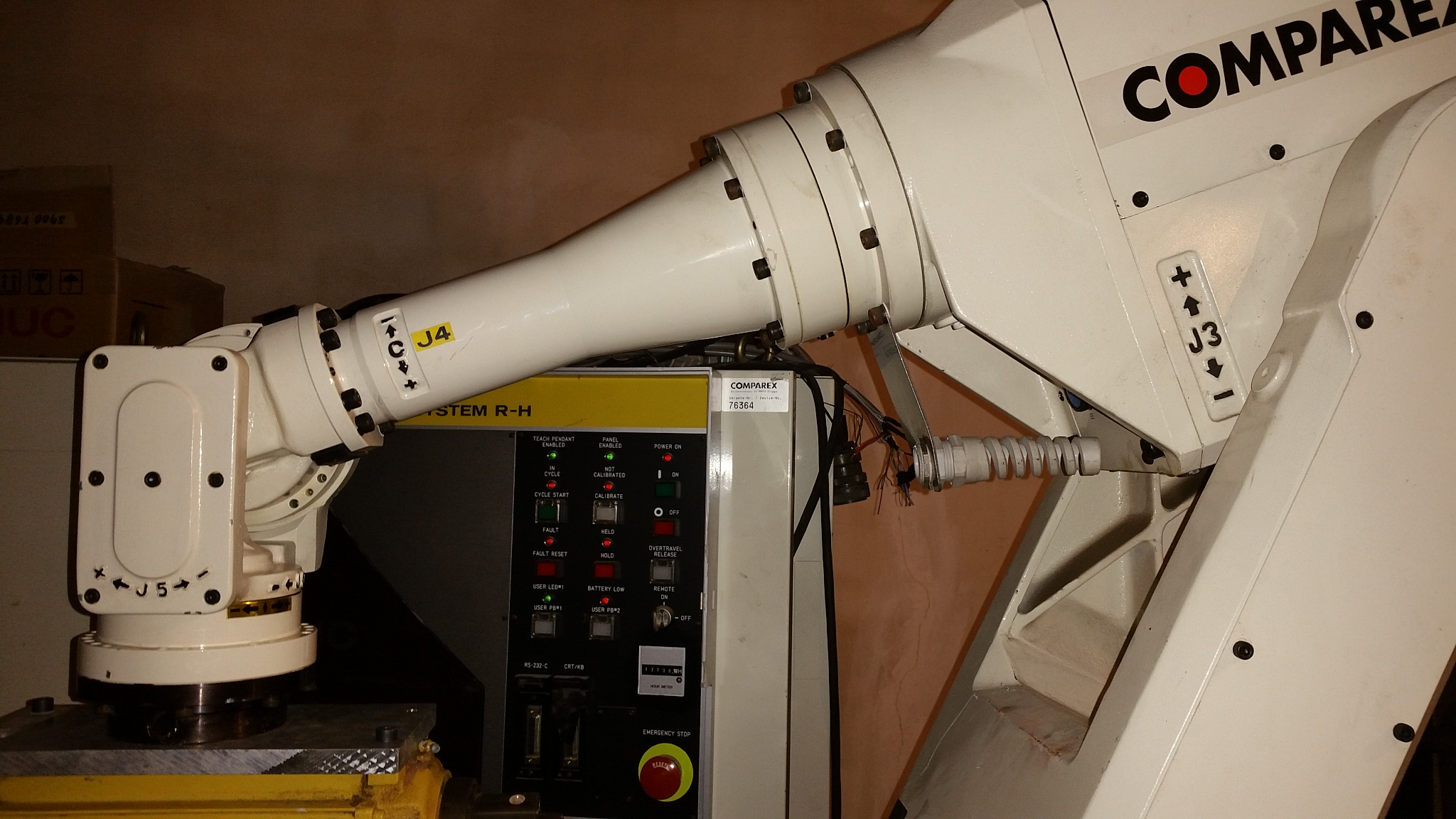

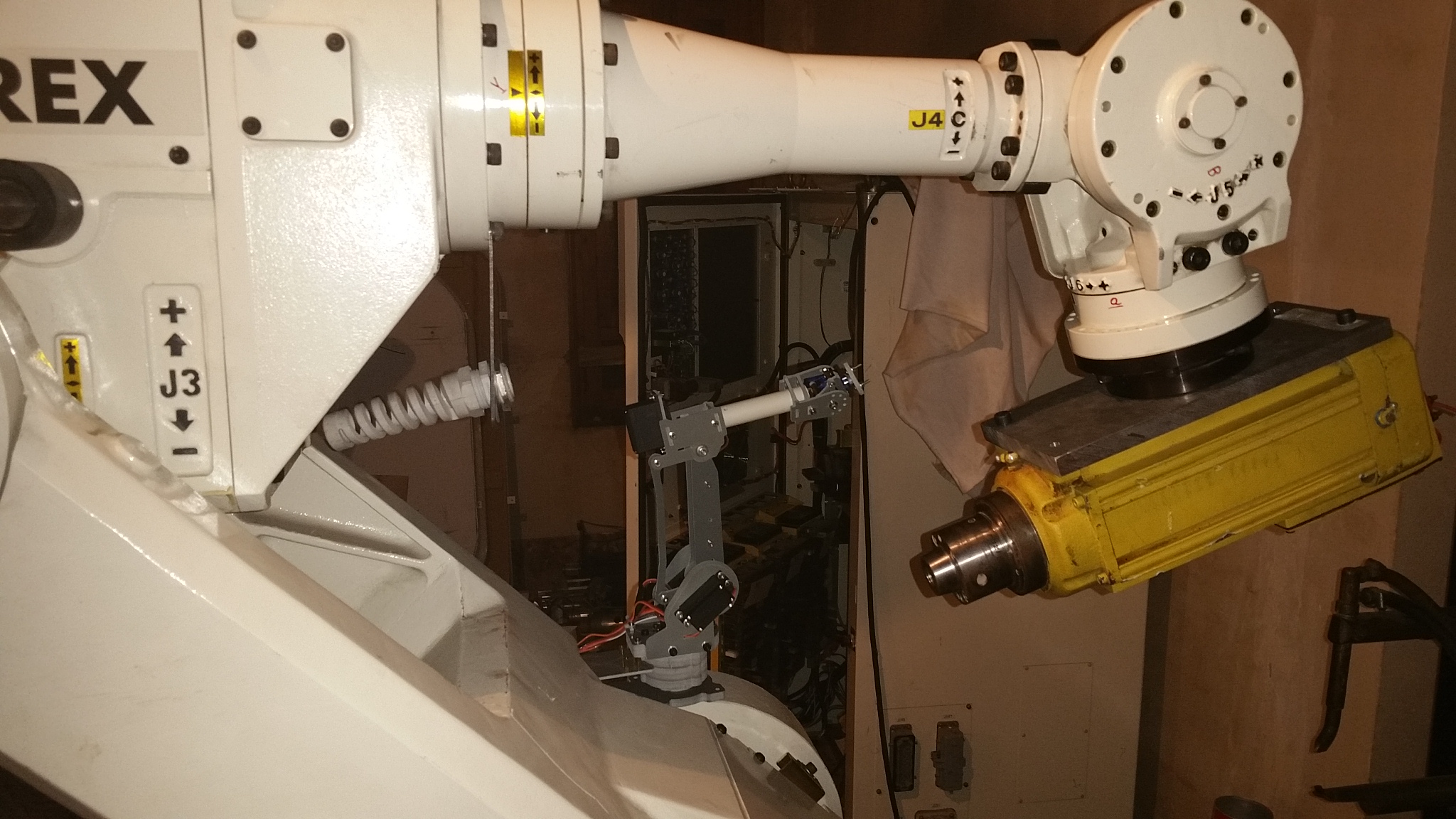

20 Mar 2017 01:20 #89917 by MANOLOMARAVILLAS
Replied by MANOLOMARAVILLAS on topic Fanuc servo drive integration
So are you telling me that you have a interface card which can connect to the Fanuc servo drives?
No, I have converters that connect to the Fanuc encoders (both types) and convert their signals so they can be used by industry-compatible servo amplifiers and controllers.
So, you could use our Fanuc encoder converters and our PWM controller, and either our brushless PWM servo amps, or units from AMC. I think those would be the BD##A##, where the ## indicate the voltage and current ranges. I think AMC has obsoleted these models, but they are often available on eBay,
Another choice would be our Fanuc encoder converters and our PPMC analog servo interface, with some analog-input brushless servo amps. The Fanuc converters would provide the commutation signals to the servo amps, and the PPMC would receive position from the encoder converters and send analog commands to the servo amps.
Jon
I probe jnelson's converters.
Functional in normal driver drivers, get to test a Chinese control of 20 eur. Only for control check with blcd sensors. I put the video.
Also provide other blcd 80v drivers running mach3 press address.
Everything controls 4 perfect axes. The problem is in axis 5, 6 are fat engines that neither jnelson has enough power in its drivers,
My thinking is this:
Leadshine has some controls that I have 6 units ,,,, acs806 these control my small robot engines perfectly and fast ,,, but for the big has no power ,,, I am electronic, and thought this driver has a detector of consumption of The motor coils. I would need to fool it with load resistors. To remove 6 wires from its legs mosfets firing gate and attack a monoblock transistor ke724502 ​​... we talk about attacking this module capable of operating almost 600v and a potency more than superior ,,, or even with the outputs of pwm Of acs806 attacking a fanuc unit pwm1 pwm1 pwm3 pwm3 pwm4 pwm5 pwm6.
I am willing to try, although I left the original stage burned ,,, lose by losing the river with it.

11 May 2017 01:12 #93002 by MANOLOMARAVILLAS
Por fin e conseguido controlar el motor con control indramat tdm

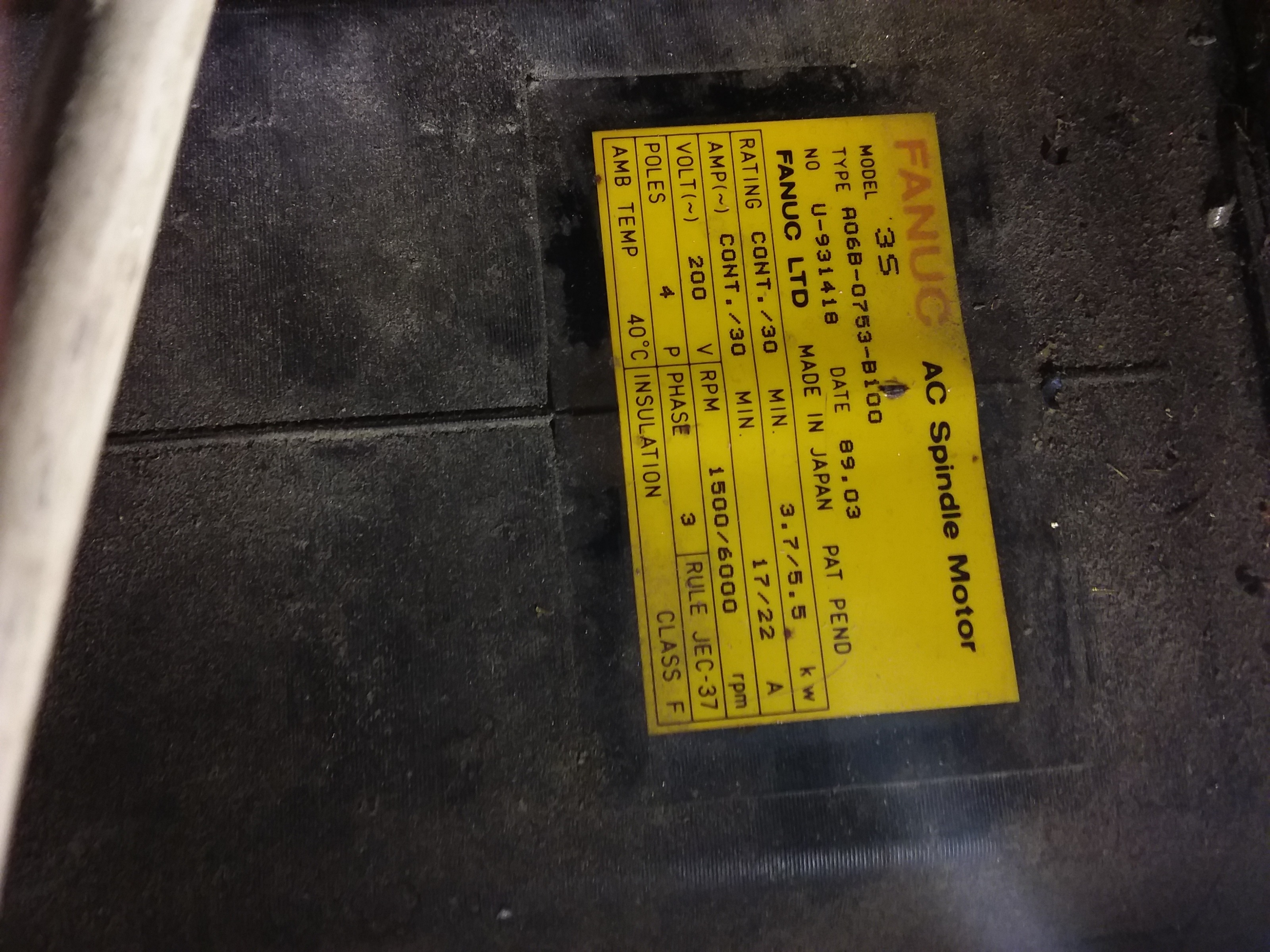

12 Dec 2018 06:53 - 12 Dec 2018 08:17 #122246 by jefsaro
Replied by jefsaro on topic Fanuc servo drive integration
hello ,
I use linuxcnc for 10 years already, I retrofit my fanuc omate t milling machine with stepper motor and a kress spindle, I used the parallel port.
I buy a kit mesa 5i25 7i76 to make a new retrofit, I still have the original parts of the machine.
I would like to put the spindle , I have a motor spindle 3s following photo, I read that it could be connected to a vfd, is possible?
I also did a gear cutter and a mortiser with linuxcnc.
my job is traditional machining and cnc, I work on mazak and I had a milling machine cincinnati dart 750.
I make parts for old vehicles.
Thanks for your help .
sorry for english
have a good day
Last edit: 12 Dec 2018 08:17 by jefsaro. Reason: fanuc spindle
