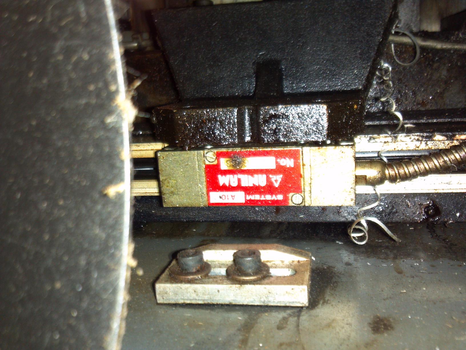

Looks like I have Anilam A10's, which as far as I can tell are 10 micron (.0004"), but can't find the type yet.
I did find the following pin-out, which might display my ignorance as the type might be obvious from this.

Pretty sure most Anilam are quadrature square wave output. I'm 99% sure the A10 is.
It may or may not support a index too. What color is the name plate on the encoder ?

Chris, the nameplate is red (see pic).

Ahh yes the red one. This is definitely square wave TTL output. I have some of these. I just can't remember the resolution.
IIRC the color is a clue of the resolution (red orange and green I have)
While TTL output means it's easy to connect to, it also means you can't improve the resolution - aside from replacing them.
Chris M
