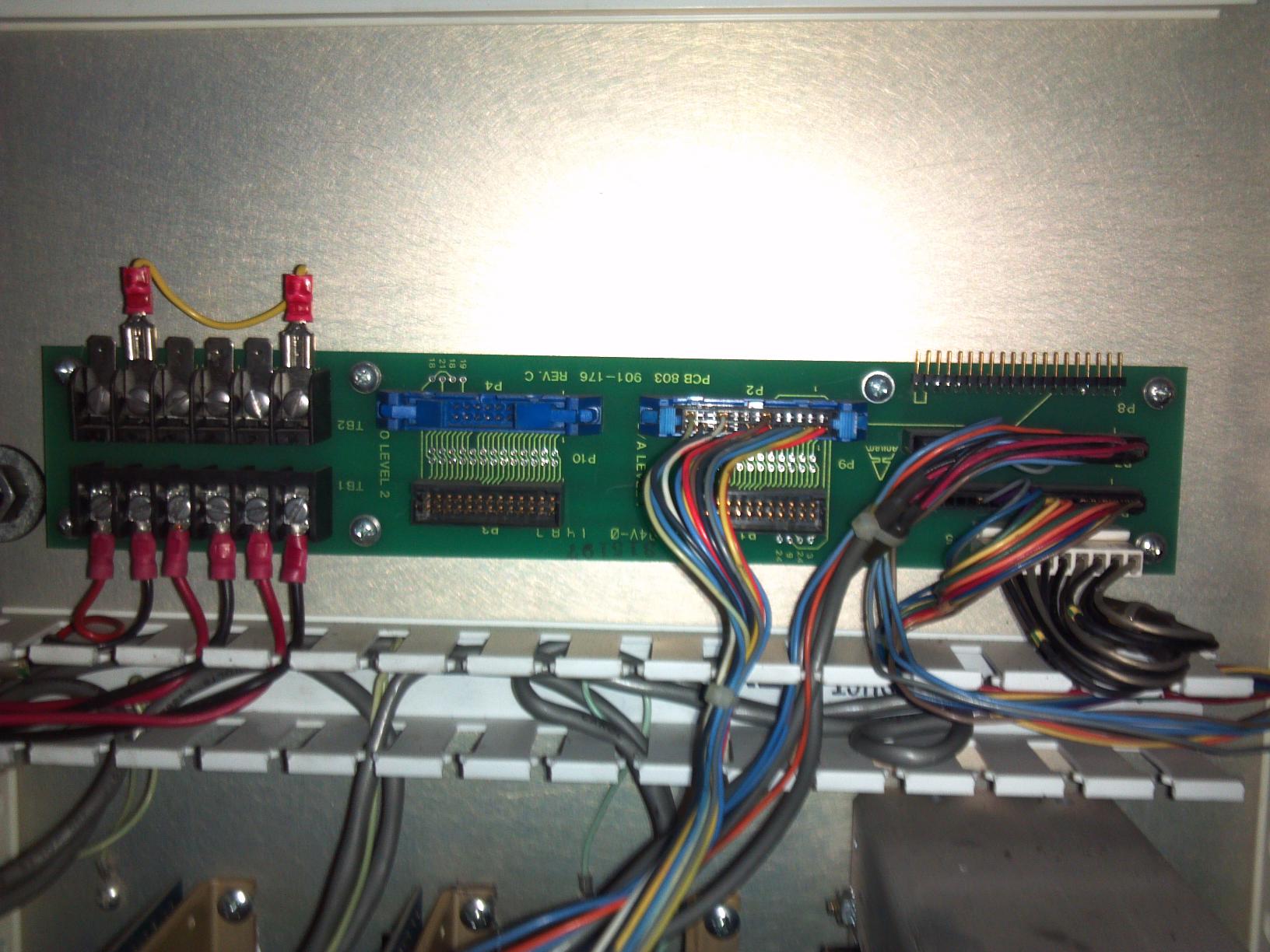

Next, I plan to confirm that all limit switches are still present in the circuit, and test the x and y axis as well. Finally, I plan to generate a reference signal and attempt to move all axis.
My goal during this upgrade will be to use all existing hardware. It appears that no-one has successfully done this, but I don't know why this shouldn't be possible. Anilam had a functional control after all. From reading other posts, my understanding is that drives get a tach feedback, and the motion controller gets (relatively low resolution) position feedback from "glass scales". I know of one successful Anilam to EMC via PPMC, although he had to add rotary encoders. I would like to avoid this, or at least understand why my current set-up won't work.
I am open to various motion control options at this point, my preference would go to whatever can drive my current hardware most efficiently for a reasonable cost.
Update on Progress:
- Confirmed function of all limit switches (single switch per axis--activated by dual fixed cams...one on each end of travel of the axis)...Done. E-stop will not reset if limit switch is tripped, system will e-stop if limit is reached while running.

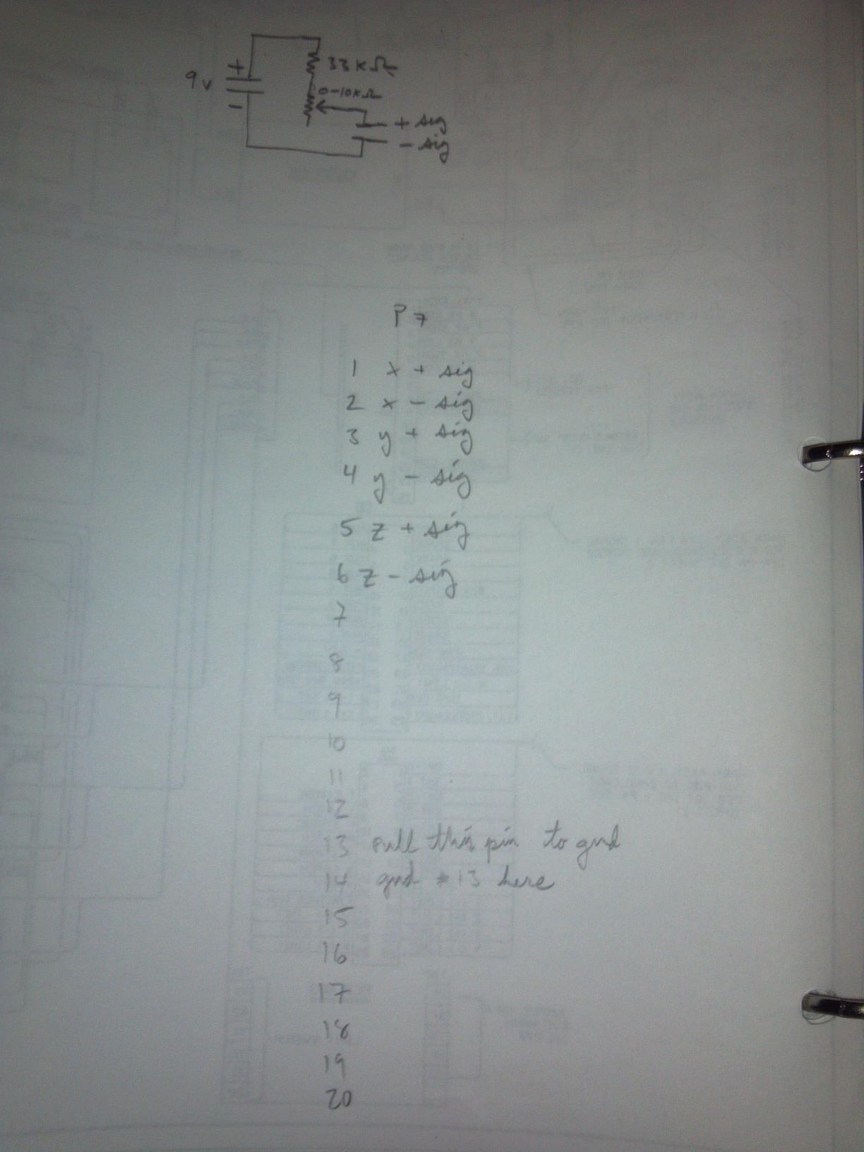

- There is a spare terminal (P8) on the Anilam PCB 803 (see pic). If you bring pin 13 to gnd (pin14), the servos will enable upon e-stop reset. I wired in a momentary switch to this terminal so that I could keep my finger on a "deadman switch" while testing.
- Confirmed power up of all drives...done. There is no drift to the z axis, but some small very slow drift to the x and y.
- wired a 9V battery (see pic) to provide a 0 to ~3 V signal into the drives. To do this, I used pins 1-6 of the same terminal (P8) of PCB 803. I also needed to pull the connector from the Anilam control board that was outputting voltage. (PCB 502) Confirmed that I can drive both directions and stop. Done. Interesting that I can get rid of the small drift on x and y by applying a small control voltage. (seems like a good sign). I confirmed that positive voltage to the red wires give positive axis movement (from tool reference)
- checked tachs by measuring voltage across wires. I was surprised that this worked with the power off. I attempted to crank the axis as fast as I could, but I imagine that this is not as fast as they used to move when the controller worked. I measured about 5V max on the x and y, but saw up to 10V on the Z. The Z appears to have much more reduction, so I believe I could get the motor spinning faster with the mechanical advantage that I could use on that axiz. I am concerned that a 0-10V analog input is not a large enough range. I would not be surprised if the tach's output 0-15V like the signal input to the drives. If no 0-15V input is available, I will likely have to step down the voltage to make use of what is available. There is no convienent way to get this signal out as the tach's go directly into the drive. I needed to stick probe wires into the back of the connector to measure. TODO: confirm that the drive wasn't affecting this signal, unplug the connector and test again.
- I was surprised to see that with the axis moving in a positive direction (from tool reference) the tach sent a negative voltage.

10 Jan 2013 23:47 #28551 by andypugh
Replied by andypugh on topic Convert from Anilam Crusader M to EMC 2
You probably need bipolar reading A to D to sense the two directions. the 7i87 is safe to 100V so it might well not matter if the speed input tops-out during fast moves. The suggestion to use the tachs is purely to aid tuning at very slow movement rates.
Normally the PID loop calculates its rate of change by differentiating encoder position counts, which for a relatively coarse feedback system like your glass scale may be rather noisy.
Wiring the tach signals to the pid.N.feedback-deriv pins gives the PID controller a much less noisy and more accurate velocity input.
Note that the inut to this pin is only used for the D-term of the PID, so you will not see any benefit from it with no Dgain.
Whether $99 for the 7i87 is worth the investment is a choice you need to make, but I think it should really help to reduce dither between scale counts.
Other conversions have tended to add encoders to the motors, but this is probably even more expensive.
I think that the encoder conversion bases P and D on the motor encoder and I on the scales.
The proposal here would be to base P and I on the scales and D on the tach/7i87.
But I am aware that I am performing a thought experiment with your money here.
This is a non-issue and can be solved in HAL.
It is probably deliberate, the driver scheme is probably very simple, where the command voltage and tach voltage are summed, amplified and sent direct to the motors.
