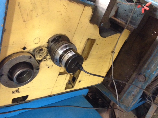

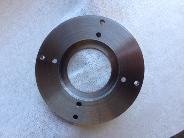

19 Apr 2015 05:56 - 19 Apr 2015 05:57 #57883 by canner
Replied by canner on topic H.E.S. 24NCS Lathe (24 X 60) conversion
So I built the adapter to mount the encoder to the lathe, this is my first time posting pics so I hope this works as intended.
