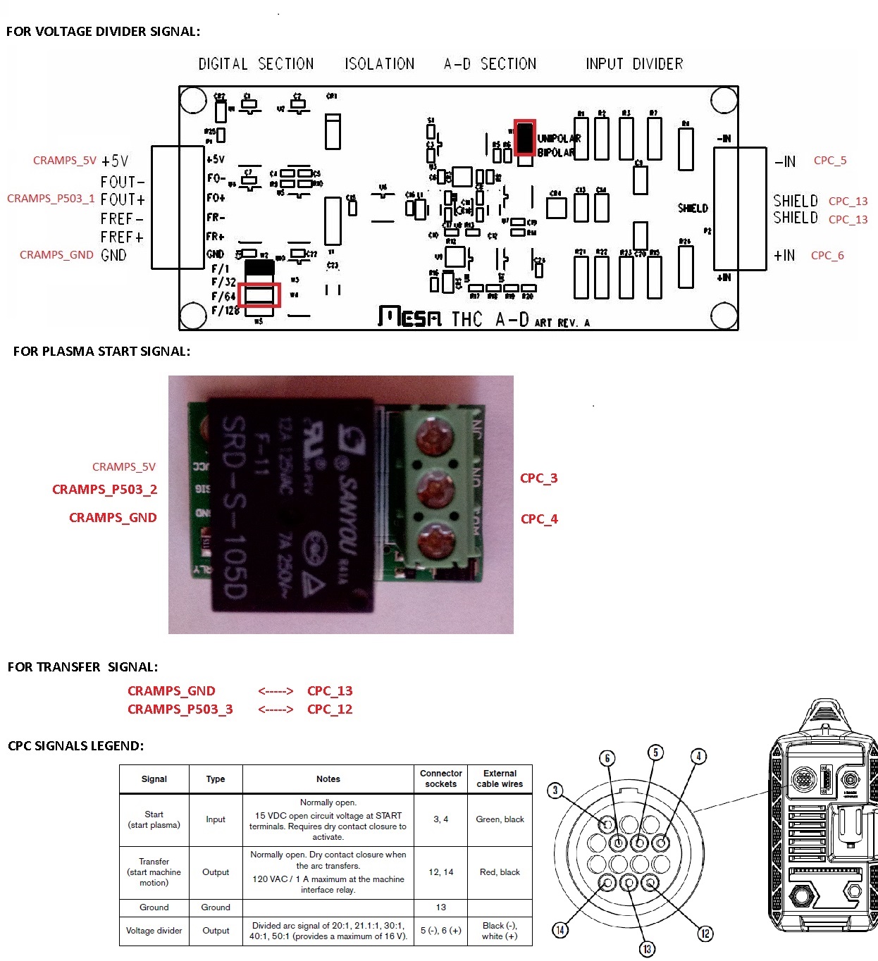

I am in doubt how to wire Hypertherm Powermax45 xp plasma with CPC port, so I decided to post picture with connections here.
I hope some experts could correct me.
The main problem seems to be for me that voltage levels are not clearly stated in manual and I do not want to ruin some board with two high voltage. They ention dry contact in manual - so actually I have difficulty to know should I use relay or not - or how connection should be made.
The controller that should trigger or read signals from CPC port is BeagleBone black that runs linuxcnc - actually it is equiped with CRAMPS hat that is 5V level compatible (reprap.org/wiki/CRAMPS).
On picture below you will see that for:
1) thc voltage I use mesa thcad 10V card
2) for plasma start signal I use 5V relay
3) for transfer signal - I plan to directly connect THC signal to cramps signal - this is the point that worries me most, but I am not sure will in case of transfer plasma box pull this line to gnd and when signal is not triggered it will be left floating so it will be pulled to 5V on cramps board side?
Is my wiring OK ?
I hope picture could let you know how do I plan to connect it and I am opened to suggestions and/or corrections.

Hola
zhivko, no entendi bien tu grafico, pero por lo que el traductor me dice entiendo que tienes dificultades con el arcok.
Los pines 3 y 4 considero que los conectaste bien, esos debes unirlos cuando quieres prender el plasma.
Los pines 12 y 14 son los de arcok, es un rele NO que se encuentra incluido en su plasma y se cerrara cuando su hypertherm logre producir el arco de corte, esa signal la recibe su placa controladora y la transmite al linuxcnc. Hay un Gcode que espera esta signal para continual con el programa.
