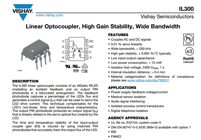

OK maybe I am asking silly questions, but as 12 and 14 are contacted in relay - this 12-14 connection must be on some voltage level?
This is all I asking - the voltage of 12-14 contact - I was not able to see or find any information on posts around internet about stating voltage level
In manual they mention 120V - 1A, but seems to me quite weird to have such big voltage for interfacing - and if this is correct - I would need some translation device? Maybe this "Isolated Linear Sensing IC":
www.avagotech.com/products/optocouplers/...amplifiers/hcpl-7520
or this one:
www.vishay.com/docs/83622/il300.pdf
So to illustrate a bit - if 12 -14 are contacted in plasma torch relay - on what voltage level are then this 12 - 14 line? If it is above 5V I think I will have problem on my linuxcnc computer - this are my worries - and if this connection is higher than 5V what kind of device I need to translate it to 5V?
Sorry for asking so many times - but this is me beeing (maybe too) carefull - I would not like to burn some electronics this is reason I am asking this.
