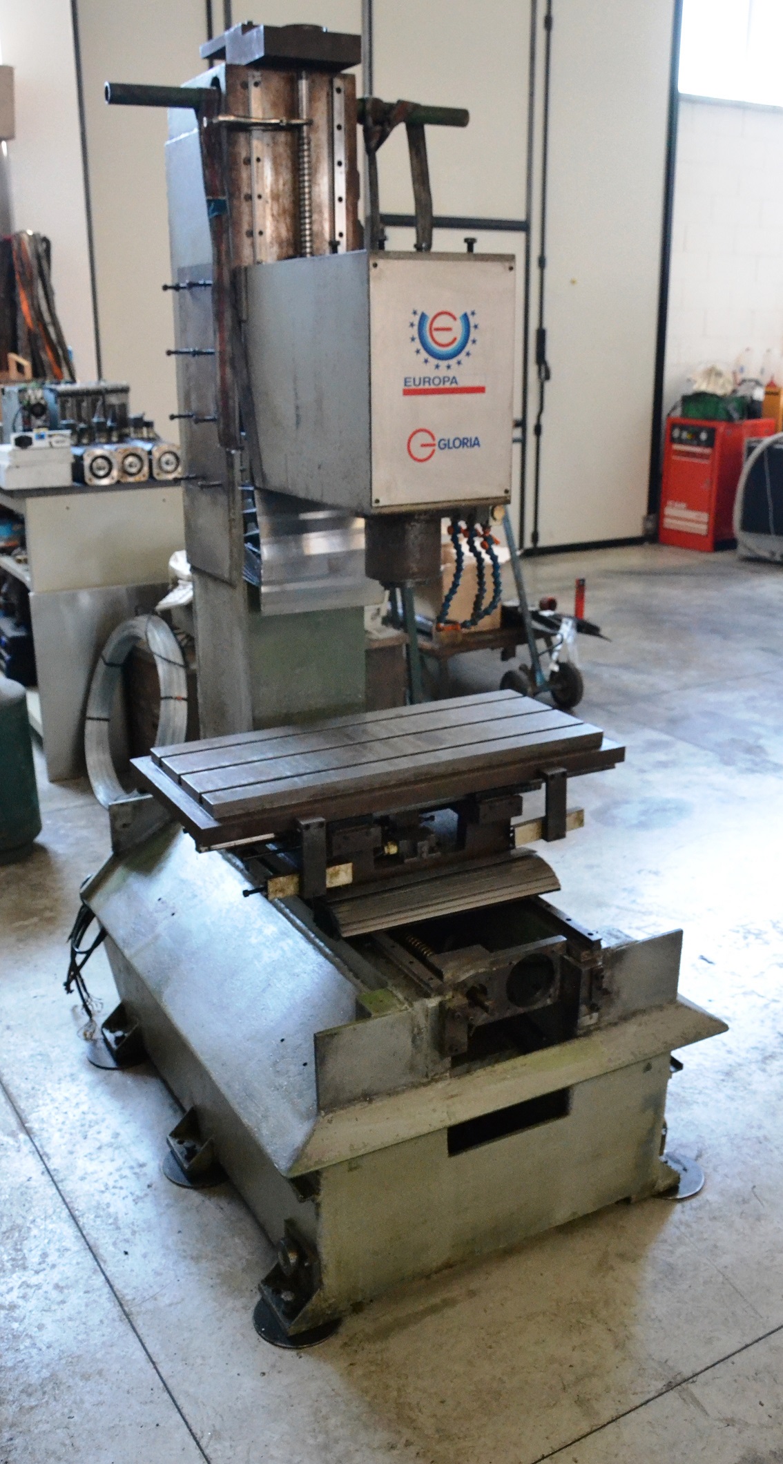

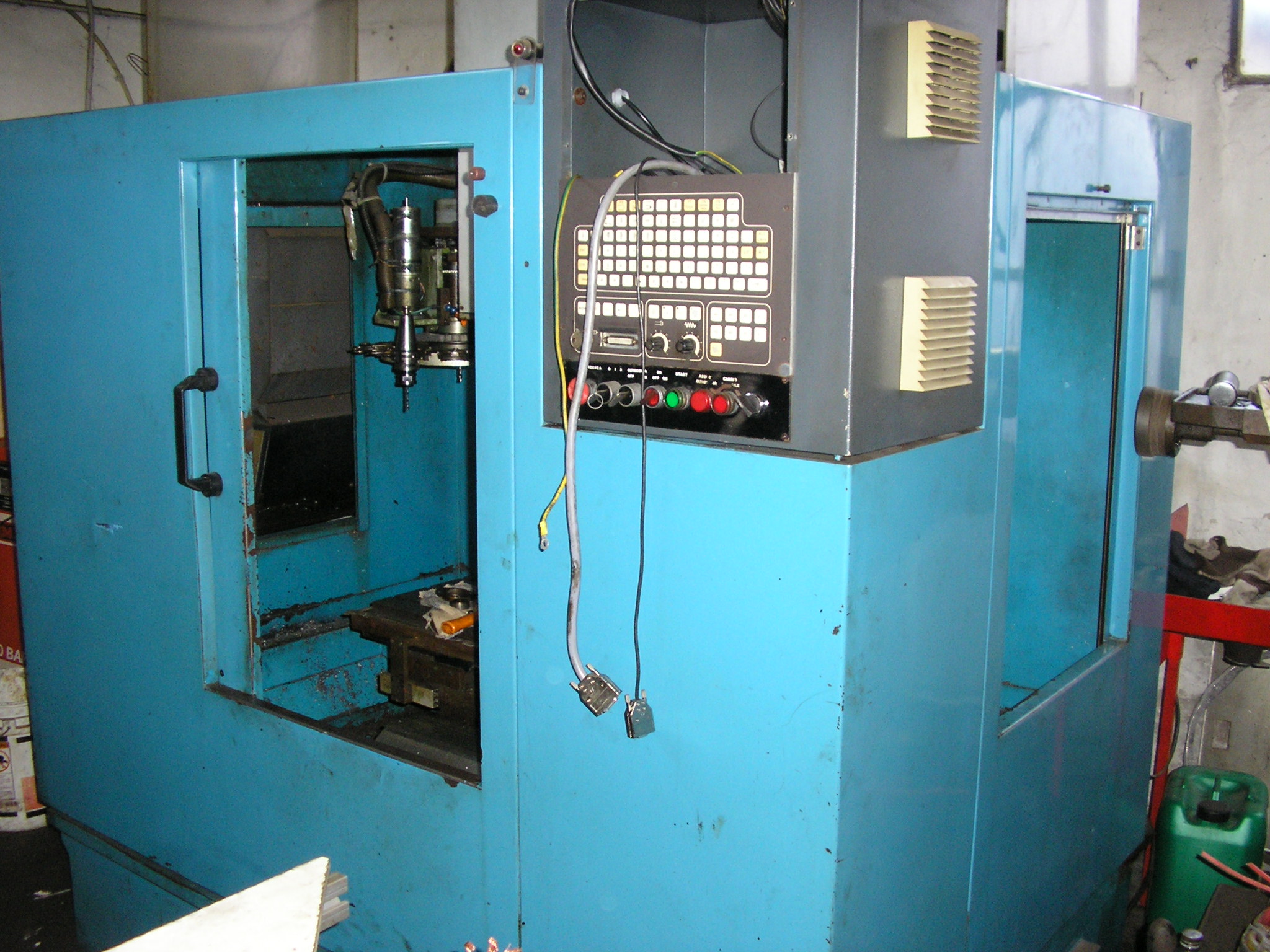

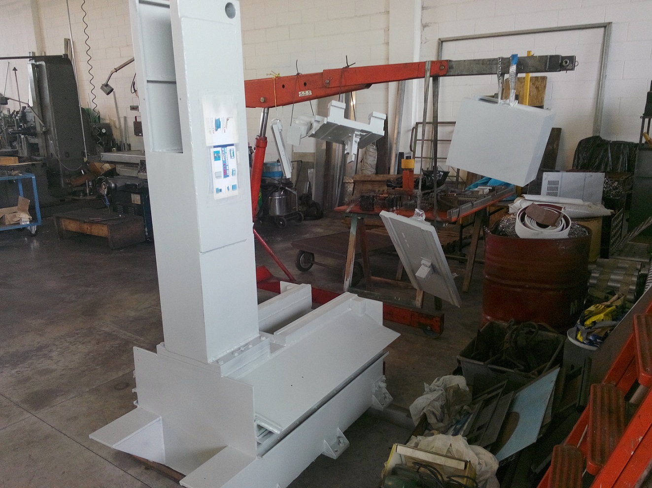

Hi, this is my first post on the forum, although I follow you and use LinuxCNC for the past four years on a small 3-axis milling machine with much satisfaction.
In our workshop we have an old 3-axis CNC machining center (Gloria Europa 2/40), unfortunately the control unit has failed so we decided to proceed with a retrofit and some improvements (fourth axis, tool changer improved, and more). Honestly we took to get carried away, in fact we almost rebuilt the machine from scratch, including painting :whistle: .
Anyway I decided to use LinuxCNC to control the machine and, after collecting all the requirements, I started to look for the right combination of hardware for our needs. We have the electronics for driving the motors, spindle and tool changer, now I'm looking for the right combination of Mesa cards to control the machine.
We have to manage 4-axis step-dir with encoders, 1 VFD 0-10V with encoder, an MPG + some physical buttons on the console
some general purpose I/O (coolant, home and limit switch, etc. etc.)
The solution I found for now is to use one 7i76E for step-dir, spindle and generic I/O, one 7i85s for encoders and one 7i73 for MPG and console.
It may be a correct choice? Or are there other possibilities?
Some "work in progress" photos ...
