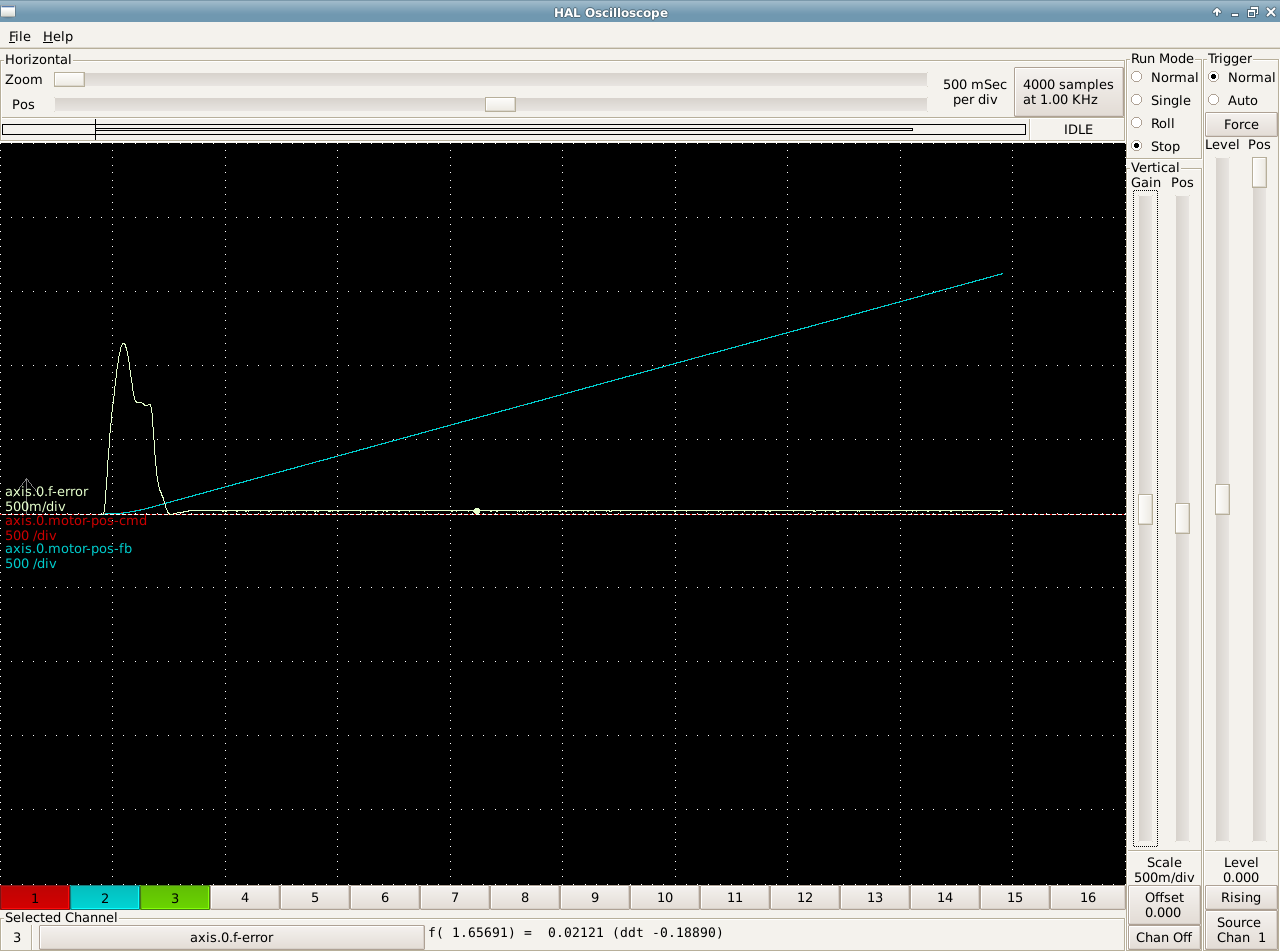

04 Jul 2016 12:00 - 04 Jul 2016 12:03 #76976
by backtime
Replied by backtime on topic Retrofit Gloria Europa 2/40 machining centre
Ok, withthings are much better
Now i have P=50 and error is stable at 0.02 at high speed, I will make a few tries with other PID parameters,
but this is a great value.
The only problem is a peak at the beginning of the acceleration ramp (ferror raise to 1/1.1), i have taken a screenshot of halscope and saved halscope data file. Pins in halshow are: motor-pos-cmd, motor-pos-fb and ferror.
if you have suggestions let me know.
p.s. the command "Open data file" in halscope is greyed out, saved data cannot be loaded?
setp pid.x.maxerror 0Now i have P=50 and error is stable at 0.02 at high speed, I will make a few tries with other PID parameters,

04 Jul 2016 12:18 - 04 Jul 2016 12:41 #76977
Replied by PCW on topic Retrofit Gloria Europa 2/40 machining centre
I suspect your drives cannot accelerate as fast as requested probably because
your INI file velocity and acceleration settings are too high for a mill
(500 mm/sec is possible on a fast router but scary fast for a mill)
Last edit: 04 Jul 2016 12:41 by PCW.

05 Jul 2016 03:48 #77014
by backtime
It can be, but the data of speed and acceleration are provided by the manufacturer and are the result of simulations carried out by the manufacturer considering the masses involved.
This is the simulation for the X axis
Anyway I will try to decrease the values of acceleration and maximum speed up to eliminate the peak.
Thanks for answers.
Thanks for answers.

05 Jul 2016 04:20 #77017
Replied by andypugh on topic Retrofit Gloria Europa 2/40 machining centre
Do you have any FF1 term in the PID? There is a pin to connect the velocity command from HAL to make that work better.
axis.N.joint-vel-cmd => pid.N.command-deriv
You are showing a 1mm out-of-position error at the star of a rapid. This will be top limit for the off-of-path error, which will typically be rather smaller. (ie, the tool will be behind the commanded position, but often fairly close to the path despite this)
You might find that the error reduces rapidly with lower accel limits.
