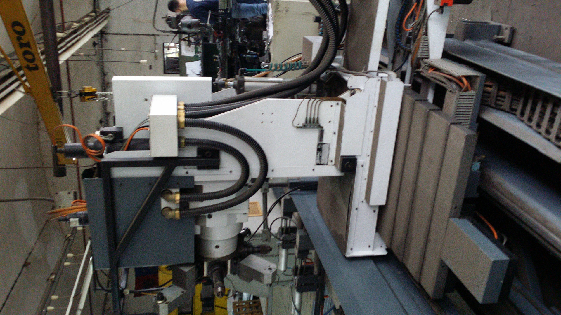

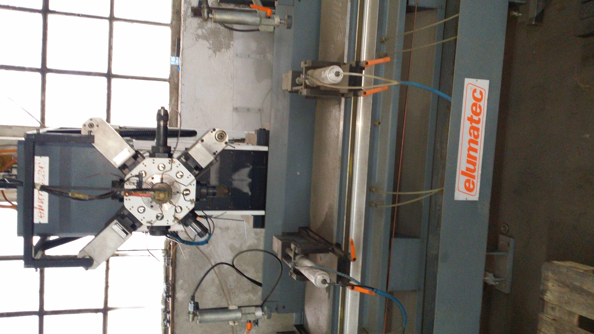

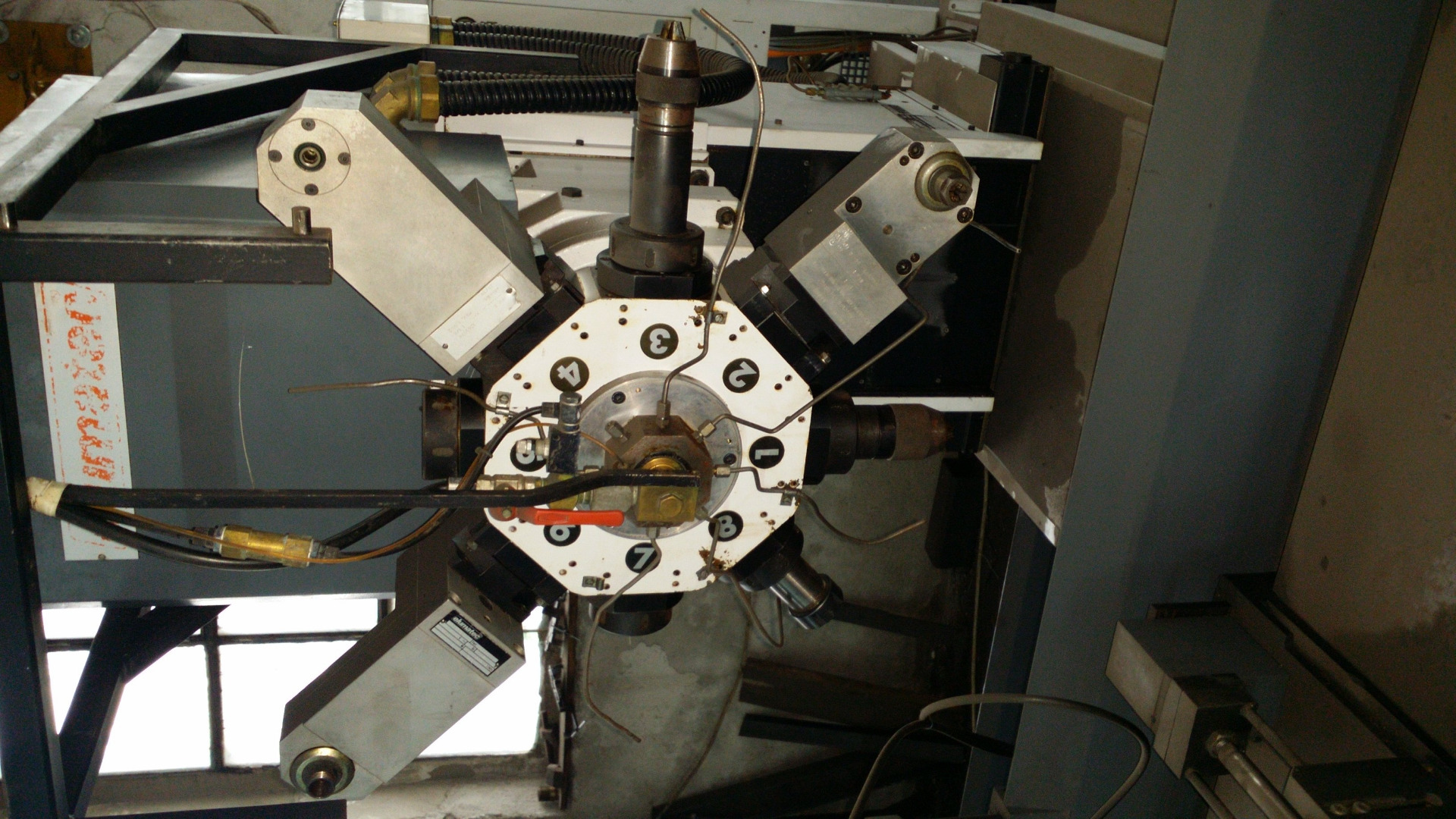

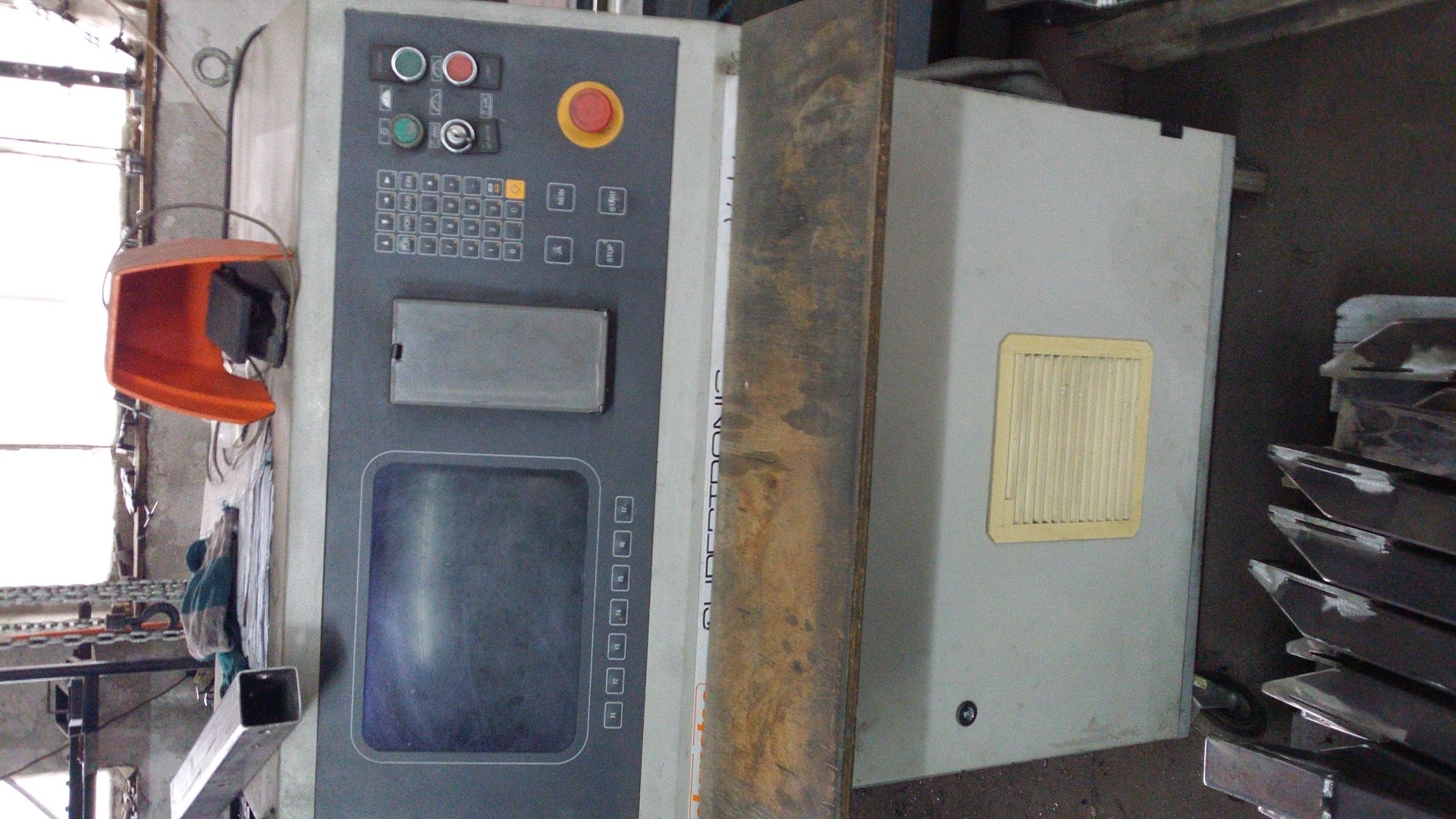

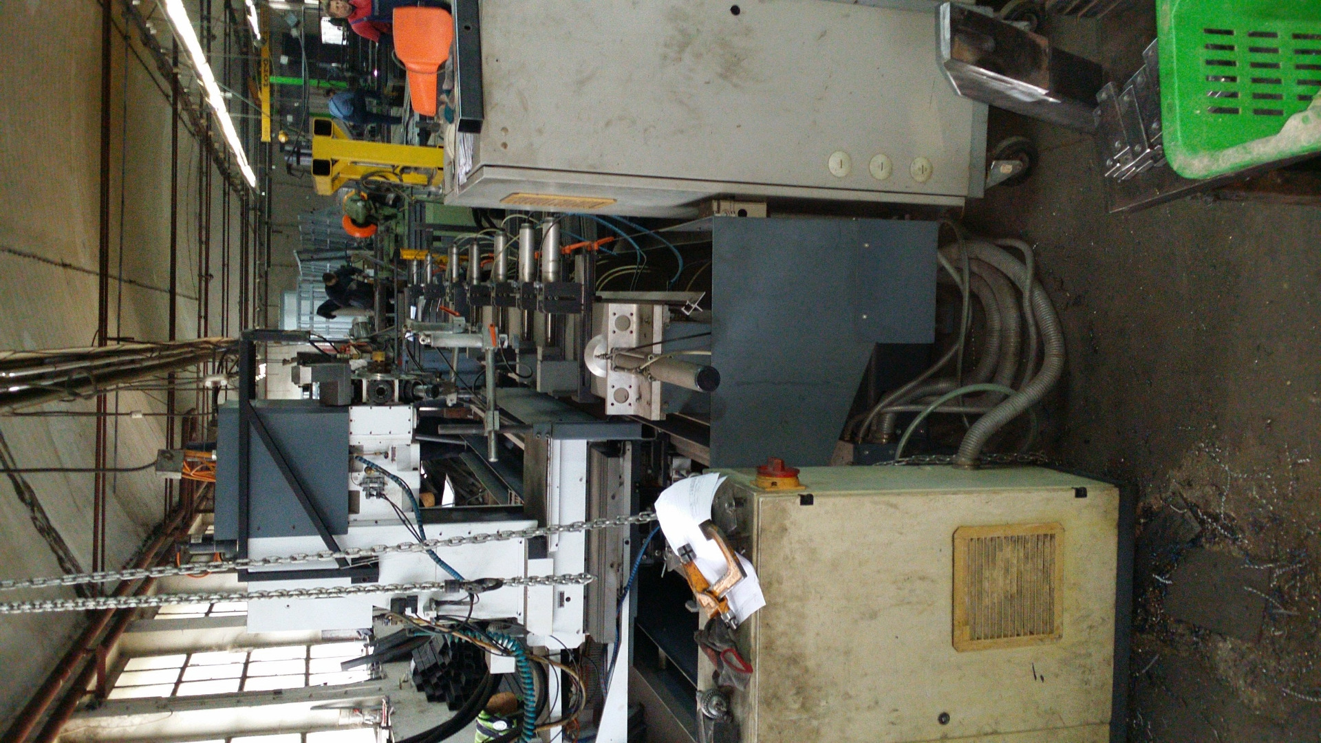

06 Nov 2016 13:10 #82508
Replied by tommylight on topic Elumatec SBZ 130/01 retrofit
Here are some pictures of the machine, it is over 7 meters long and weighs in at 5 tons.
