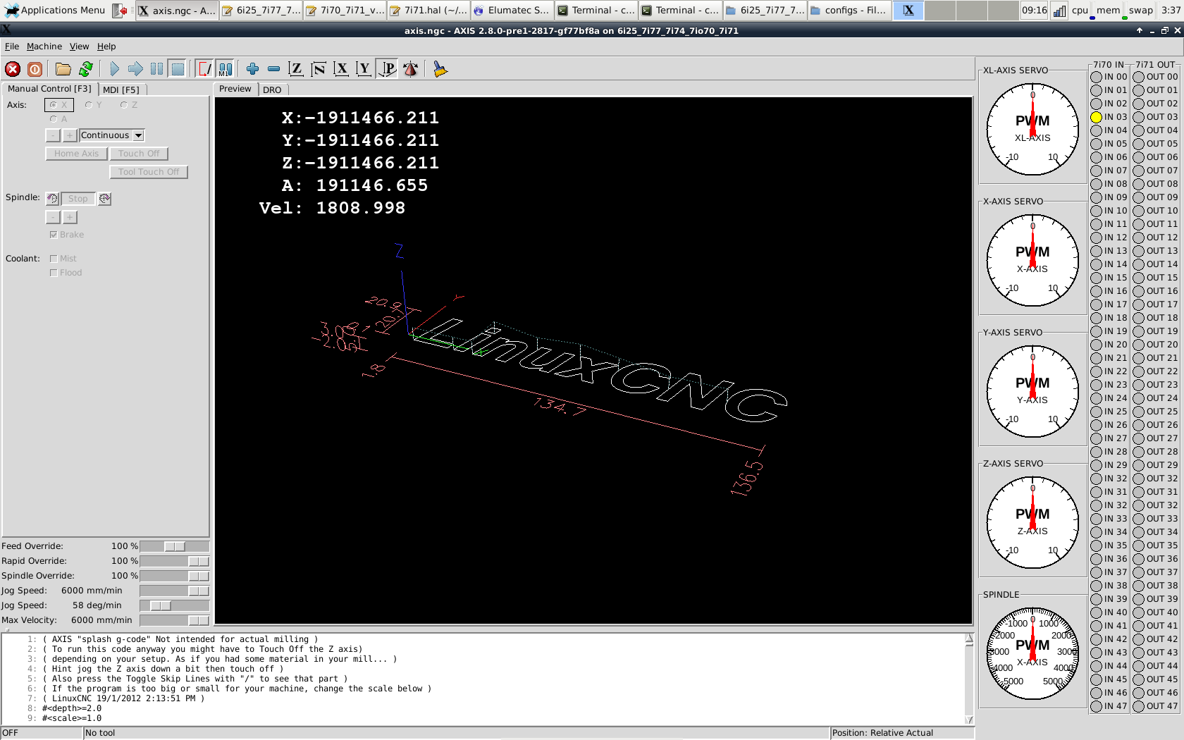

Spent some 2 hours making this pyvcp panel to check the inputs and outputs and analog outs and spindle. I do not have to bend over to check anymore.
Might be helpful to others who are using 7i77 7i70 7i71.
Regards,
Tom

30 Jan 2017 01:49 #86938 by tommylight
Replied by tommylight on topic Elumatec SBZ 130/01 retrofit
It's been a loong day, got a lot done, so here is a recap:
3 main axis all set and tuned, working properly stoping at 0.000 always,
Long X axis moving and tuned, needs a bit more tuning, brakes working, the one on the motor as well as the air clamp/brake
Spindle working perfectly, but i will have to add a ddt to get the velocity feedback
Played with flipflop's and got the pneumatic clamping working from computer and machine panel, have to add 2 foot pedals
Got the tool changer to move and cycle through tools, not programed yet, have to add a clutch, a brake and inputs for tool possition
Cleaned up the wiring , switched to another smaller computer and fited it inside the cabinet,
To do:
How to set up long X axis and short X axis to act and be seen by gcode as a single axis????? Tod sugested using sum, so will have to figure that out,
Still not clear how to set up carousel for tool changer, namely it has a clutch and a brake, could not figure out how to implement that in hal.
Regards,
Tom
Will attach some pictures of the aftermath tomorrow.
