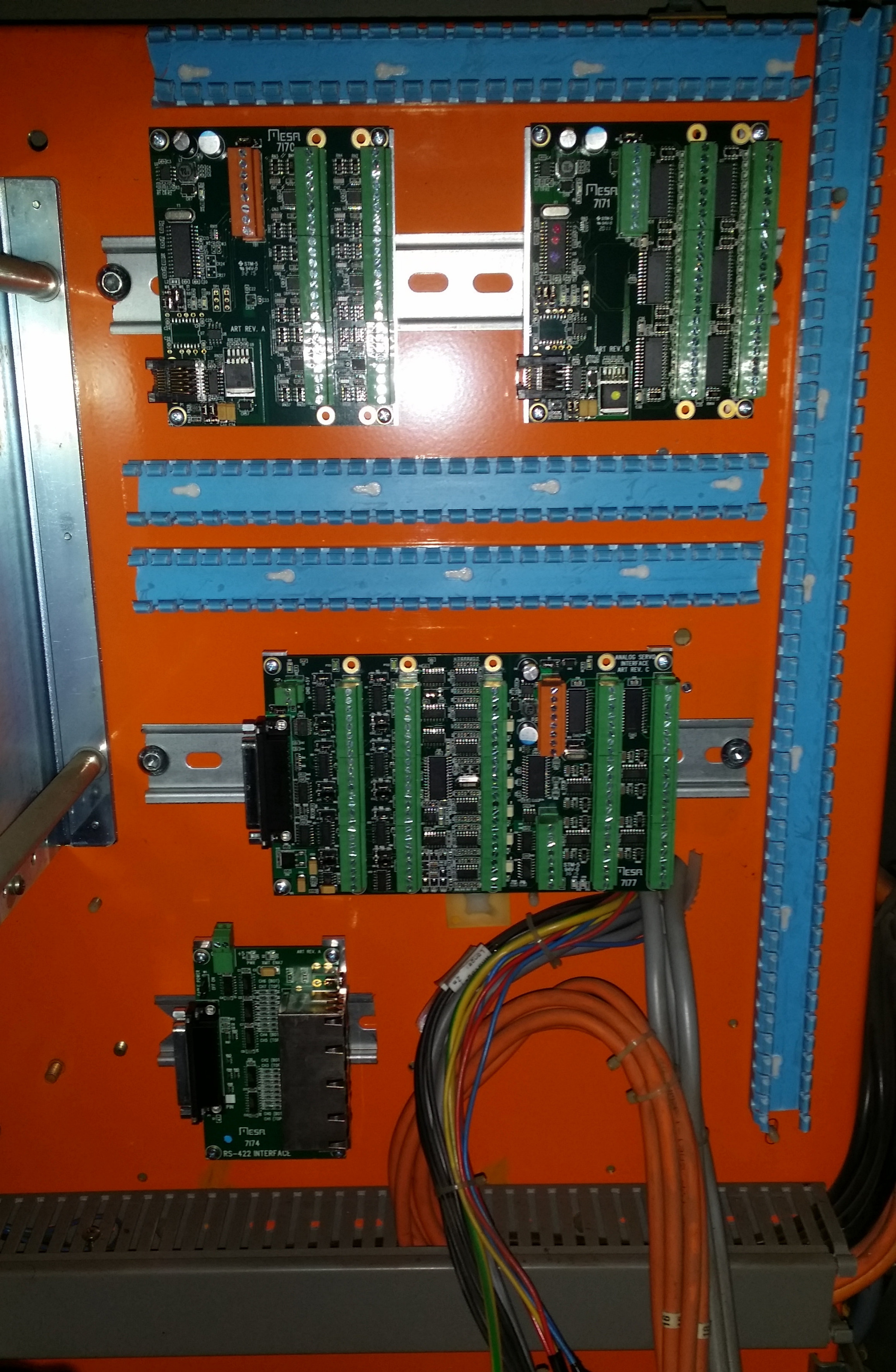

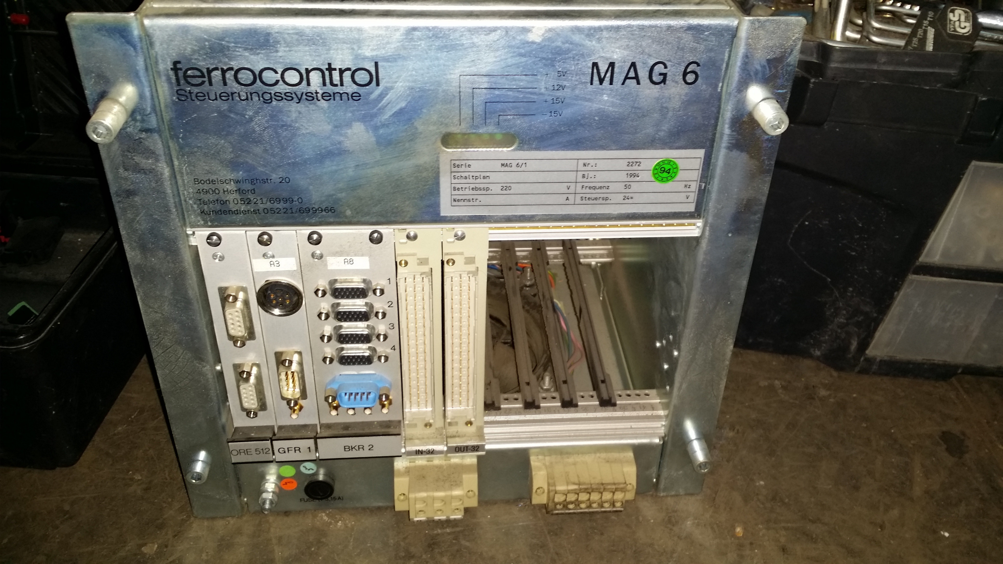

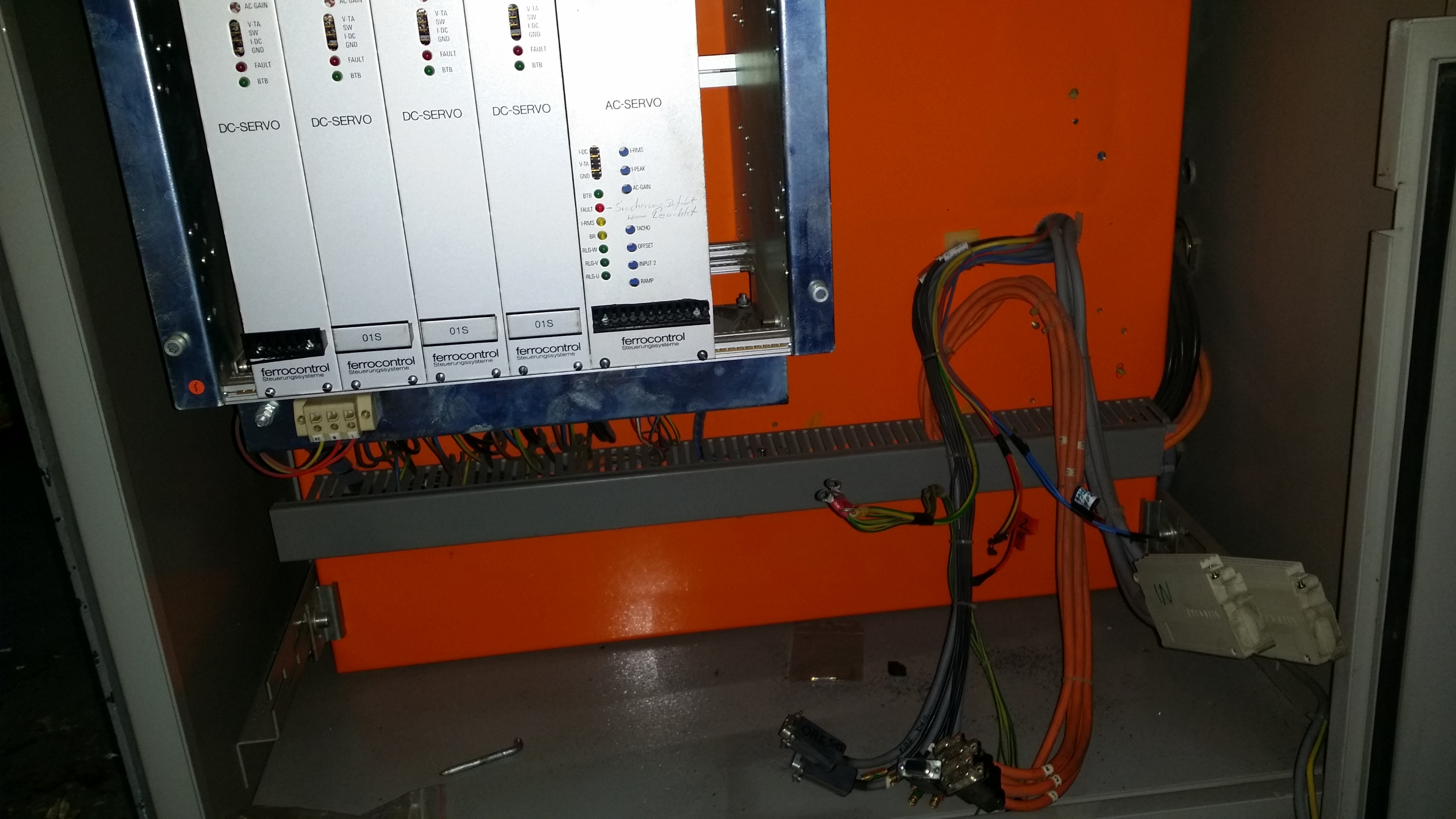

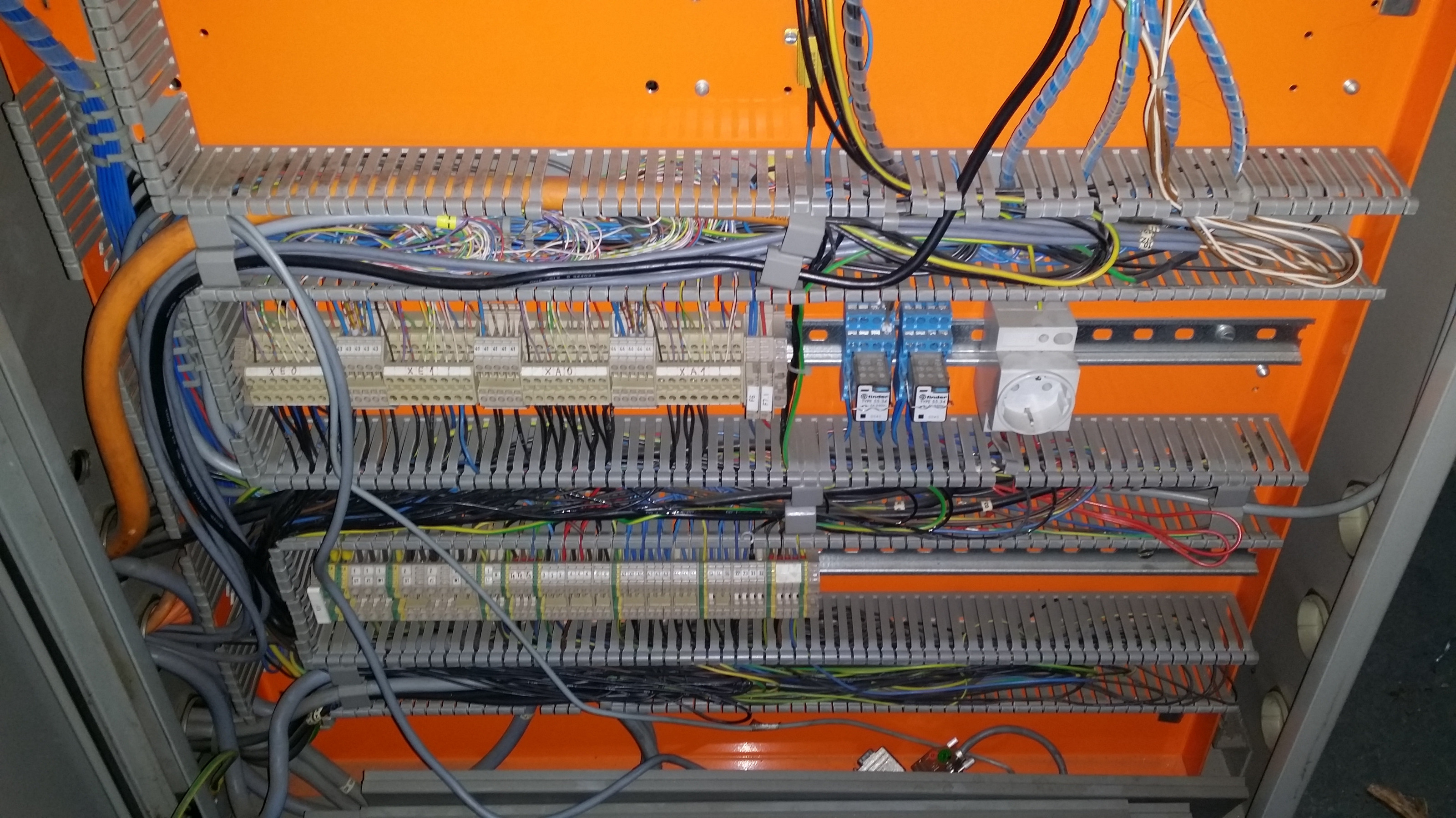

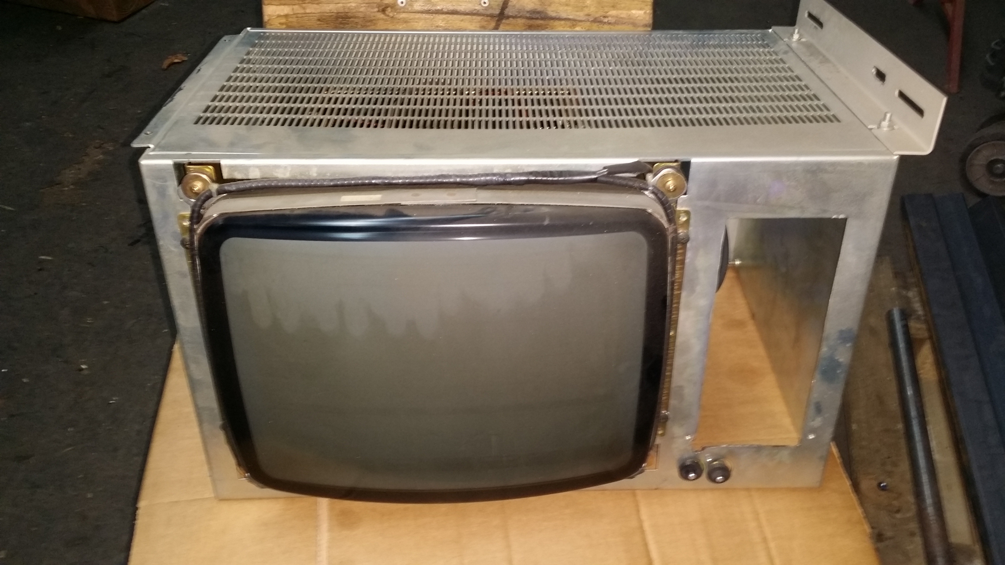

Finally started working on this machine, got rid of the old controls and computer and mounted the Mesa cards. Getting familiar with all the inner workings as much as possible on a non functioning machine, and planing everything humanly possible upfront, so here is a short burst of info:
-motors have brakes, tacho and serial absolute encoders
-long axis has a separate absolute encoder with separate rack and pinion, brake on the motor and pneumatic brake on the rails, had separate control
-spindle looks like having 1to1 ratio on tool 1 so good for rigid tapping, can not check other tools for now
-tool changer has another brake and a clutch inside
-a lot of pneumatic valves, relays, end switches, pressure sensors, clamps etc

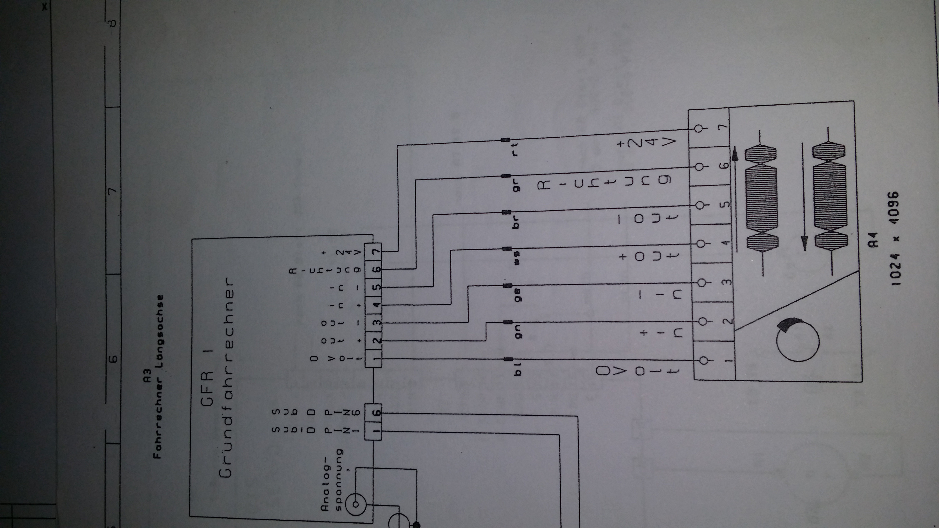

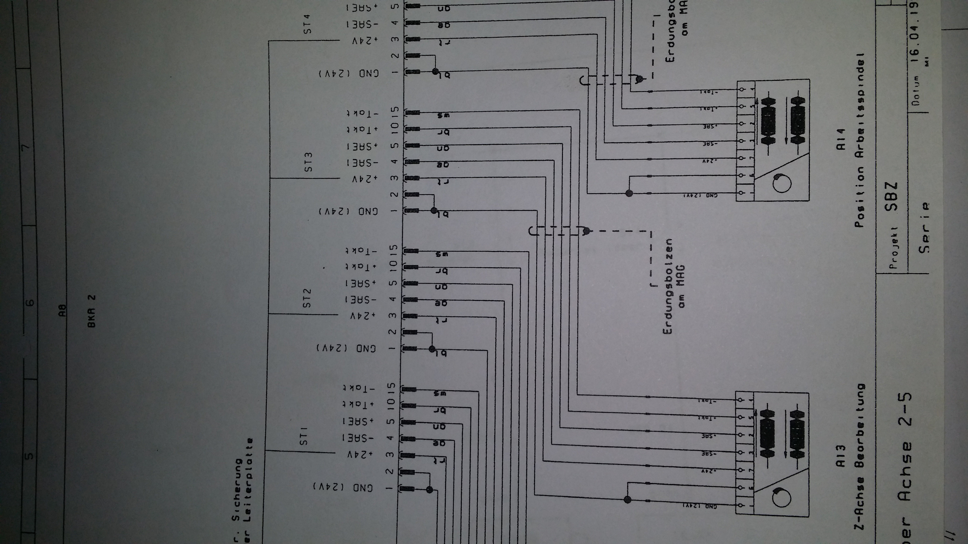

After a detailed check, found out that the long axis encoder has "direction" wire, others do not.
So it looks like the serial absolute encoders on 3 normal axis and spindle are usual "clock +-" and "data+-" type, so hopefully they can be made to work with 7i74, and this is the first thing i have to check.
The setup is: 6i25=>7i77&7i74=>7i70&7i71, already flashed with 5i25_7i77_7i74.bit file
---how do i go about using the 7i74 as half SSI and half SSerial? I need 4 encoders and 7i70 and 7i71, nothing more
Attaching some pictures of the old and the new.
Regards,
Tom
P.S.
Attached pictures of the encoders, the one on the long X axis is not the same as the other 4, it has a wire labelled "richtung" meaning direction???

- Posts: 18093
- Thank you received: 5325
14 Jan 2017 04:01 #85721
Replied by PCW on topic Elumatec SBZ 130/01 retrofit
I'm pretty sure you need a custom bitfile for this.
I'll try and cobble one together tomorrow, a bit too much red wine tonight...
probably named 5i25_7I77_7i74_ssi_ss.bit

14 Jan 2017 17:50 #85763
freeby.mesanet.com/77ssiss.zip
Has the 5i25/6i25 bitfile and the new pinout file source code
P3 --> 7I77
P2 --> 7I74 (channels 0..3= SSI 4..7= Sserial)
Not tested, better to test with a 6i25 than 5I25 since a 6I25 can be boostrapped without
JTAG if a non-workin bitfile is loaded
P3 --> 7I77
