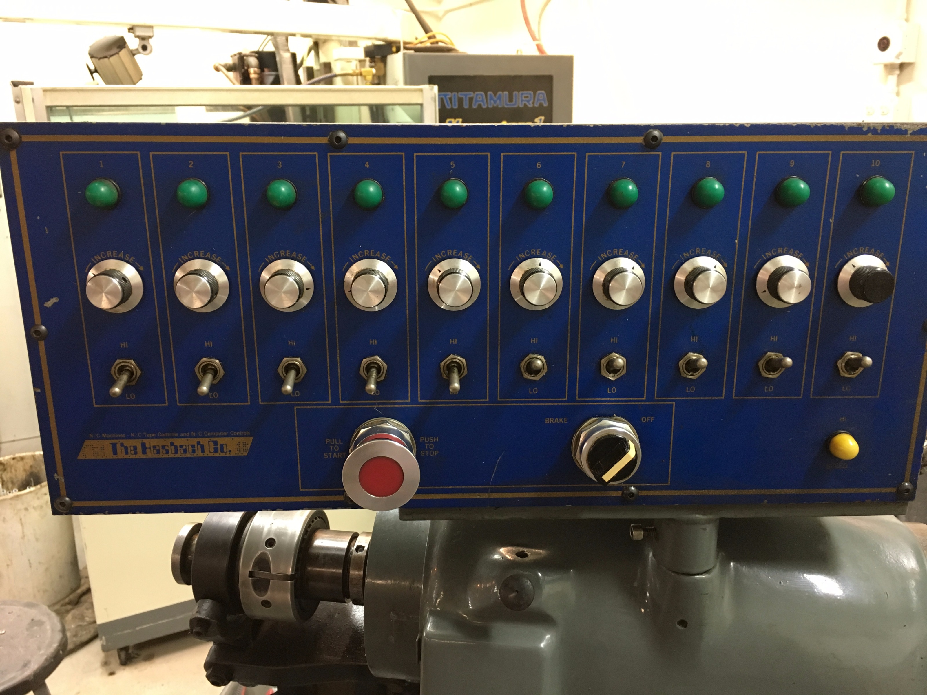

The spindle is a two speed 3ph 1.5hp induction motor with a mechanical speed adjustment driven by a 3ph motor operating a jack screw. There is a potentiometer driven by a worm gear to give a voltage relative to the jack screw position. The Bandit allows you to program up to 10 different spindle speeds. Each speed it individually set with a potentiometer and a hi/lo switch. Crazy.
There is what I think is an encoder belt driven off of the spindle. It is 5v and wired to the IPR board. I haven't tried to see what the output is yet.
I would like to keep this motor. (Again, time and money.) Would it be feasible to have a macro to select the spindle speed, then drive the jack screw motor until the speed is achieved measured by the spindle encoder? Also is it possible to reverse this motor on the fly rather than turn off, brake, and turn on in the opposite direction? Maybe someone with manual Hardinge will know this.
Yes, or simply ditch the whole thing and run the spindle motor with a VFD. 1.5HP actually sounds pretty small, though. Try it and see.
Unless you have 3-phase in your workshop you will be using a VFD anyway.

06 Jan 2017 20:35 #85359 by mclausen
Replied by mclausen on topic Hardinge HC Bandit Retrofit
Thanks Andy for the quick reply.
I think I will try the existing spindle motor. My shop is already wired for 3 phase (with phase converters). I would like to run this the same time as my CNC mill, and run the A/C in the summer, so I want to limit the power requirements.
Even though 1.5hp doesn't sound like much, it has that horsepower over the entire speed range. At low RPM it will probably outperform a much larger VFD motor. My 7.5hp mill only has about 0.5hp at 150 RPM.

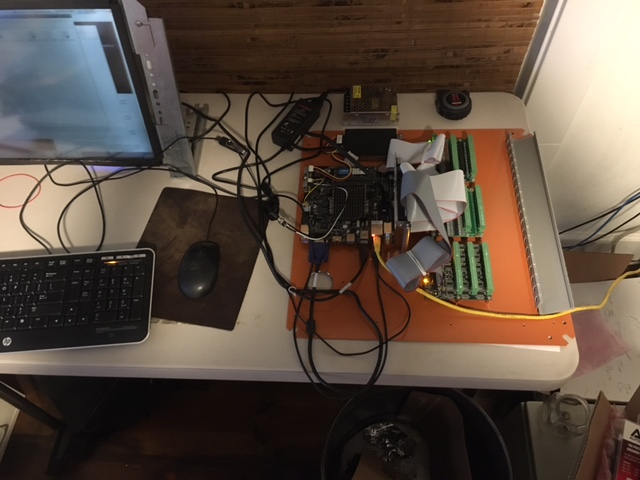

12 Mar 2017 15:02 #89468 by mclausen
I have the electronics panel assembled with a Gigabyte J1900N-D2H motherboard, a 6I24, 7I49, 7I42-TA, and a 7I37-TA.
I got the touch screen working with it.
My current problem is that I have been unable to get PNCconfig to work with the 6I24 (5I24 files). I downloaded the bit files, and got the one to work with the 7I49, (5i24_16_SV6_7i49.bit). I flashed it to the 6I24, using mesaflash, and after upgrading the mesaflash, I was able to write out an XML file.
The problem is that PNCconfig gives errors with this XML file. Is it possible to edit this file formatting to get it to read?
I saw where others were told to use a 5I20 XML file with PNCconfig and edit the name afterwards. I have been unable to find an XML file for any board to work with the 7I49 though.
Any thoughts on what to try next?
12 Mar 2017 15:07 - 12 Mar 2017 15:07 #89470 by PCW
Replied by PCW on topic Hardinge HC Bandit Retrofit
Its probably easier to use pncconf to create a config file set for a 5I23 and then edit
it an globally to replace 5I23 with 5I24 (and remove the firmware token from the config line)

12 Mar 2017 17:40 #89476 by PCW
Possibly but I think you need to download the hostmot2 firmware package from LinuxCNC to get all the pncconf XML files
