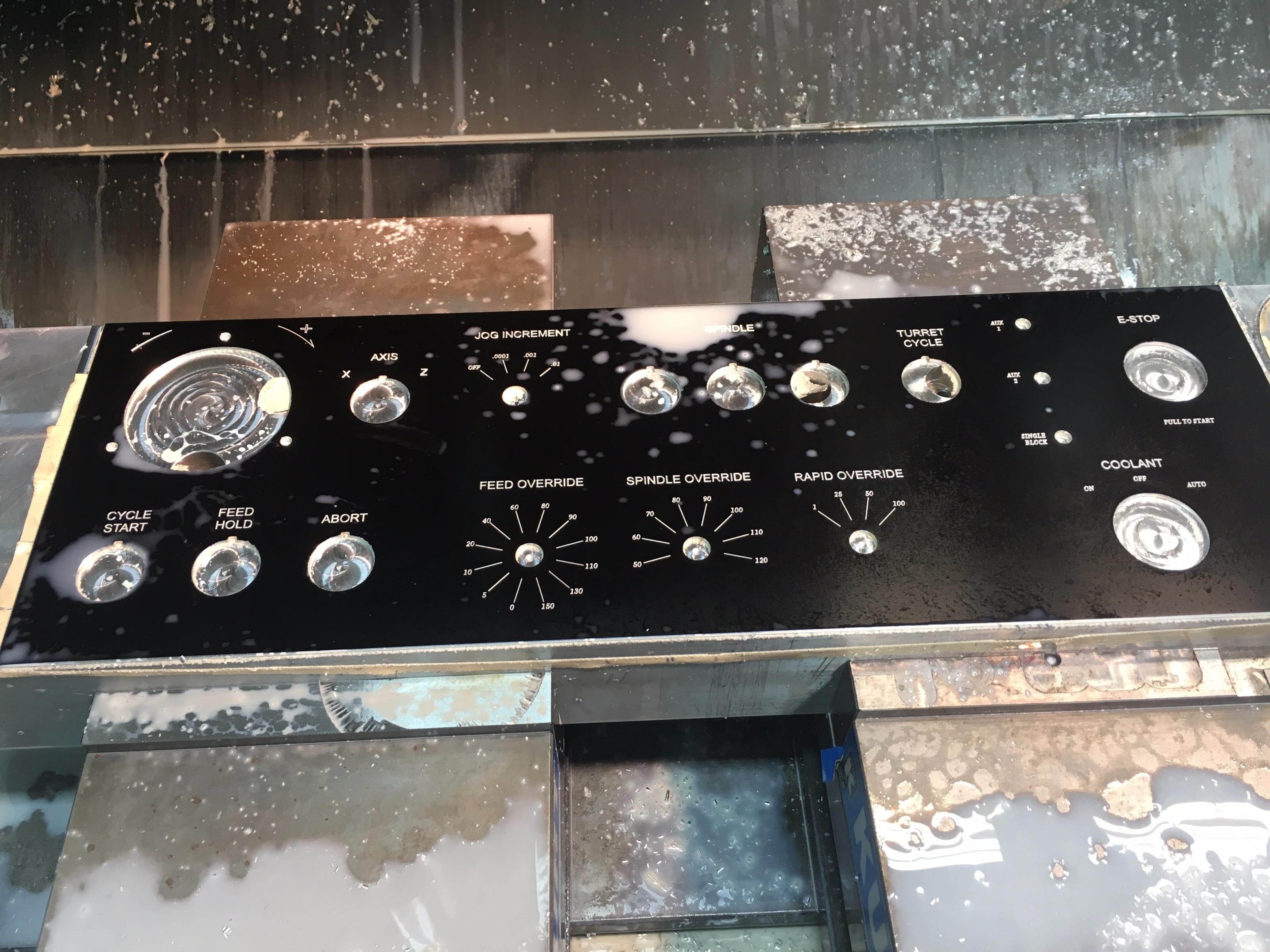

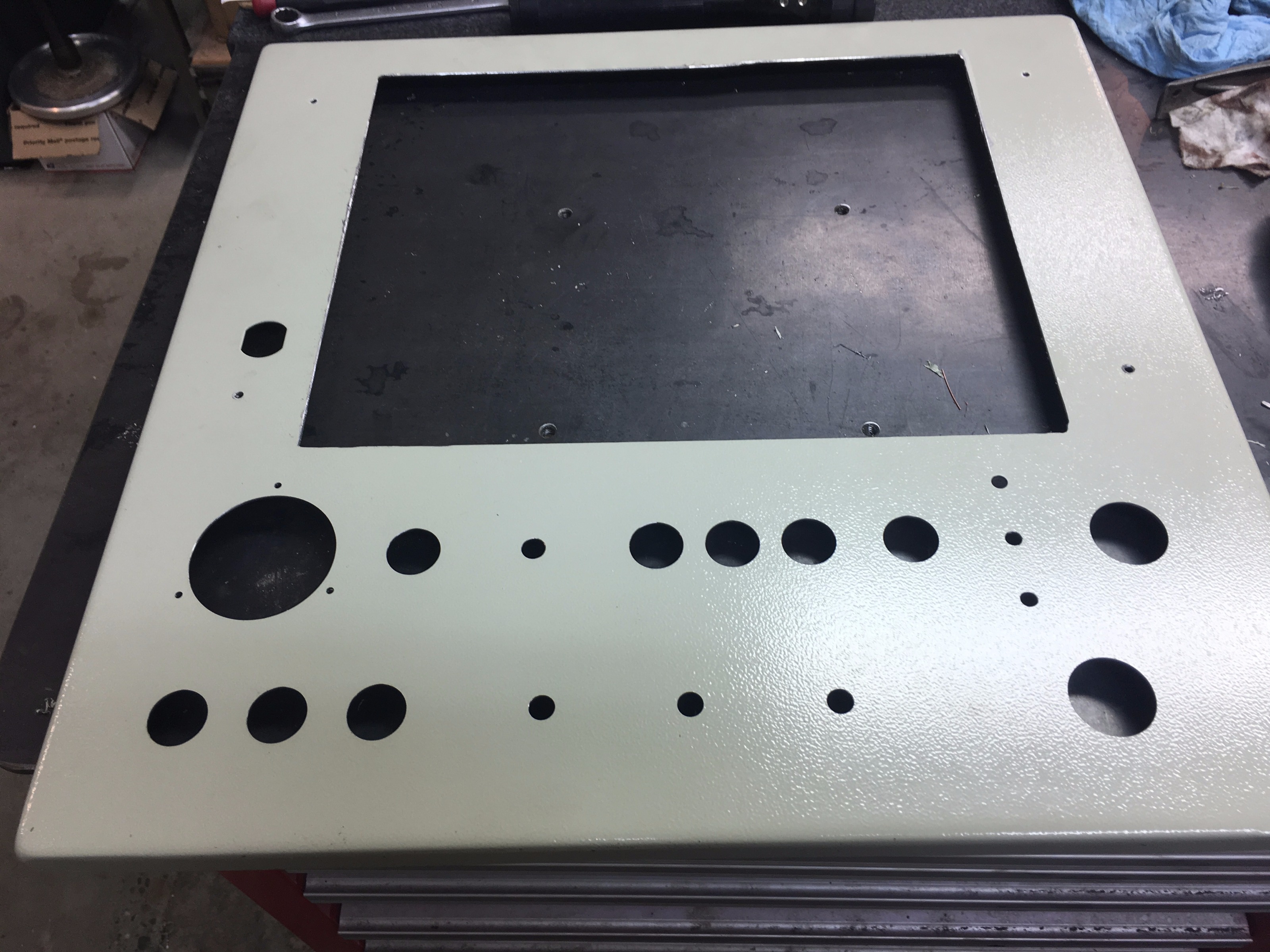

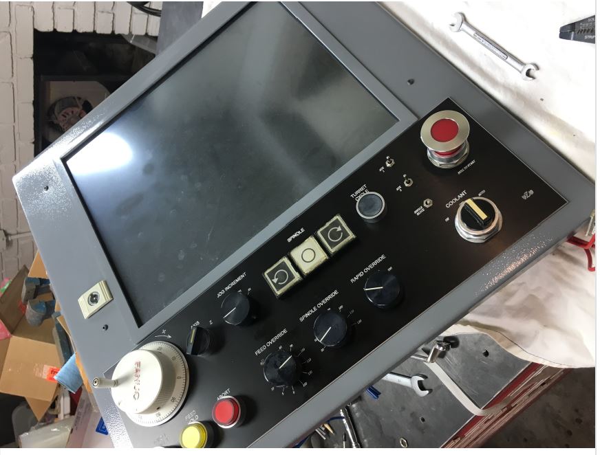

After some delay, I finally made some more progress on this retrofit.
I bought an electrical box, and machined the door to fit the touch screen, and controls.
I needed labels on the panel, so I bought an anodized aluminum sheet, and engraved into it. The controls are mounted, and I started the wiring.
Now I have some basic questions on connecting to the Mesa boards. This is probably so basic, that I haven't been able to find any discussion on it.
