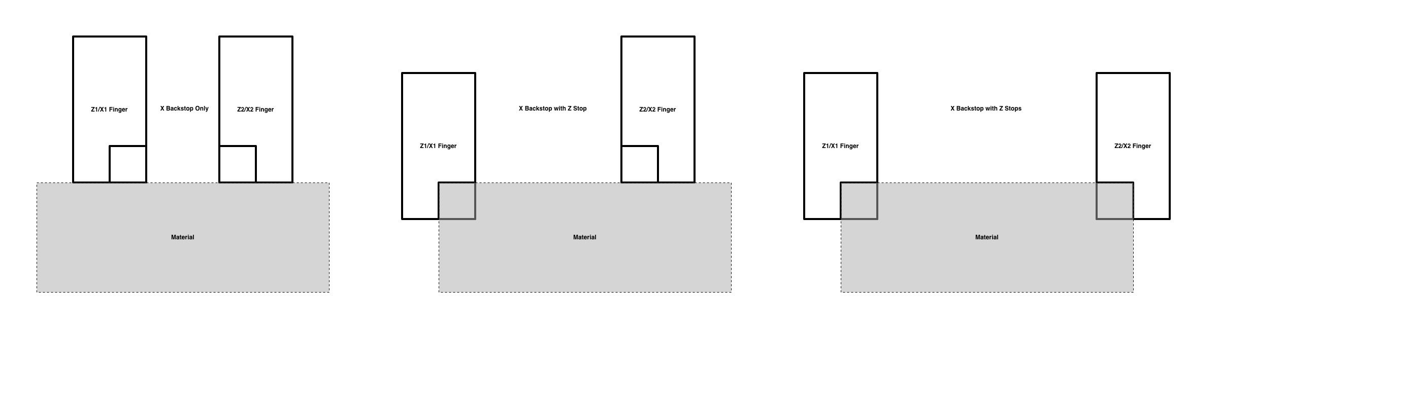

Yeah, I was leaning toward having a delta as the 2nd variable/position, afterall, I don't care that Z2 is N mm from the left, I just care that it's positioned far enough away from Z1 that the part I'm aligning has something to rest against. Likewise, I can then just move Z1, and Z2 will follow it - this is handy as if you fold a part multiple times or are using different tools as stations along the length of the press, then unless you change the parts orientation, you'll pretty much want the spacing to be the same.
I think for X and X1/X2 I might do something similar. Maybe specify A (which is X1's position) and then U (which is delta between X1 and X2) with X being calculated as the half way point between A and U.
The fingers normally have steps machined into them, so you can either use them as a back stop, or use a notch/step in them for the side(s) and back of the material. If you want a single side stop, then you just move the finger forward and to the left by the step size. A finger of 40mm width with a 20mm x 20mm notch, can either be used without offset on it's face, or with a 20mm x 20mm offset for the notch. I've attached an illustration to explain. This can be achieved with some nice macros/buttons in the UI and just require the step size to be added/deducted. The fingers often have rounded steps or tips, so that material has good contact when you're folding an angle and have the steps at different positions.
I'm including lots of detail in my posts for a few reasons... I know 99% of folks won't be interested, but it's a good way to 'talk through' my ideas, solicit feedback from folk with experience (albeit not just with presses but with motion control, LinuxCNC etc) and also so that if somebody else is looking to do this, then there's some info out there. I struggled to find info, so I'm happy to share and talk with anybody else looking to do this.

As to your Dual-Z config, one option might be to use Z and W, with W being the distance between Z1 (directly controlled) and Z2.
Thanks!

Normally U is a sort of "auxiliary X" and W is an "auxilliary Z" but you can set things up any way you want.
I wouldn't use A unless I had to, though. ABC are normally rotary axes.
