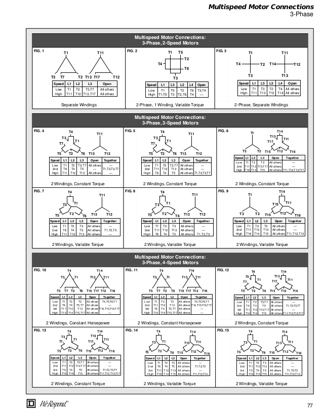

Tommy,
Does your BMC have the 2 speed spindle motor on it ? The one that changes speed from the change in motor windings ?
Thanks!
Thanks!

Thanks!! I need to figure out the electric winding change two speed on my machine

Thanks SMC,
I have the manual, it is not in jog mode. My spindle motor and drive has a contactor to change winding configuration when the contactor closes it switches the winding configuration so the motor will run slower. This is only for under 500rpm, I have not dealt with in a a long time as I normally run over 500rpm, there is a project coming in that requires deep boring that will be slow.

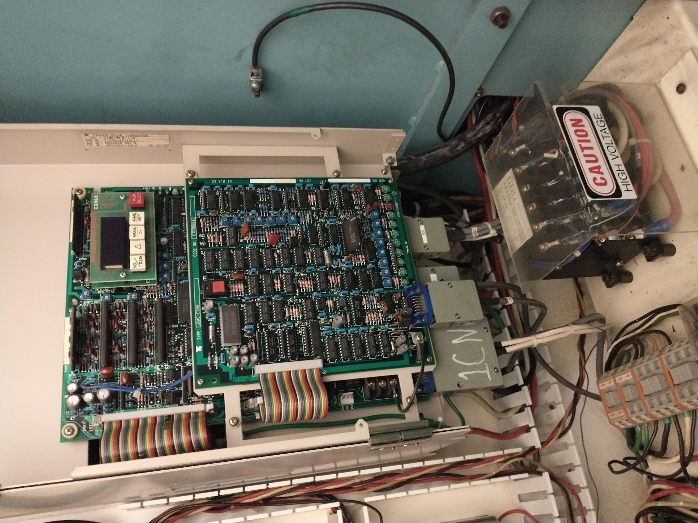

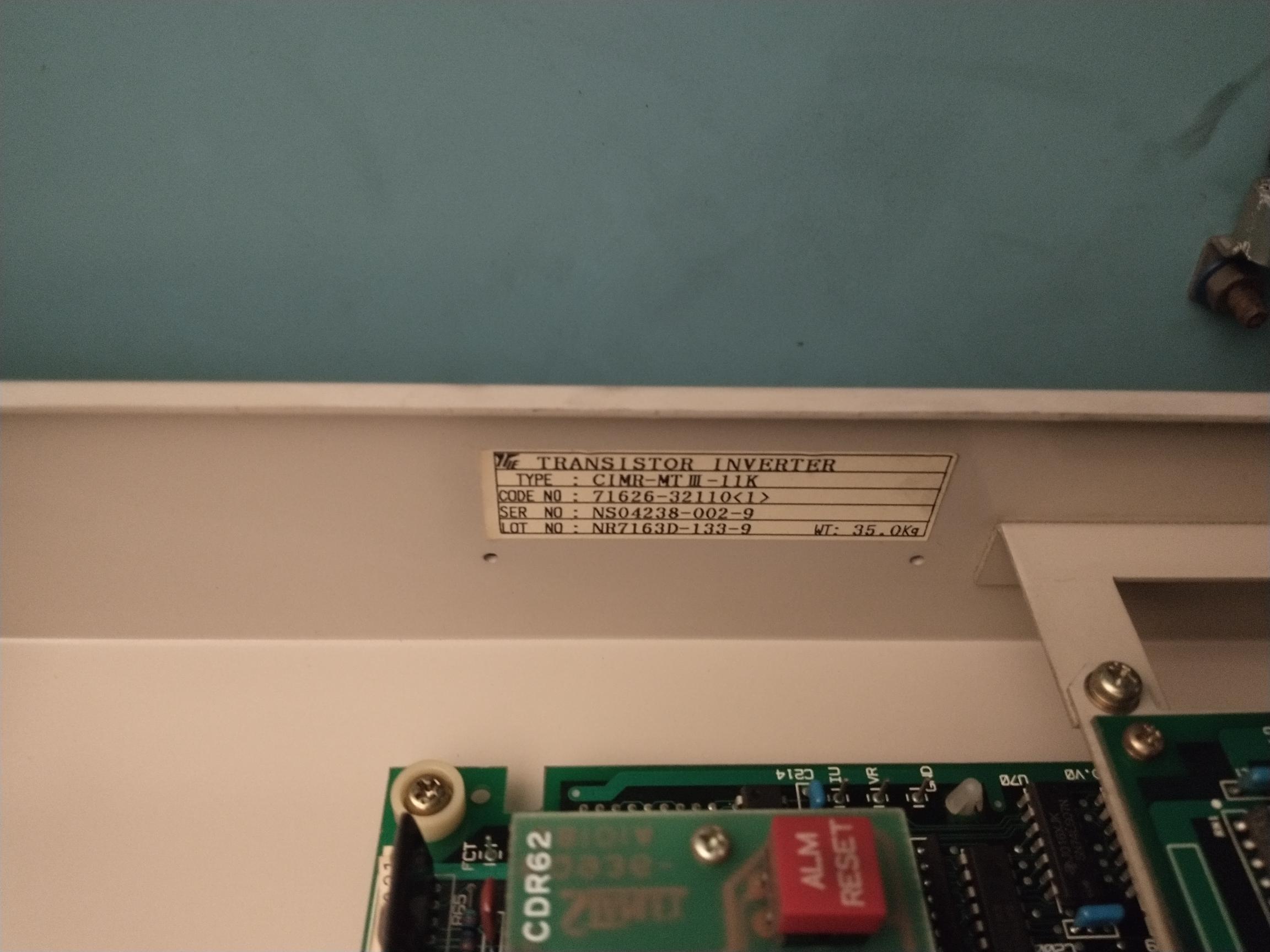

03 Aug 2022 01:52 - 03 Aug 2022 02:03 #248891
by smc.collins
Replied by smc.collins on topic HURCO BMC-20P retrofit
I am very curious about your spindle now, because AFAIK these use the cimr mt III yasakwa AC servo spindle motor controls, there is a low and high speed contactor for 2 sets of windings, it's towards the bottom of the manual, but that's usually only on the 15kw and up drives AFAICT, I have both, I can check in the morning if you like, both machines are untouched. if you need any pictures of them lmk I can post them for you

04 Aug 2022 19:09 #249064
by Jake
Replied by Jake on topic HURCO BMC-20P retrofit
- smc.collins
- Posts: 723
- Thank you received: 139
04 Aug 2022 23:35 - 04 Aug 2022 23:35 #249086
by smc.collins
I would have to look over the manual again, but that looks to be controlled by the servo drive unless I am misreading the schematics. All you have to do is pick which Gear enable you want to use on the input side.
