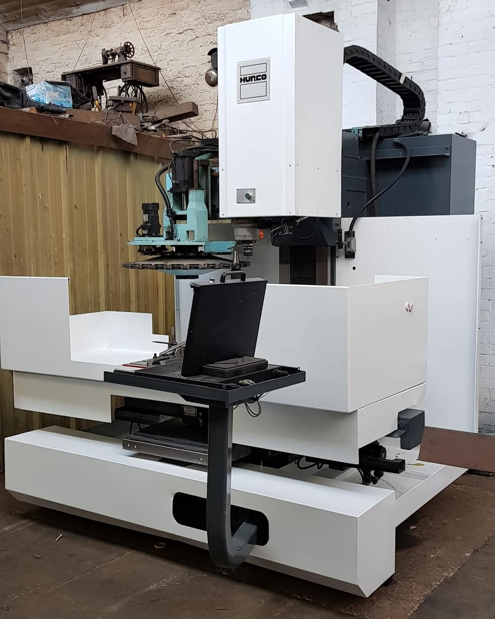

23 Sep 2018 19:10 #117902
by Ozo
Replied by Ozo on topic Hurco BMC30 Retrofit
Andy,
The noise was bad enough to glitch out the control computer (inside one of the control panels) and/or PS2 keyboard and mouse. A USB keyboard was not affected though.
I had tried to use as much of the original wiring as possible but there were so many ground loops and absolutely no shielding that I just decided to start from scratch. Pulling all earths to a single star point stopped 80% of the noise. I also used shielding tape at the servo end of the control-servo drive cables. The last and surprisingly least effective thing I did was to swap out the old VFD-Spindle motor cable to CY cable.
I still have a little bit of noise which I can see from a flicker in my screen however it doesn't seem to have any effect on the workings of the machine. I guess those old 80's electronics were pretty resistant to noise!
My next issue was spindle wear. Over the years of tool changing the spindle had ended up out of round. I could measure 0.03-0.035mm runout on the inside of the spindle. After blueing a couple of holders I could see where the issue was. Sending out the spindle for a regrind and new bearings wasn't an option considering what the machine is worth. My other option was a homebrew grind in situ using a boring bar, I wasn't overly excited about the thought of this though. With nothing to lose, I decided to blue up the inside of the spindle and carefully touch the high spots with a die grinder. I then removed the drive lug. With the spindle running @ 150rpm I firmly held a new bt40 holder (no pull stud) that I lathered in valve grinding paste in the spindle. I did this with x6 brand new holders to ensure I was always using a proper taper. Basically, I did a regrind on the fly. The die grinder marks were removed. Success! Runout measures circa 0.0025mm in the spindle and clocking the inside of a BT40 ER32 holder (not one I used for grinding) I measure 0.01mm of runout which is the spec'd tolerance for the holder. I attribute the success of this to the fact that with the high spots removed the taper acted as a guide for itself. Although not perfect or close to a new machine I'm happy with the runout considering its almost a 30yo machine. It should hold good enough tolerance for anything I will need it to do.
I thought I had made a bollocks of it at the start as although runout was acceptable tools where very hard to remove from the spindle. Turned out grinding/honing the spindle had left it so smooth that every tool was creating a vacuum effect just the same way slips do. A very light touch with a piece of sandpaper on the inside of the spindle instantly solved the problem.
As of now I'm running the machine and just doing manual tool changes to see how it's running. So far so good, its holding tolerance well. I would like to play around with the backlash settings a bit more and also the settling tolerance on the servo drives.
Next on the list is to reinstall flood coolant as I only have the mql system running. After that, I need to get the spindle chiller back together and then the final job will be the tool changer.
Picture of the machine in its current state except I now have my sliding guards fitting.
26 Sep 2018 12:24 #118002
Replied by andypugh on topic Hurco BMC30 Retrofit
I fixed noise problems with my VFD by fitting a
filter to the VFD input
and running the motor cables through a ferrite choke.
- Ozo
- Posts: 19
26 Sep 2018 16:15 #118012
by Ozo
Andy,
I have done both of these. All remaining noise (and most of the original noise) seems to be coming from the servo drives. The noise only appears when the drives are powered on.
Regards,
Andy
Regards,
Andy
26 Sep 2018 16:20 #118014
You could consider input filters for the servo drives, but only if they are AC input. I doubt that the common VFD filters are suitable for DC power.
