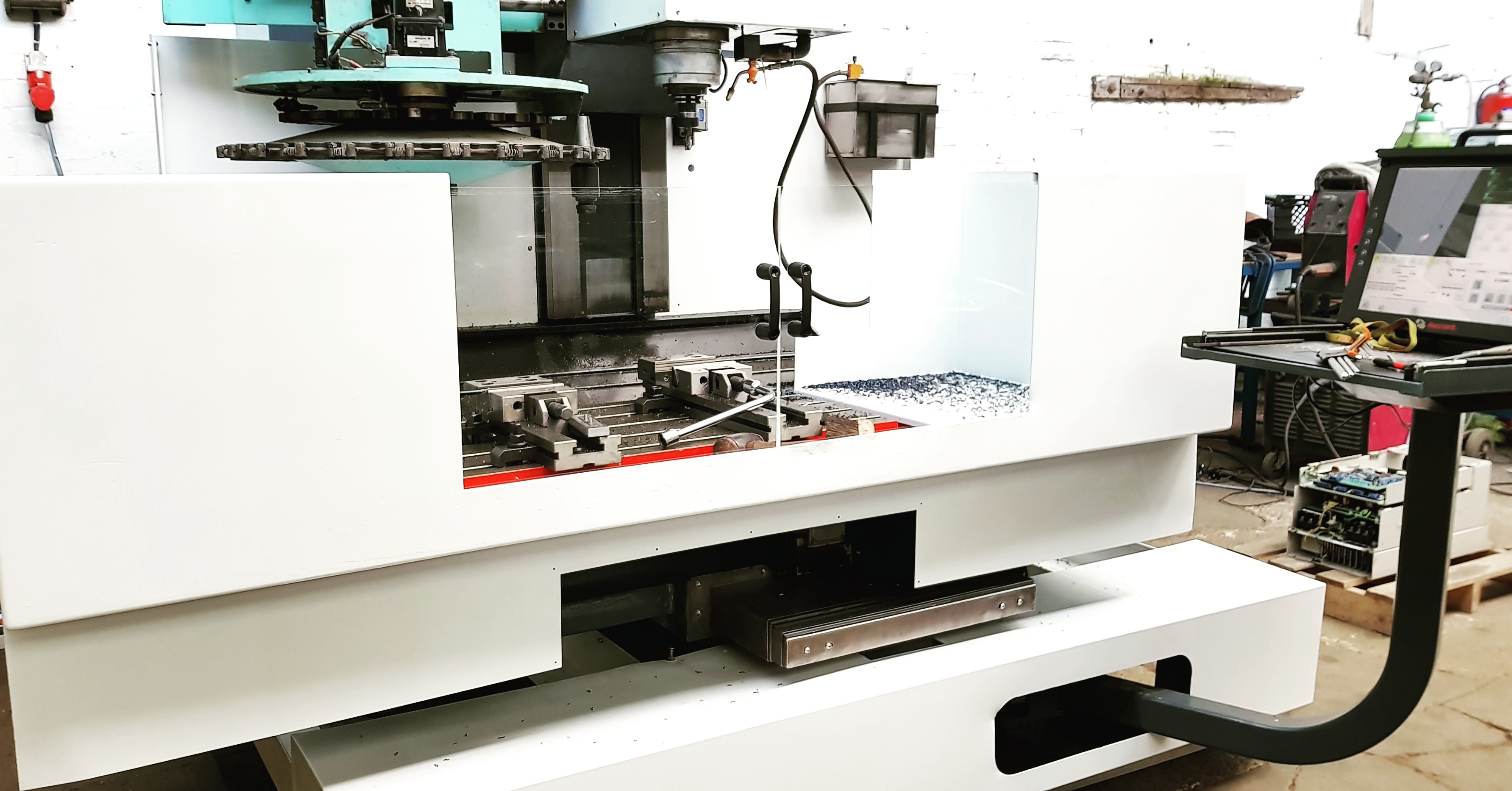

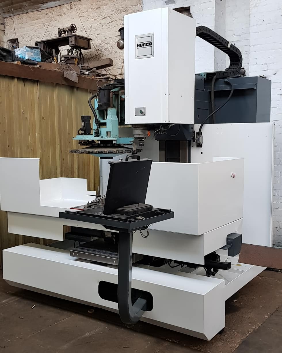

21 Jul 2019 19:37 #140104 by Ozo
Replied by Ozo on topic Hurco BMC30 Retrofit
Thought I should really update this thread!
Finally got to the bottom of the noise issues.
The 2 main issues were a loose crimp in one of the servo cable connectors and the fact I had reused a lot of the original hurco wiring.
The loose crimp took quite a while to find by testing and pinpointing the issue.
I can only assume the original electronics were a lot more immune to noise. I noticed that the old wiring had earth points everywhere, I disconnected them all and brought everything to a star grounding config.
The remaining perceived "noise" I could see was the result of a cheap vga cable which ran alongside the servo to motor cables.
The machine has been working daily for the last 9-10 months.
I'm growing tired of the manual tool changes so I have started to configure the toolchanger.
I've had the rigid tapping working for the 9-10 months using the quadrature encoder on the spindle motor.
I have now configured the orientation and its working well however I've discovered that my 1:1 drive between my motor and spindle isn't exactly 1:1! So the index position is constantly moving. I guess this is why the machine originally had a separate index pulse directly triggered from the spindle. The original system is what I assume to be some sort of hall effect sensor which is then put through an amplifier, I haven't had any luck getting this to work yet but I need to play around with it some more.
I've identified all the control wires for the toolchanger. I'm currently waiting on a new brake pack coming for the tc motor and then it will be time to start getting everything connected up.
I'm very much enjoying the learning curve with the hal config, the more I learn the more I realise how powerful linuxcnc is, with a custom front end you could pretty much control just about any type of machine. Next thing on the list after the toolchanger is learning how to develop a GUI.
Picture is of the machine as it currently sits.
