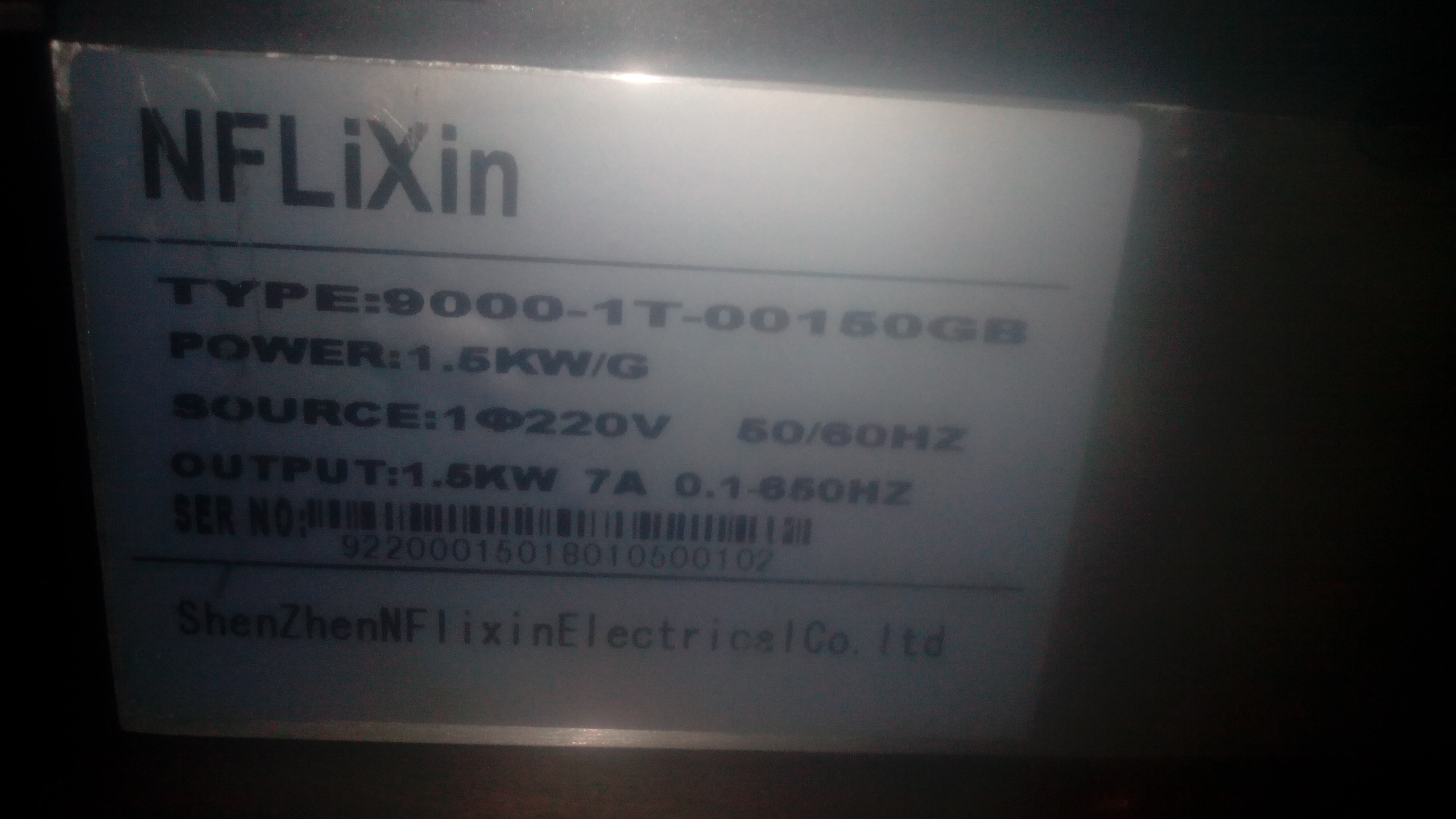

After years of use it only works when it feels like it, so i got a replacement NFliXin 9000 VFD. I read manual and setup Com method baud, address and so on ... I discovered that the VFD have different ways of communicating !
Has anyone setup NF 9000 using modbus ?

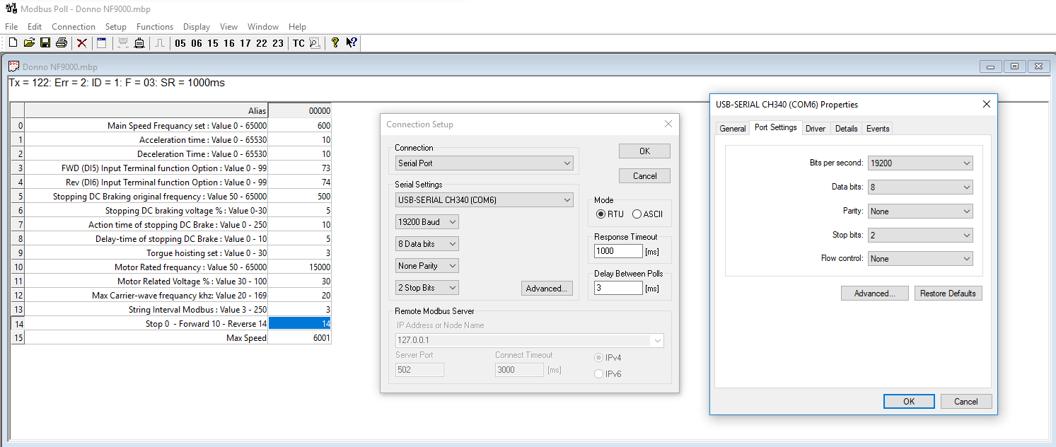

I managed to learn Modbus and connected my VFD to PC It seems this is another copy of a cheap Chinese VFD
This is NF-9000 and there is similar one called WL-9000 [Same manual] ! Think it is a clone of original HPI6000 since it uses the communication form !
Anyway here is the settings i used :
On VFD Parameter i used P093 and set it to 22.01 (PB.id)
P = Modbus, no parity , 8 bit binary
B = 19200bps , 2 stopbits
id = Slave id 1
on PC
Now that i know the Modbus function to use and the Parameters Address for speed control and moving the spindle how do i write custom hal driver ?
id = Slave id 1
on PC

After a few hours i managed to get into LinuxCNC
NF9000.ini
INIT_DEBUG=3
HAL_MODULE_NAME=mb2hal
SLOWDOWN=0.0
TOTAL_TRANSACTIONS=4
[TRANSACTION_00]
#REQUIRED: You must specify either a "serial" or "tcp" link for the first transaction.
#Later transaction will use the previous transaction link if not specified.
LINK_TYPE=serial
SERIAL_PORT=/dev/ttyS0
SERIAL_BAUD=19200
SERIAL_BITS=8
SERIAL_PARITY=none
SERIAL_STOP=2
SERIAL_DELAY_MS=3
MB_SLAVE_ID=1
FIRST_ELEMENT=58
NELEMENTS=1
MB_TX_CODE=fnct_03_read_holding_registers
MB_RESPONSE_TIMEOUT_MS=500
MB_BYTE_TIMEOUT_MS=500
HAL_TX_NAME=OutputSpeed
MAX_UPDATE_RATE=0.0
DEBUG=1
[TRANSACTION_01]
MB_TX_CODE=fnct_15_write_multiple_coils
FIRST_ELEMENT=14
NELEMENTS=1
HAL_TX_NAME=Forward
MAX_UPDATE_RATE=0.0
[TRANSACTION_02]
FIRST_ELEMENT=14
NELEMENTS=1
HAL_TX_NAME=Reverse
MAX_UPDATE_RATE=0.0
[TRANSACTION_03]
MB_TX_CODE=fnct_16_write_multiple_registers
FIRST_ELEMENT=0
NELEMENTS=1
HAL_TX_NAME=SetSpeed
MAX_UPDATE_RATE=0.0
custom.hal
loadusr -W mb2hal config=NF9000.ini
net spindle−speed−out−rps−abs => mb2hal.SetSpeed.00
net spindle-cw motion.spindle-forward => mb2hal.Forward.00
net spindle-ccw motion.spindle-reverse => mb2hal.Reverse.00
Still can't figure out how to write values to mod-bus address. The Address for forward,reverse and stop is using the same address so i can make one transaction for it ! Address 14 : Forward is value 10 , reverse is value 14 and stop is value 0 but it would not allow me to link the same variable to different signals
NF9000.ini
INIT_DEBUG=3
SLOWDOWN=0.0
[TRANSACTION_00]
LINK_TYPE=serial
SERIAL_BAUD=19200
SERIAL_BITS=8
SERIAL_PARITY=none
SERIAL_STOP=2
SERIAL_DELAY_MS=3
MB_SLAVE_ID=1
FIRST_ELEMENT=58
NELEMENTS=1
MAX_UPDATE_RATE=0.0
DEBUG=1
[TRANSACTION_01]
FIRST_ELEMENT=14
NELEMENTS=1
HAL_TX_NAME=Forward
MAX_UPDATE_RATE=0.0
[TRANSACTION_02]
FIRST_ELEMENT=14
NELEMENTS=1
HAL_TX_NAME=Reverse
MAX_UPDATE_RATE=0.0
[TRANSACTION_03]
FIRST_ELEMENT=0
NELEMENTS=1
MAX_UPDATE_RATE=0.0
custom.hal
- Todd Zuercher
- Posts: 4777
- Thank you received: 1469
17 Apr 2018 14:05 - 17 Apr 2018 14:11 #109186
Replied by Todd Zuercher on topic Modbus drivers for NF 9000 VFD
You probably will want to just start Linuxcnc to double check the pin names of the Mb2hal component you've set up, before you try using them to connect things in your hal files.
But here is what I think you are going to get from the ini file you've posted.
From Transaction_00 you will get 16 float output pins namedand from Transaction_01 you will get 24 Boolean output bit pins namedand from Transaction_02 you will get 16 Boolean input bit pins named
You will not be able to connect a spindle speed (a float) to any of those pins (bits). To get a float input you need to use a different MB_TX_CODE.
On my machine I used MB_TX_CODE=fnct_16_write_multiple_registers. to send the spindle speed.
FIRST_ELEMENT=14 <--address ?yes this is where you put the register number you want to write to
NELEMENTS=16 <--value ?Putting 16 here will create 16 hal pins that will comunicate with the 16 registers from #14 on.
What you probably want for transaction 2 is:
and in your hal fileThat would send your absolute spindle RPM speed command to register #14.
mb2hal.VAR1.00
mb2hal.VAR1.01
mb2hal.VAR1.02
mb2hal.VAR1.03
mb2hal.VAR1.04
mb2hal.VAR1.05
mb2hal.VAR1.06
mb2hal.VAR1.07
mb2hal.VAR1.08
mb2hal.VAR1.09
mb2hal.VAR1.10
mb2hal.VAR1.11
mb2hal.VAR1.12
mb2hal.VAR1.13
mb2hal.VAR1.14
mb2hal.VAR1.15mb2hal.VAR1.00
mb2hal.VAR2.01
mb2hal.VAR2.02
mb2hal.VAR2.03
mb2hal.VAR2.04
mb2hal.VAR2.05
mb2hal.VAR2.06
mb2hal.VAR2.07
mb2hal.VAR2.08
mb2hal.VAR2.09
mb2hal.VAR2.10
mb2hal.VAR2.11
mb2hal.VAR2.12
mb2hal.VAR2.13
mb2hal.VAR2.14
mb2hal.VAR2.15
mb2hal.VAR2.16
mb2hal.VAR2.17
mb2hal.VAR2.18
mb2hal.VAR2.19
mb2hal.VAR2.20
mb2hal.VAR2.21
mb2hal.VAR2.22
mb2hal.VAR2.23mb2hal.orward.00
mb2hal.forward.01
mb2hal.forward.02
mb2hal.forward.03
mb2hal.forward.04
mb2hal.forward.05
mb2hal.forward.06
mb2hal.forward.07
mb2hal.forward.08
mb2hal.forward.09
mb2hal.forward.10
mb2hal.forward.11
mb2hal.forward.12
mb2hal.forward.13
mb2hal.forward.14
mb2hal.forward.15You will not be able to connect a spindle speed (a float) to any of those pins (bits). To get a float input you need to use a different MB_TX_CODE.
[TRANSACTION_02]
FIRST_ELEMENT=14
NELEMENTS=1
HAL_TX_NAME=forward
MAX_UPDATE_RATE=0.0and in your hal file
net spindle-cmd-rpm-abs => mb2hal.forward.00
Last edit: 17 Apr 2018 14:11 by Todd Zuercher.
- Todd Zuercher
- Posts: 4777
17 Apr 2018 14:51 #109191
Ok, so you need to look at register #14 as a binary number, and twiddle the individual bits as separate hal pins.
I am guessing that the values of 14, 10 and 0 are supposed to be either hexadecimal or octal (the binary works out better that way.)
And for that you will want to use:
Do you have a list of what each bit in register #14 represents?
So for stop start forward reverse you would only use one transaction.
[TRANSACTION_01]
FIRST_ELEMENT=14
NELEMENTS=4 (or 8 or 16 depending on your register size)
HAL_TX_NAME=runcontrol
MAX_UPDATE_RATE=0.0
And your hal pins would be something like
net run => mb2hal.runcontrol.03
net reverse => mb2hal.runcontrol.02
#To run the spindle in reverse both pins mb2hal.runcontrol.03 and mb2hal.runcontrol.02 must be true
[TRANSACTION_01]
FIRST_ELEMENT=14
MAX_UPDATE_RATE=0.0
