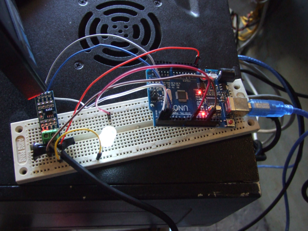

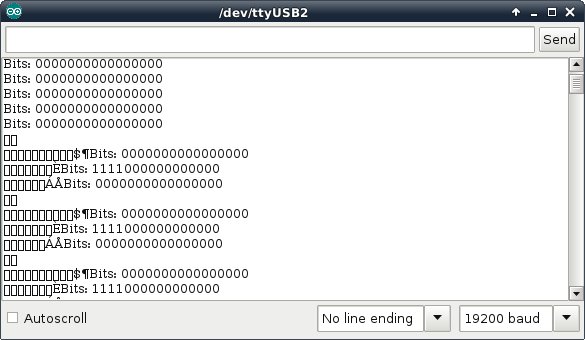

- Donno
- Posts: 137
- Thank you received: 17
19 Apr 2018 08:41 #109285
by Donno
Replied by Donno on topic Modbus drivers for NF 9000 VFD
After spending the last 2 days figuring out the problem this is what i came up with so far. The main problem was
SERIAL_PORT=/dev/ttyS0 in NF9000.ini should be SERIAL_PORT=/dev/ttyUSB0 that is why linuxcnc never gave an error when disconnecting the USB because i was writing to parallel port

So i Created a feedback loop using the arduino ide serial monitor and changed the SERIAL_PORT=/dev/ttyUSB0 to arduino SERIAL_PORT=/dev/ttyUSB1
When i put the spindle in ccw the pin change 1010 and 0000 and 1010 <-- (we get back to this now) So now i know it is working, writing the data to Modbus. i changed settings to VFD and nothing happens i remember that the speed needs to be changed as well for the VFD to move forward . I wrote this in my custom.hal file

If you look at the image of the serial monitor you can see the bits look corrupted i thought this was normal because modbus-poll in Win 10 did the same thing and it works great with the VFD.
Any suggestions will be appreciated i also double checked my settings baud , parity etc.
