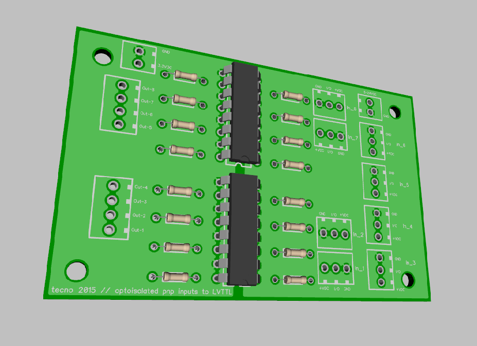

Replied by PCW on topic Gerber D-200
Mesa step/dir interface cared are 5V only.
You would likely need to use a level translator of some kind
Since the drive is probably unipolar, a parallel port interface is not going to impact performance much if at all.
The level shifter might be as simple a a set of OPTO isolators if simple sinking or sourcing drivers will do.

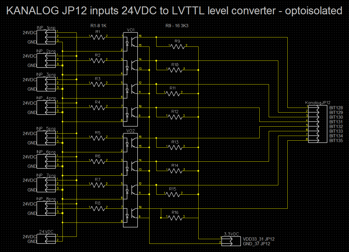

- tecno
- Posts: 1850
- Thank you received: 127
20 Jul 2018 09:07 #114572
by tecno
Replied by tecno on topic Gerber D-200
Hi Todd
I have some extra boards if you can use these. I made this to convert 24VDC to 3.3VDC but you can just change resistor values to your need. Optos are PC847 so you have to verify if these are fast/good enough for you, maybe pin compatible can be found to replace.
If you want one just let me know and it will be mailed to you.
Cheers
Bengt
Cheers
Bengt
