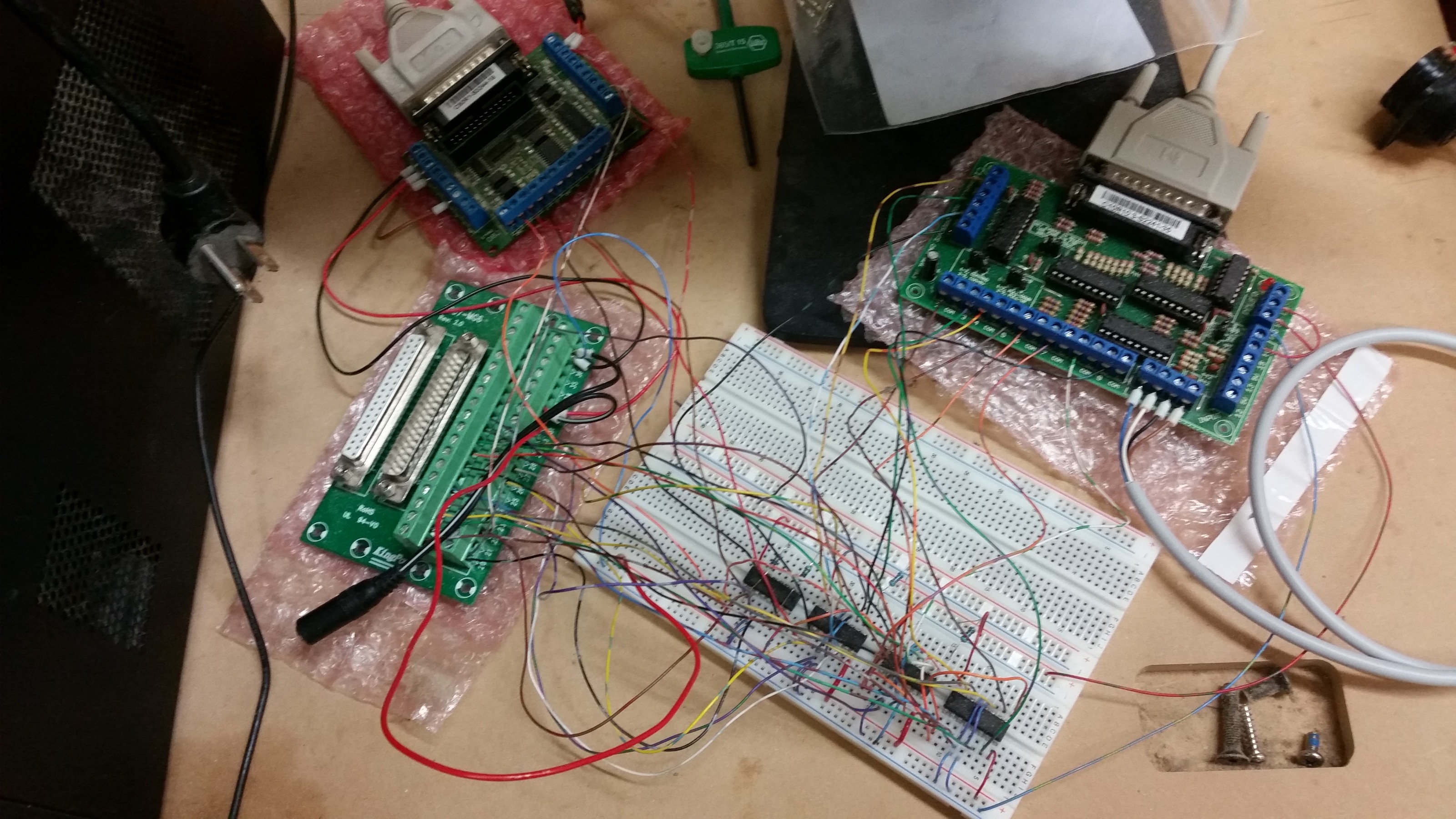

First, the C80 board was a bust as far as trying to use it to run the machine. It's opencollector outputs just weren't practical to trigger the drive steps. It's 24v inputs were useful for snooping the output signals from the old control. With that I was able to confirm the step patern is 1/2 step unipolar and even measure the step scale and velocity/acceleration.
So I popped the cover off the old control and looked over how it works. It uses a chip L239E to send the signal. So I bought 4 of these
www.mouser.com/ProductDetail/STMicroelec...Zq9rRehoCFTwQAvD_BwE
With them I am able to trigger the drive steps using an ordinary 5v breakout board for a parallel port.
So far I've tested moving 1 axis with Linuxcnc using a breadboard setup. After I test the full setup, I will solder up something permanent.

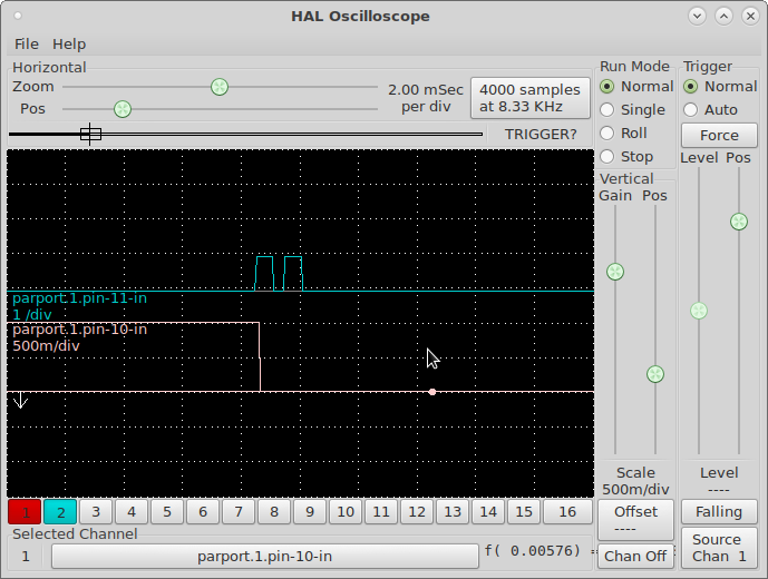

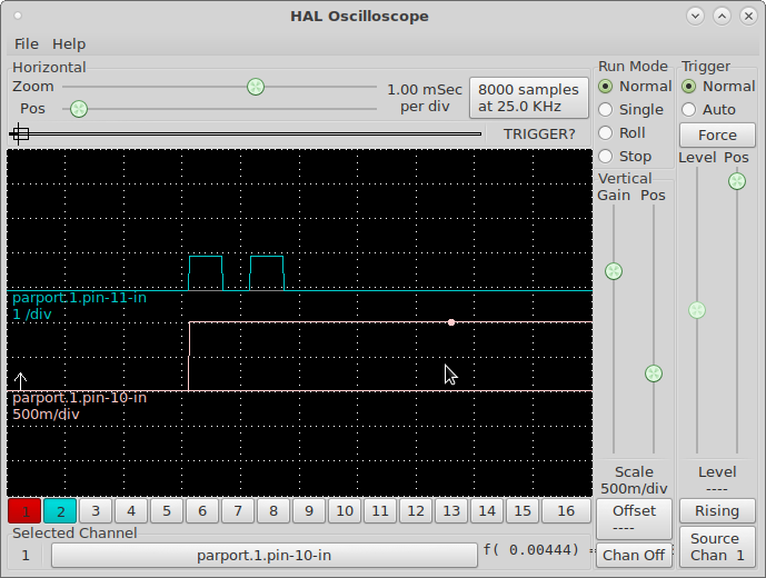

Well I spoke too soon about having it fully functional. I can't seem to command the router motor to turn on/off. I knew the old control put 24v on pin-20, but that by itself is not enough. So after careful examination of the boards I went back and checked the signal from the old control on pins 20 and 22 with Halscope. It turns out when pin 20 goes high the control also outputs two short pulses on pin 22. There are also two pulses on pin 22 when pin 20 goes low and the router stops. I will post pics of the Halscope traces tomorrow.
How would be the easiest way to reproduce that signal?

linuxcnc.org/docs/2.7/html/man/man9/oneshot.9.html
and linuxcnc.org/docs/2.7/html/man/man9/timedelay.9.html
So, two oneshots. One triggered directly from whatever rives pin 20, and the other triggered by a timedelay triggered by the same thing.
You then need to or2 the two oneshot outputs.
Or a custom comp.

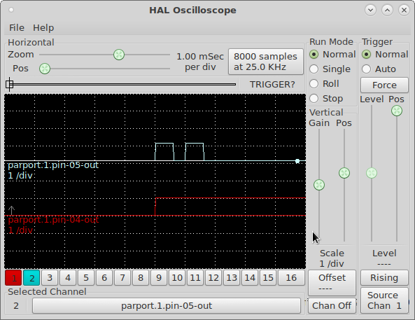

I ended up doing it a little differently, rather than using 4 components (2 oneshots, a timedelay and an or2) I did it with 2 edge components, both triggered by both rising and falling edges, the first one triggered by the spindle cmd, the 2nd by the 1st. The 1st edge I set the pulse width to the spacing of the 2 pulses, the 2nd the length of the individual pulses. and here is my result.
Now I just need enough time to go test it on the machine and see if it actually works.

There are two ways you can approach this. The way I did it, or the easy way. I wanted to retain the ability to run the machine with the old Gerber software, so I needed to retain the old Gerber motor drive. If you won't ever want to run the machine as Gerber intended it would be much simpler, to just replace the old Gerber driver board in the large black box with 3 conventional stepper motor drives.
The key to making it work was a set of L239E chips, to convert the 5v TTL signal from the pc breakout board to the 24v signal used in the Gerber drive box to trigger the drive transistors.
The other difficult part was figuring out how to turn the spindle on/off. (If you are not using the original Gerber driver board this is a non issue, just use a relay.)
