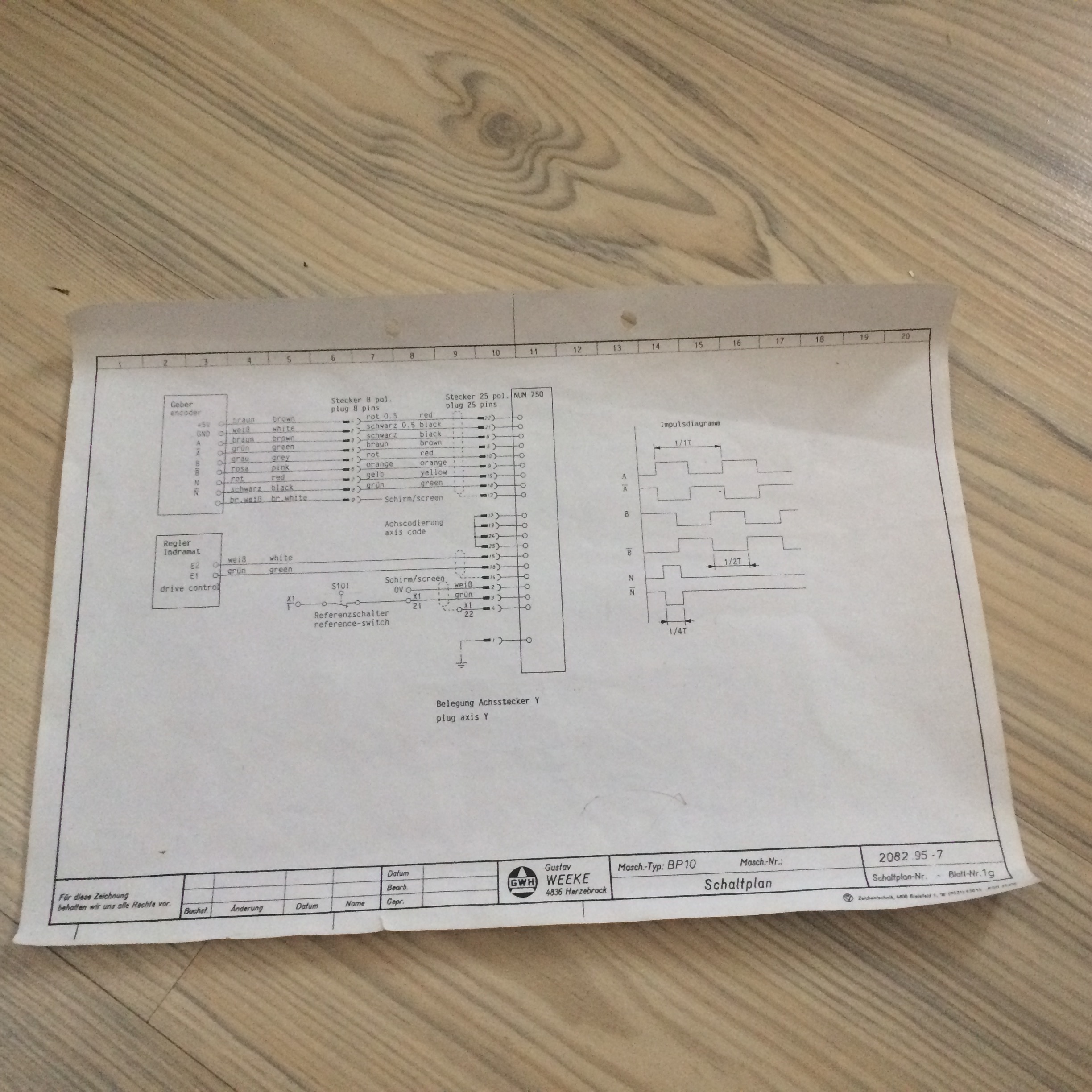

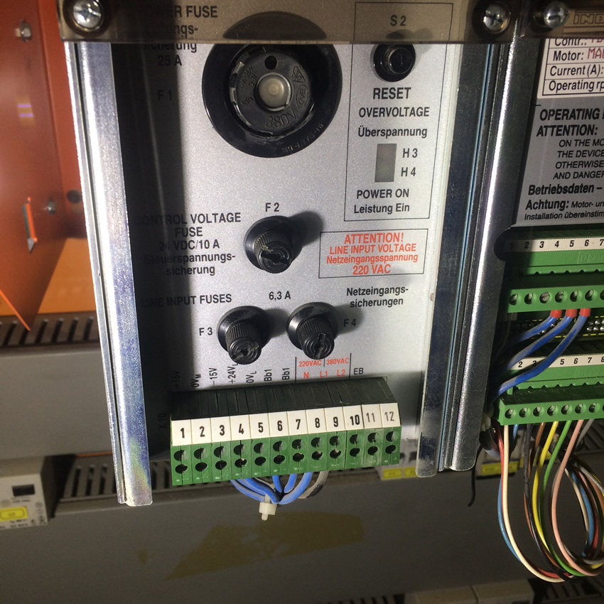

Replied by Marki123 on topic Weeke BP 10

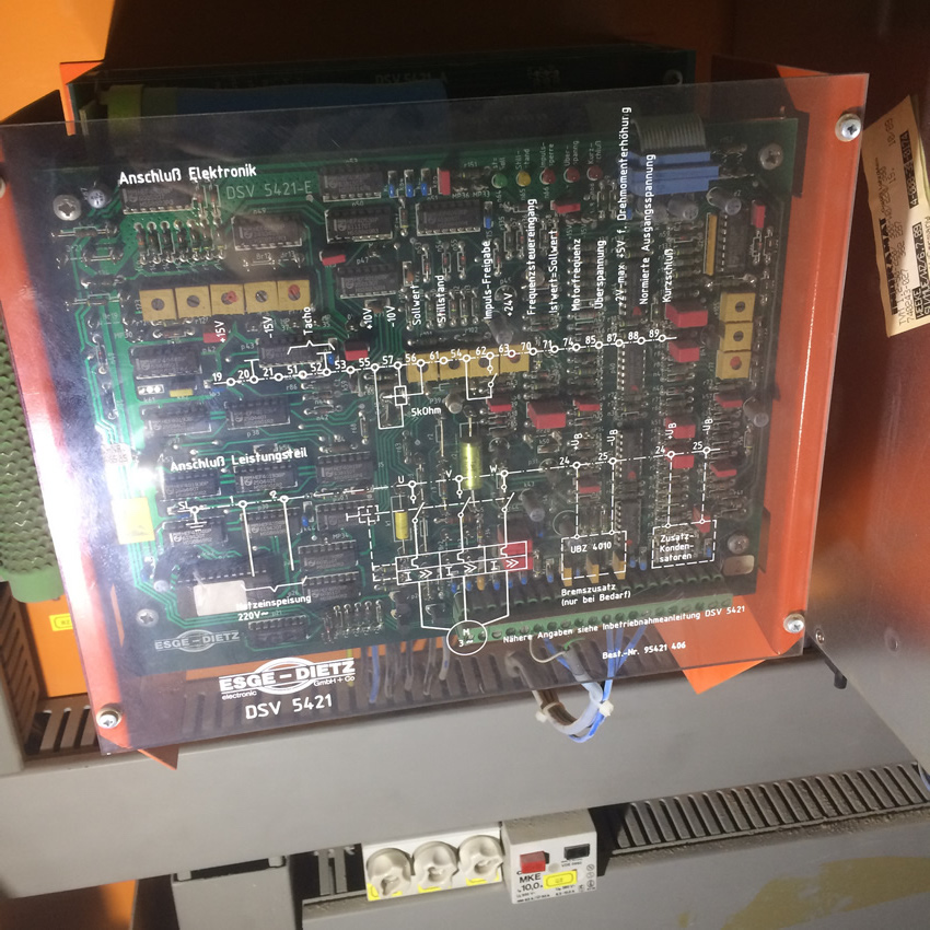

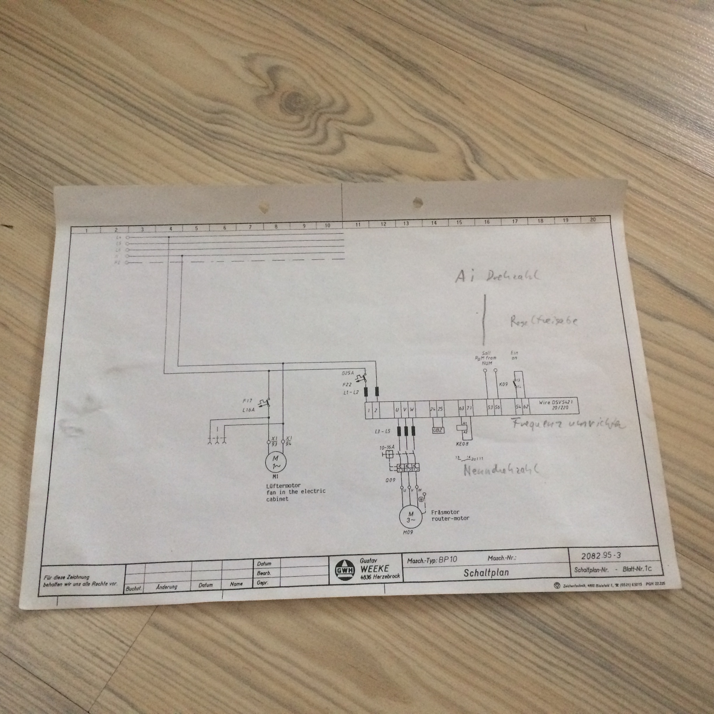

Maybe somebody can help me with the wiring with the DSV 5421. The Indramat depends on the electronics that was originally on the NUM 750. Where do I have the controllrelease and the RPM that I can control it with Linux cnc
7i77 input-07 for the FU
- Todd Zuercher
- Posts: 4788
- Thank you received: 1477
14 Jan 2019 02:45 #124134
Replied by Todd Zuercher on topic Weeke BP 10
it looks like pins 54 and 62 are would be the run or enable signal and pins 53 and 56 would be the analog signal for the velocity or rpm.

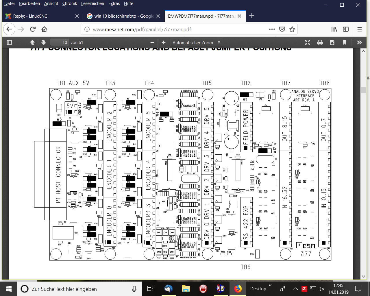

Could someone tell me how would you connect this on the 7i77. The input of the config on the card is input-07. Do I have to connect to the encoder?

I think that the DSV 542 is the VFD for the spindle, and I don't think there would be any encoder involved there. The enable/run pins (54,62) you need to figure out which one is positive and negative and connect them to the spindle enable pins ENA5+ and ENA5- (TB5 pins 21-22). (It is very important to have the polarity right, because hooking them up backward can ruin the enable output on the 7i77.) Then the other 2 pins (53,56) would connect to the analog out put AOUT5 and GND (TB5 pins 24 and 23)
You will need the encoder connections made for controlling the servo motors, Getting those working correctly should be your 1st priority. Then getting the servo enables and e-stop loop, and necessary digital IO (limit,home switches...) working. Then the analog servo connections and servo tuning. Finally tackling the tool changer.
This is a very big job on a very complex machine. I don't think I would have suggested a newbie with little electronics or CNC knowledge start with retrofitting one like this. But don't get discouraged, with enough time and willingness to learn as you go it should still be doable. (Remember you do have a lot to learn.)

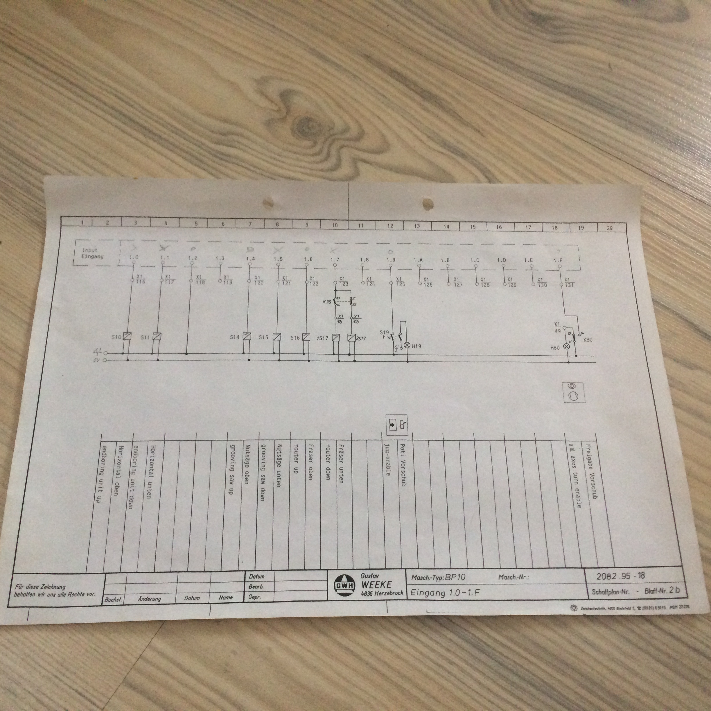

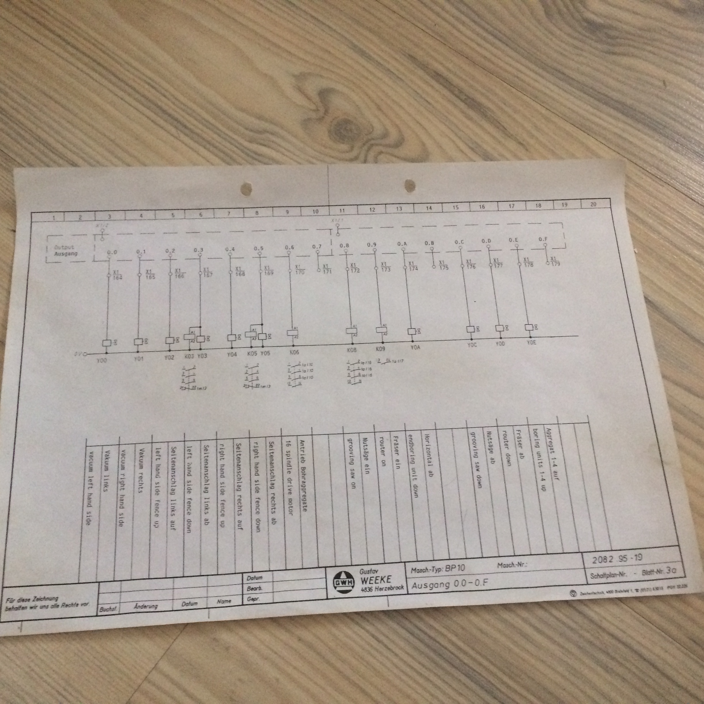

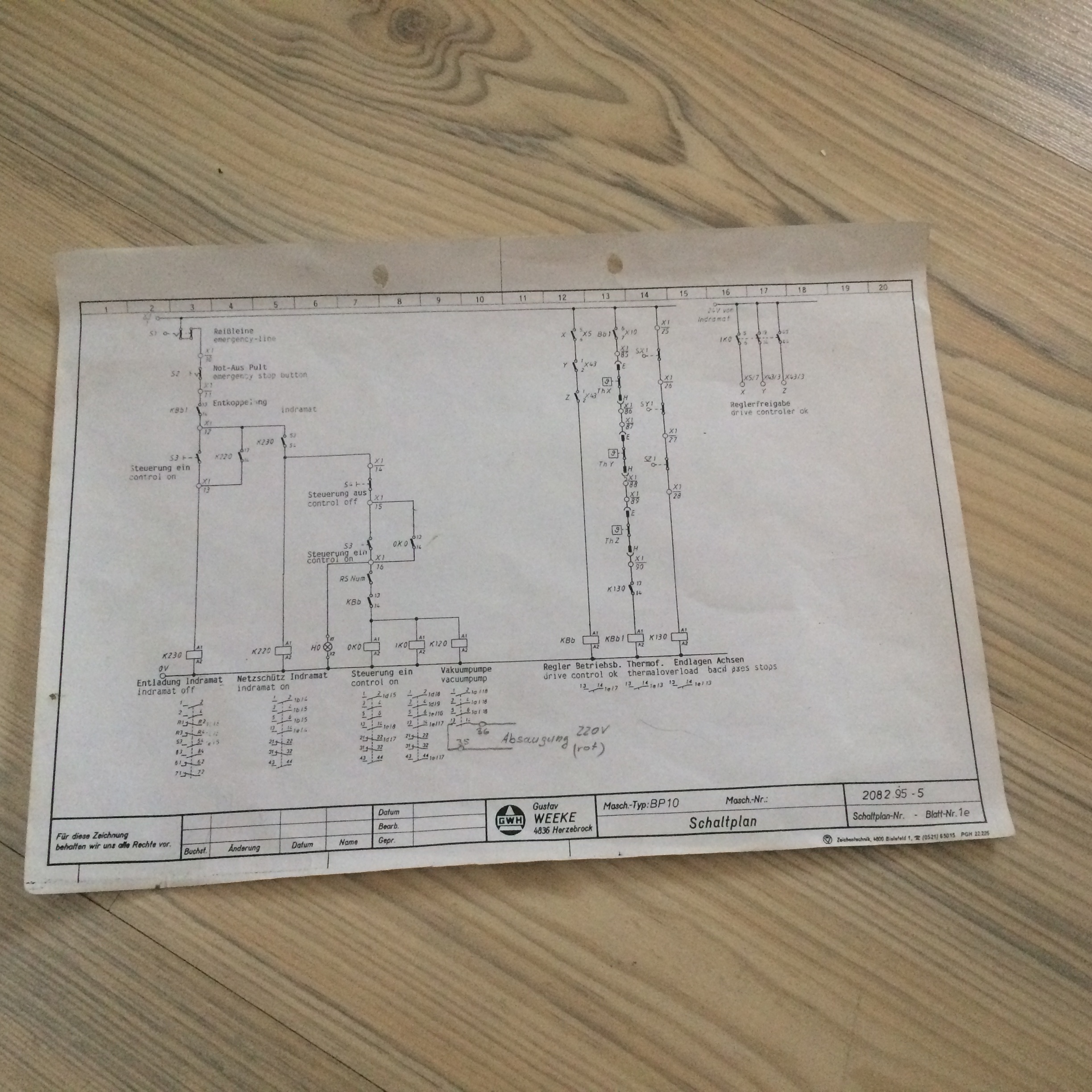

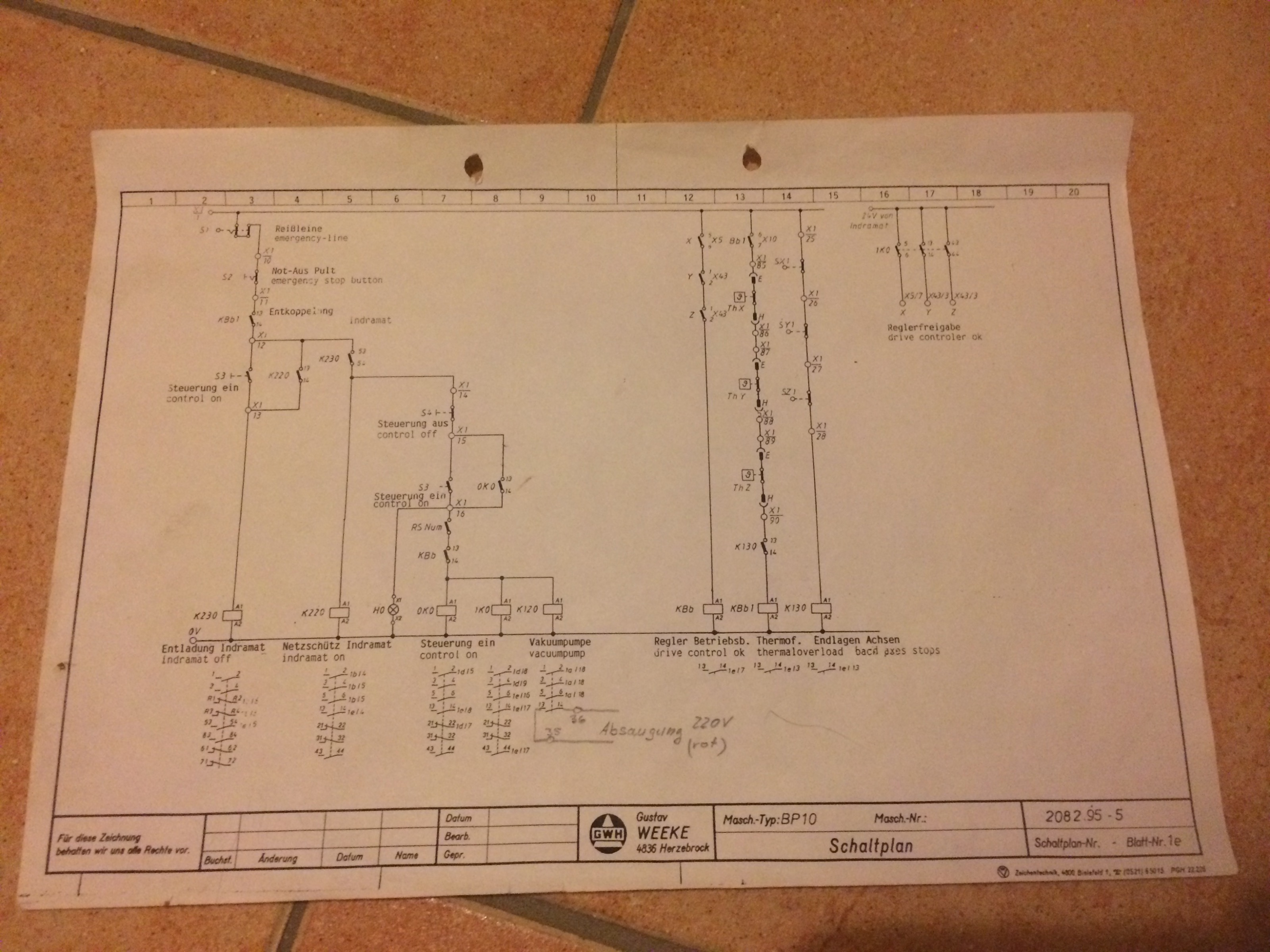

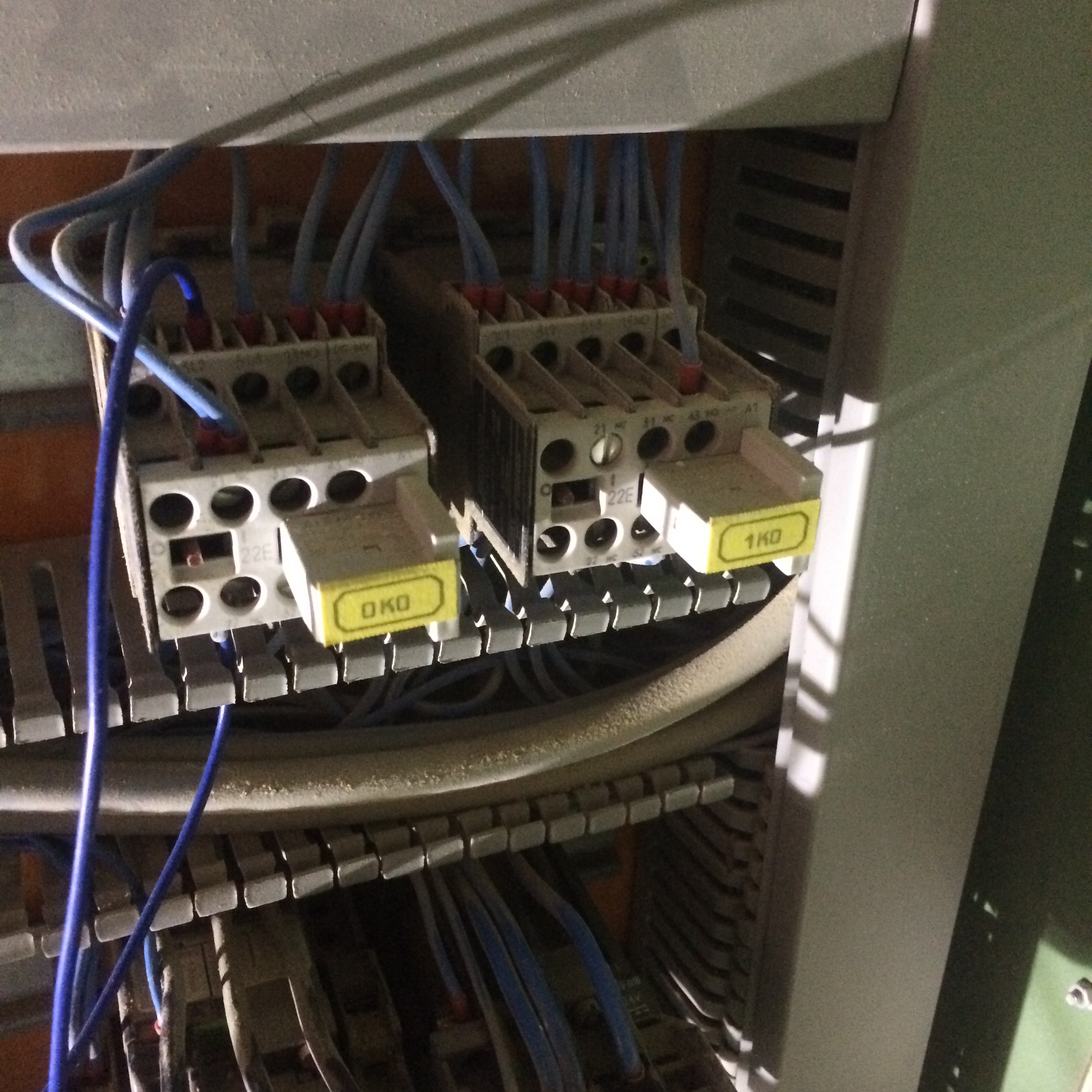

Hi, can someone help me to connect right the e-stop loop, limit and home switches for working the machine on the Mesa 7i77. To be able to press the start button on Linux
X Home Switch – 7i77 input-00-not
Y Home Switch – 7i77 input-01-not
Z Home Switch – 7i77 input-02-not
Hauptschalter = 7i77 input-06
Machine On= output-00 (Switch-on button bridged, Contactor behind the emergency circuit, Vakuum On, controller enable, Release Z-brake)

19 Jan 2019 19:36 #124452
by db1981
Replied by db1981 on topic Weeke BP 10
Hello,

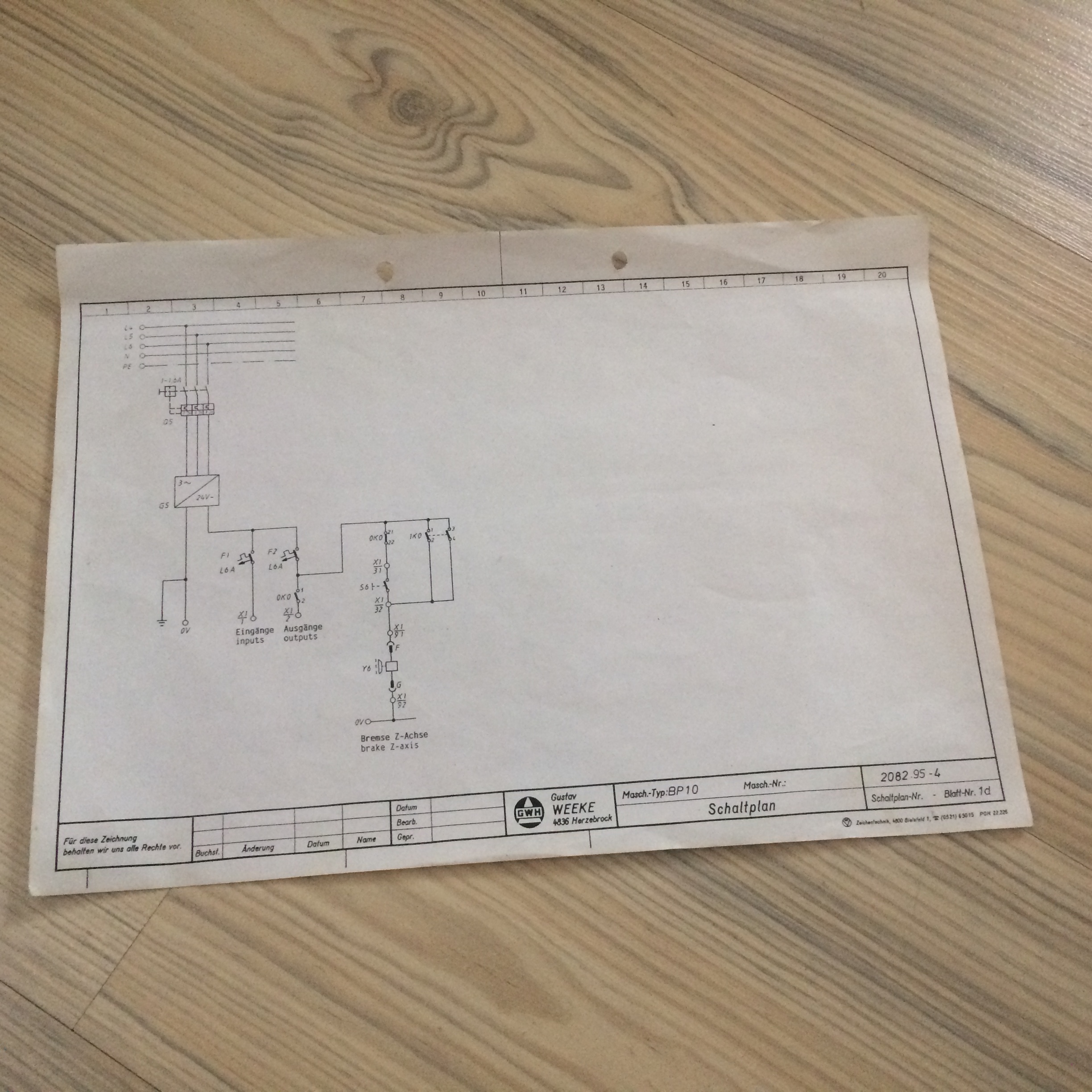

did you change the original E-Stop Chain?
To use the original E-Stop Circuit you have to insert an relay instead of the
RS-NUM Contact on PAge 1e. This contact tells the hardware circuit that the control is ready/ok.
The X Y Z Switches on Page 1e are not the Homeswitches, this are the 6 Limit switches in series and originaly in the e-Stop Circuit.
On my machine Linuxcnc does software End Limits.
I reused the original circuit and only reconnected the IOs from the num to Linuxcnc and some other minor changes.
From the original Estop circuit i disconnected 1K0 and did the following:
-Linuxcnc tells that it is ready , relais RS NUM (static setp in HAL)
-Contact from 0K0 to linuxcnc , tells Control Voltage is ready
-Linuxcnc on button -> switches 1K0 Drive Enable .
Sorry my english is rusted, i am from germany
